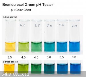

Bromocresol green indicator is probably about right, keeping toward the yellow range during the reaction.

Bromocresol green should work as an indicator to monitor pH, being kept towards yellow for the reaction to proceed. The end product is IIRC yellow and the expected quench pH possibly about pH 5.5 due to sudden reduction of the active evolution of HNO2. The mix of color in the optimum range is likely then to be a yellowish green with the quench arising in the really solid green that would come with rising pH in the likely pH 5.1 to pH 5.5 range with the peak HNO2 activity expected at about pH 4.8 to pH 5. Anyway, the Japanese chemists specified pH 4 so pH 4 is what I modeled, just in case they are right on the bullseye. It could be interesting to try an alternate model with the buffer at pH 4.8 to see if yield goes up or down.
bromocresol_green_chart.jpg - 54kB
There should be adequate solubility for the paracetamol slurried in the 20.4% acetic acid / 8.2% sodium acetate trihydrate "model" buffer reaction medium for it to very gradually dissolve enough to react incrementally in the contemplated reaction scheme.

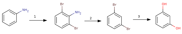

I used to be interested in resorcinol many years ago. I forget exactly why, but nevermind that. The best route I could come up with while be relatively possible for an amateur was not a clean one.
resorcinol.png - 7kB
Starts with aniline then
1) EAS with Br2. No clue how well the selectivity for the di-ortho (relative the amine) would be. Pretty sure aniline is so activated here that this would go without catalysis. If Para was preferred then huge blunder.
Edit-
Come to think of it this would likely fail to give any selectivity for the di-product especially not the right regioisomers unless the para position was blocked. Woops.
2) Then the classy sandmeyer elimination type reaction which has been discussed here several times in several ways. Again, messy, but doable.
3) Dihydroxylation reaction not sure how clean that'd go either. I know some users have reported hardship with similar reactions.
[Edited on 5-7-2015 by smaerd]
Maybe there's a selective way to nitrate an acetanilide amide for the meta regioisomer. Or go for dinitrobenzene...
The real difficulty is just meta positioning.
edit again - just checked the wiki. It says melts of sulphonic acids are typically used. That's definitely approachable.

@smaerd, I don't think that brominating aniline would work like that. I have a reference somewhere to bromination aniline with N-bromosuccamide to avoid oxidation and side reaction IIRC.

Yes I think the colour of the reaction mixture will mask the colour of bromocresol green if used in the reaction mixture (and survives) I would use the dye to prepare paper strips. Actually all of the reactive (ie phenolic) o and p sites in bromocresol green have already been blocked so the compound may survive under the mildly acid conditions, it depends on its ability to resist oxidation.

As a note on the subject of pH indicator dyes, I ran across this interesting bit about lacmoid or lackmoid (resorcinol blue) pH indicator
