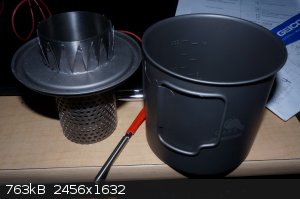

I was in the process of building my own cell after watching several Youtube videos, until I came across this excellent guide that makes me reconsider my cell design.

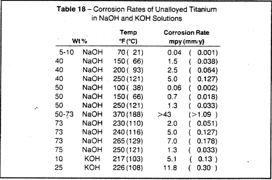

1. Is having the cathode at the bottom necessary? I know the design from 150 years ago did it that way to prevent bridging and that len1 is clearly in favor of that. The most successful cell I saw on YouTube also did it that way. I'm trying to make my cell from very thin titanium, which makes it very difficult to weld, so having a hole on the bottom seems a bad idea. Is it possible instead to passivate the top part of the anode so that it does not cause that awful bridging and short circuiting? What coating can withstand NaOH and not get reduced by the electron flow?
2. Is titanium a good cell body material compared to steel or nickel? According to this study, the erosion rate increases rapidly with temperature.
titanium_alkalai_corrosion_rate.png - 195kB
But even 1mm/year is pretty good - that's 44 kg at the 5g/hour rate of Nux's cell on Youtube. And this is for aqueous solutions, which is more damaging to the oxide layer than non-aqueous. I heard this from other people who constructed their cell using aluminum.
Here's a picture of my cell so far. The tube is a Ticon Industries perforated punch tube for mufflers. Also, I plan on using immersion heating with ceramic heater cartridges. They will be installed in nickel plated aluminum tubes.
