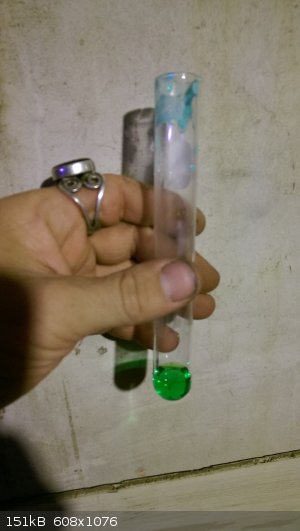

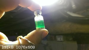

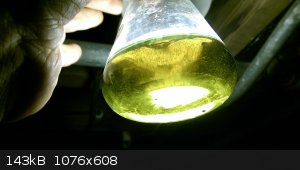

tonight I checked the (supposed) copper hydroxide I made a few years back, still light sky blue in it's mason jar after all this time. it did not bubble the least with strong HCl( picture below just moments after addition). pool/concrete etchant strength from the hardware store. I got the how to from youtube as copper electrodes in a dilute(ish) aqueous epsom salt bath, with a hacked ATX computer PSU. the sample instantly turned a beautiful clear emerald green when the HCl was poured in, dissolving the clumps rather fast.
001.jpg - 151kB002.jpg - 183kB
after I cleaned the test tube out, pleased that it didn't fizz, I also put some of the copper hydroxide in an iron citrate solution I had just made. [ rust and a little steel wool in excess citric acid, all dissolved; made a clear darker yellow sol pictured below, top two]. the gloppy blue copper hydroxide paste( I had kept it wet) was shook in a few ml of the iron citrate. after the cloudiness settled out in a few min, the solution began turning rather green( pictured below, bottom 2). I honestly don't know how much free citric acid was left in the iron citrate sol, or how much rust and steel wool I had in there. I was just hoping to make some crystals later.
so, no I didn't make copper citrate directly, but I did test the copper hydroxide I made(with HCl) and then get the iron citrate I had already made, to take up some copper. not a bubble in either case.
006.jpg - 200kB.................................................... 008 (2).jpg - 143kB

-The mix was copper hydroxide, iron citrate with an excess of citric acid. And it turned green. Either the excess citric acid in solution dissolved more of the Cu(OH)2 overnight, or it settled more compactly. I'll add some more citric acid to see if it will eat all the hydroxide. Oh ya, there is no brown ppt in there. Indicating the copper hydroxide didn't displace the iron, both are in sol.
-I had the iron citrate sitting around b/c I wanted some crystals of just that. It wasn't purpose made for this experiment, just convienient.
-The copper chloride was dumped in my copper chloride e-waste jug. And did not participate here at all. Just for the carbonate test.
all the copper hydroxide dissolved leaving a clear green solution.
[Edited on 4-7-2015 by violet sin]

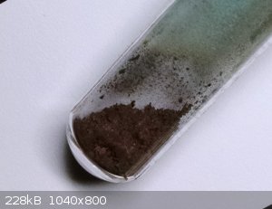

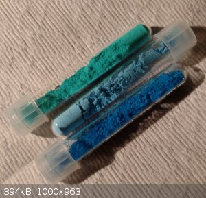

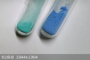

Here are some notes from my explorations of copper citrate. The preparation came from the RSC document in the Sources section:
Experimental and Observations
32.11 g (0.157 mol; 1 eq) citric acid monohydrate was added to a 250 mL beaker containing 150 mL distilled water, and the mixture was heated to dissolve. The pH of the solution, measured with multi-indicator test strips, was ~1.5. 22 g of sodium hydroxide were added (0.55 mol, or 3.7 eq, assuming 0% moisture in the hydroxide), bringing the pH to ~12. The liquid was poured into an evaporating dish and heated until bubbling gently and slightly syrupy. As it cooled, the liquid began to form a sort of 'pudding skin' on the surface. In the unheated lab, the mixture froze solid overnight; on warming, it remained a solid cake of white crystalline solid. This was broken up and added to a 250 mL beaker containing 50 mL of 200 proof ethanol. The slush was stirred, filtered and rinsed with another 50 mL dry ethanol. Once the solid had drained thoroughly, it was crushed finely and stirred into 100 mL boiling dry ethanol. After several minutes, it was filtered and laid out to dry. The white, fluffy crystalline solid massed at 46.24 g (0.157 mol; 1 eq; i.e., nearly qualitative yield.) A solution of the salt was measured at pH~10, compared to a literature value of 8, suggesting residual hydroxide contamination. Adding copper sulfate to the solution did not yield precipitate; the mixture appeared to darken with small dilution.
In an erlenmeyer flask, 5.91g sodium citrate (0.02 mol, 1eq) and 7.54g copper sulfate pentahydrate ( 0.03mol. 1 eq) were dissolved in steaming distilled water, creating a definite darkening of the copper blue to a deep teal. On standing, a scummy deposit, not a grained precipitate, formed. Upon heating, the solution precipitated a fine turquoise powder. This was washed with alcohol, dried, and massed at 3.39 g . Taking at face value the hydration state in Merck of 2.5 and the hydrate molar weight of 613 g/mol, this is ~0.0055 mol, ie 55% yield. (There were mechanical losses when the flask burped in the microwave.)
CuCit_sample_final.jpg - 1018kB
To confirm the hydration state, 0.50 g copper citrate were placed in a test tube and heated in a 50 mL beaker containing mineral oil (dehydration occurs at 100C, says Merck). Moisture was seen leaving the tube, and the solid changed from a sea-foam green to a sky blue. The pale dehydrated salt was massed at 0.46 g (0.81mmol). This suggests 0.04g water (2.2mmol) were driven off, giving a ratio of ~2.75 water molecules per copper citrate molecule, agreeing with the literature value.
dehydration_process_final.jpg - 800kB dehydration_results_final.jpg - 616kB
A small amount was placed in a test tube and heated while continuously flushed with carbon dioxide. Granular metallic copper resulted, though no pyrophoricity was observed.
thermal_decomp_final.jpg - 228kB
RSC provides an alternative procedure, based upon copper acetate and citric acid, rather than copper sulfate and trisodium citrate. In a 50 mL flask, 1.50g copper acetate (8.2mmol) and 1.09g (5.1mmol) were dissolved in ~20 mL distilled water. On standing, a small amount of green crust formed. When the liquid was poured into a new flask and heated to boiling, it again became turbid green and precipitated. (Below, left) Magnesium citrate, available in solution at the pharmacy as a laxative, will also precipitate when heated with copper sulfate. (Below, right)
CuAc_final.jpg - 891kB MgCit_final.jpg - 969kB

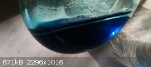

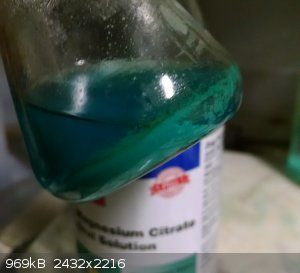

Merck claims that copper citrate is soluble in hot solutions of alkali citrates; this was attempted with hopes of recrystallization. In 25 mL of boiling distilled water were dissolved 3.4 g trisodium citrate, and 1.6 g copper citrate was added. The mixture was at first turbid and murky, then became a dark, clear blue solution. This was filtered hot into a new 50 mL flask cooled to room temperature, then chilled. After two days, no crystals were observed; the flask was heated down to ~5mL to drive off water. This was chilled another day, but only became more syrupy. When a drop was placed in a test tube of pure water, or a 50/50 mixture of water and ethanol, the liquid became a clear blue solution; in 100% ethanol, the drop settled on the bottom like a bead and stuck to the glass. When ~1mL 100% ethanol was added to the flask containing the syrup, it formed a bilayer (!) which would reappear even when mixed with vigorous shaking (!!). Over several months, the liquid solidified into a pale blue crust. The solubility of copper citrate in concentrated ammonia was also confirmed, forming a deep tetraamine-copper blue solution.
solvatedincitratefinal.jpg - 1.2MB CopperDrop_final.jpg - 903kB CopperEtOH_bilayer_final.jpg - 671kB

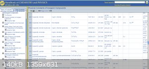

Data & Materials
Citric acid C6H8O7 (mw=192.12 g/mol). Exists as a monohydrate (mw = 210.14g/mol); LD Carlson Co. product was used, via 5th Season, a local homebrew store.
Trisodium citrate Na3C6H5O7 (mw = 258.07 g/mol) Exists as a dihydrate (mw = 294.1 g/mol). Soluble in water, insoluble in alcohol
Copper (II) Citrate Cu3(C6H5O7)2 ; Cu3C12H10O14. mw = 568.85 g/mol . Hydration state claimed by Merck is 2.5 (mw = 613 g/mol)
Sodium Hydroxide NaOH (mw = 40g/mol) Comstar “99% Pure Lye“ was used. Slightly soluble in alcohol.

The first is misinformation and its propagation in the literature. Neither protocol given in RSC would work satisfactorily without additional heating. More severe is an error present in both the Merck Index [8th ed] and the CRC [63rd ed], listing the formula for copper (II) citrate as “Cu2C6H4O7*2.5H2O”, with a molar weight of “63.220”. Although casual consideration of the citric acid acid molecule suggests this is unlikely (it would require the deprotonation of a hydroxyl group in addition to three carboxylic acid groups), this formula has spread to internet databases and peer-reviewed literature The CRC still lists the incorrect formula at the time of writing [96th Ed, 2015-2016]
files.php.png - 140kB

This project grows out of an interest in pyrophoric copper, which can be prepared by heating in vacuum according to Gorrie, Kopf, & Toby (1967) (h/t ScienceMadness user Pok). Lacking a vacuum pump, this could not be replicated using a CO2 atmosphere, although metallic copper did appear to result from thermal decomposition. Although the original purpose of this investigation (pyrophoric copper) was not achieved,
This sort of depends on your definition of pyrophoricity; I still haven't observed the powder catch fire when poured out cold, but when poured h
I was able to isolate this as a dark blue solid two different ways. In the first, I would dissolve copper citrate in ammonia solution, and then add dry alcohol (91%IPA), forming a bilayer similar to the one pictured above. This was mixed, left to stand, and the alcohol replaced. Eventually, the complex formed a solid crust, which was further dried by grinding under dry ethanol:

IMG_20180205_cuCit_amine_compare.scaled.jpg - 394kB
Top to bottom: Hydrated, dehydrated, and ammonia complex.
I've tried a few times to measure the multiplicity for the ammonia complex, and haven't been able to get much of anywhere. I think a number of factors are working against gravimetry as a tool here, but it's not obvious what else is available.
