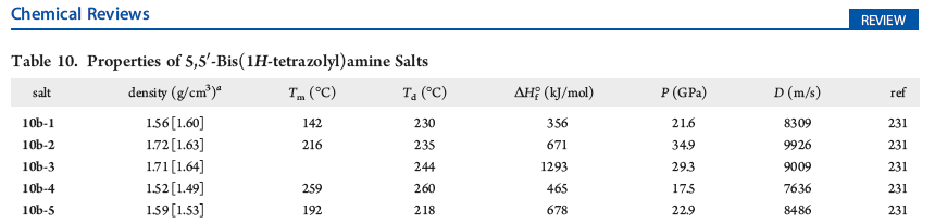

I found that:
vod.PNG - 18kB
Attachment: Azole-Based Energetic Salts, Chemical Reviews.pdf (1.6MB)
This file has been downloaded 1013 times
10b-2 : -> the ammonium salt of 5,5'-Bis(1H-tetrazolyl)amine
D (m/s): 9926m/s
P (GPa): 34.9
Has anybody an paper how to synthesis 5,5'-Bis(1H-tetrazolyl)amine ?=? 5-azido-1H-tetrazole??

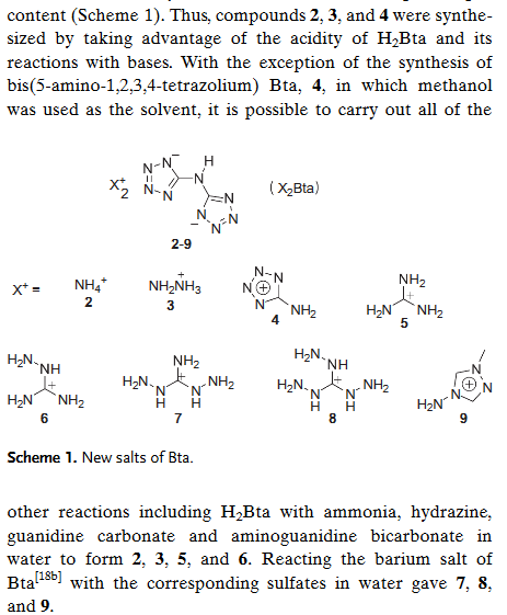

In my previous post I described the hydrazinium salt of 5,5'-Bis(1H-tetrazolyl)amine (not the ammonium salt. A fault in the document)
Synthetic route to 5,5'-Bis(1H-tetrazolyl)amine is decribed here:
Synthesis of H2BTA•H2O (C2H3N9•H2O), (1)
As described in the literature[4], (Fig. 1) 4.45 g sodium dicyanamide (50 mmol) and 6.50 g sodium azide (100 mmol) were dissolved in 40 mL ethanol and 25 mL water, and then 75 mL of 2 M HCl was added dropwise over 4 h with stirring. The resulting mixture was refluxed for further 48 h. After cooling to room temperature, 10 mL of 12 M concentrated HCl was added and then 60 white precipitates were filtered. The crude white solids were dissolved in hot water, and then cooled to give white crystals 1.
IR (KBr): ν = 3455(s), 3030(s), 2932(s), 2857(s), 1651(vs), 1611(s), 1555(s), 1456(m), 1353(m), 1261(m), 1152(w), 1108(m), 1072(s), 1043(m), 1003(m), 903(m,br), 820(m), 740(m), 688(m), 509(m,br), 405(m) cm–1.
This is then allowed to react with hydrazine to yield the compound with vod of over 9900m/s
Attachment: 201310-123.pdf (336kB)
This file has been downloaded 1135 times
12.PNG - 38kB
Is there an other route to 5,5'-Bis(1H-tetrazolyl)amine? Pretty difficult:o
How to get sodium dicyanamide?
BTW does someone know how to syn. 5-Azido-1H-tetrazole? Maybe start from 5-Aminotetrazole?

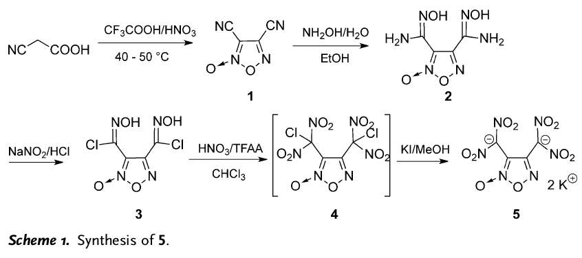

[*] posted on 16-11-2015 at 10:12
Potassium 4,5-Bis(dinitromethyl)furoxanate: A Green Primary Explosive with a Positive Oxygen Balance
Chunlin He and Jean'ne M. Shreeve
Angew. Chem. Int. Ed. 2015, 54, early view
DOI: 10.1002/anie.201509209
furoxanate.jpg - 26kB
Tetranitratoethane
Joerg Stierstorfer, Thomas M Klapoetke and Dennis Fischer
Chem. Commun., 2015, Accepted Manuscript
DOI: 10.1039/C5CC09010E
