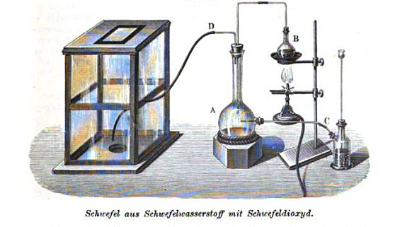

Another way to do it is to get SO2 and H2S to react. One could use an apparatus similar to the one shown below seen in Lehrbuch der anorganischen Chemie by Hugo Erdmann. The explanation of the apparatus: into the bulb (A) first H2S is led in which comes from the side through the tube from apparatus (C) in a moderate stream. The apparatus (B) is a SO2-generator (here SO2 is generated using Hg and H2SO4, Cu should also work in place of Hg). The excess gases are lead through the outlet tubes (D) into a fume hood canal (an old fashioned way of doing it). The reaction between the two begins very soon and in a short amount of time, the inner wall of the bulb is covered with intensely yellow sulfur. I'm pretty sure there are simpler ways of forming sulfur from hydrogen sulfide.
This reaction is moisture catalyzed. This is not a great quality video, but illustrates the reaction: http://www.youtube.com/watch?v=ZCR1HAad4ww
SO2 is probably easier to make by heating a small amount of acid and a bisulfite or metabisulfite for a gas generator.

Always good to see it demonstrated. Thanks. I didn't know it was moisture-catalyzed, but then neither did Erdmann. Though heating the H2SO4 under such a flame as in the set-up was bound to give off some slightly moist SO2 which would have given the impetus for the reaction.
