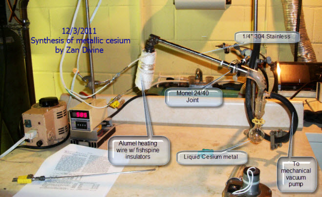

Just made Cesium
Well, it was too damn easy.
Used patent US3164461.
This is a Li metallothermic redn. in vacuo @ 585 degrees C.
Yield is nearly quantitative in about a total 15 min of reaction time (at temp).

PPS Yeah, I KNOW the pics suck. If you want to see full size ones I think this will do it:
http://i43.tinypic.com/drcl5l.jpg[/IMG]
http://i43.tinypic.com/20fpzsw.jpg[/IMG]
One of the harder things about making Cs was wading through the information/disinformation. Most notably: Cesium is pyrophoric. No, it isn't. At least not at 70 degrees F and 66% relative humidity. When I opened the reactor, I expected fire. The only fire I saw was when I touched molten Cs with a leather welding glove. Amusing.
The Process sm.jpg - 108kB The Setup sm.jpg - 88kB

Interesting! Reduction of CsCl with Li and removal of Cs by vacuum distillation, if I understand well? Could you provide some more details, please? And more photos of the metal too, does it have that slightly golden shimmer that is claimed?
Is that a hair drier on the left photo?

This is a screenshot of the US patent. With % yields like those, and especially with the high purities reported, it's hard not to sigh and wish they hadn't made it so easy. I'd love to claim that my Cs was the end result of painstaking trials eventually culminating in sucess, but the truth is that I just followed the instructions.
This 12.5 g rxn. (of the cesium salt) was a quick and dirty scouting run whose main purpose was to get experience in handling Cs and to investigate if the physical construction of my apparatus was suitable.
Among my main questions was this one: Given that Cs vapor leaves the reactor near 600 degrees C, would I need to cool the exit pipe with water? ...or...maybe I'd need to heat it if the Cs froze in it? It was the latter, and that's the reason for the home-built high temp heat gun. Cs tended to freeze in the narrow downwards tube in the center of the vacuum take-off adapter as well as in the last few inches of the 12" long 1/4" stainless steel pipe. Gentle warming solved this problem.
My reactor is a stainless steel tube unto which I welded a standard ferrous pipe fitting (I really don't see why SS is mandated. Steel is suitable, as is monel.) allowing me to attach/detach the condenser pipe for charging/cleaning.
This is actually something I made for my phosphorus project. I'm going to make samples of all of the hard to get, "big-game" elements and offer them on e-bay to other collectors who shouldn't have to pay $100 - $140 per gram for Cs or Rb and those who should be able to buy a small sample of white P without selling their first-born. Bromine was first, cesium is in progress, rubidium will be next and then possibly white P. I need to see how dickish the DEA is about gram quantities. We all know that I2 and P are watched because of their methadrine connection, yet I see dozens of iodine samples for sale and a few (only red) P samples and as long as they are small, seem to elicit no hysterical overreactions.
I'll post pics today or tomorrow of my production scale apparatus which uses part of a SS "lecture bottle" (for gasses) as the reactor and an old heating element from an oven to provide a nice, sheathed source of heat.

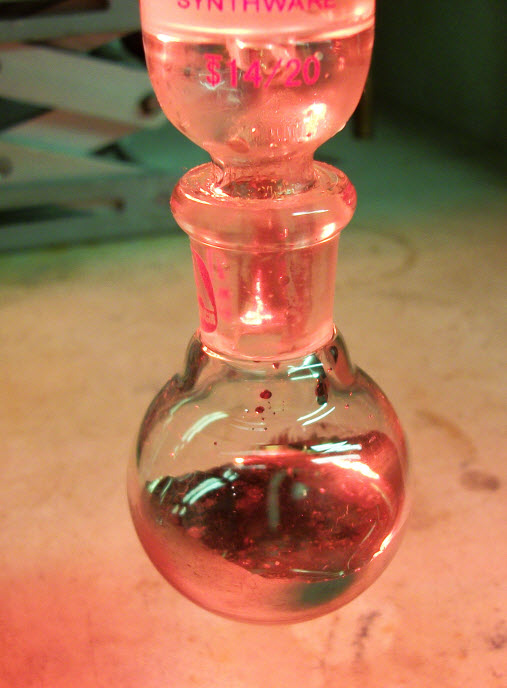

The crude metal was submerged in mineral oil and it's hard to see it because the high index of refraction of the oil distorts the image in the small flask. In the future the receiver will be sized so that it is full at the end of the reaction. Now that the prelim. results are in and it's thumbs up, I'm going to rent an inert gas cylinder (big deposit, heavy pain in the ass) or see if heating (NH4)2Cr2O7 gives me a usuable grade and amount of N2. I'm going to eventually use a glove-bag & inert atmosphere to package samples.

These are a couple ampoules I made up by melting the Cs under mineral oil and pipetting in air into open amps.
The tips of the pipettes smoked during transfer. Evacuated amps. and sealed under a vacuum. This is nothing more than a crude first attempt. Quality will improve with Argon.
The pipettes are on my patio being exposed to air/moisture slowly. If you throw them into water they will likely break. Reaction with H2O is SO VERY VIOLENT. Do not EVER warm or cool glass containing Cs with a water bath. I just can't stress enough how much worse the reaction with water is than K and water. I use cold sand for cooling and warm air for heating. When Cs burns in air it's not very different from K..... but the reaction with water...!!!!

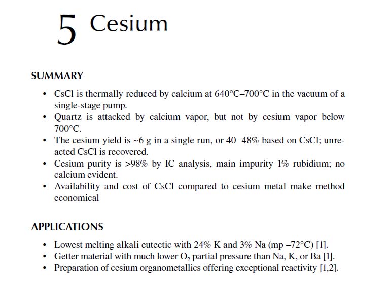

Our very own len1 synthesised cesium by heating CsCl with calcium under vacuum at 640 - 700 C. This was described in his book "small-scale synthesis of laboratory reagents"
Cesium.jpg - 87kB

Extremely interesting synthesis, congratulations! Seems a lot easier than I would expect for something like cesium.
In that last picture of the two ampoules, are they both cesium? The one on the left looks very distinctly silver instead of gold. It looks a lot more like one of the other alkali metals than cesium.

Calcium was my second choice. Due to lithium's higher % yield and the fact that it would be liquid at the rxn. temp and Ca wouldn't, I chose it for the reductant. The Cs in this run was made using the Li from 2 size AA lithium batteries. This lithium is not exactly the cleanest available but it worked well enough.
Blogfast, thanks for the links. I had only seen the first one previously. I apologize for looking past your earlier question of amount. I had no intention of quantifying this run. In my estimation it must have been 6-7+ grams in the flask and another half a gram or so hung up in the glassware. When I get the argon cylinder more quantitative results will follow.
MrHomeScientist, Thank you and they are both cesium. The stuff degrades before your very eyes though. Even the dissolved oxygen in mineral oil quickly attacks it. Don't read too much into the color. Cs is silver just like the others. Trace oxygen contamination causes a golden hue to be displayed. The golden color is just part of the element's mystique. People want to believe it's intrinsic, but it really isn't.
I have no doubt at this point that making Cs is the easy part. Effective packaging of clean material will be harder.

That makes sense, Zan. You could flush the syringe too, I guess. For 99 % Cs that should really be sufficient and a lot less messier than glove boxes or glove bags...

Welcome to the cesium club! As congratulations, I can send you RbCl so that you can make that as well. I have a 50 or 100 g bottle to spare. I have a spare diffusion pump too, as well as a kg or two of CsCl; what I don't have these days is the time!
Your apparatus is VERY similar to what I have used, except I used SS316 for the 24/40, a tube furnace, and a sealed swagelok 1" tube.
You may consider a distillation receiver that allows for vacuum and argon to be applied.
If I do it again, I'll try with lithium (although I worry more about the purity with lithium than with Ca).
