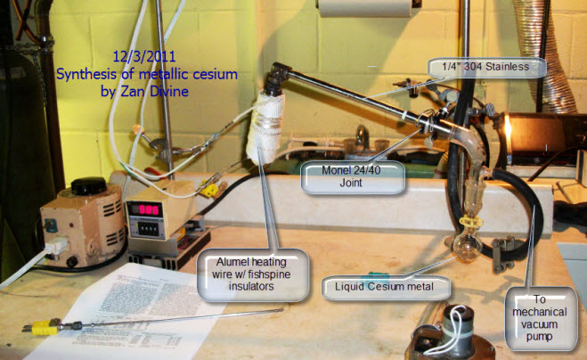

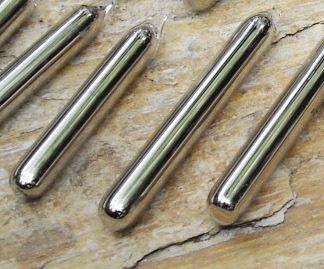

APO, as long as you are buying a vacuum pump, why not go the easy route?
I've posted my results for Li reduction of CsCl and Li and Ca reductions of RbCl. 660 degrees C is easy to reach. You start and a few hours later you are ready to seal Cs in an ampoule. The synthesis and isolation/purification are all in one operation.
Warm syringes and needles (say 18-20 gauge) are ideal for handling. You can easily store the metal in a glass screw-top bottle under mineral oil and then draw oil-free beautiful metal from its center. Handling Cs and Rb is not difficult. You will want to rent an argon cylinder and pass the gas through a drying train first for inerting receivers.
The Setup sm.jpg - 88kB all cesium cropped.jpg - 51kB
