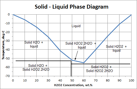

Quote: Originally posted by C6(NO2)5CH2CH(CH3)N(NO2)2
I filled a 118ml plastic bottle half full with 3% solution and let it freeze on its side with the capped end angled slightly up. It froze into a solid piece, and in the morning I turned it cap down and squeezed it to make some cracks in the ice. While I did that, several milliliters of liquid ran out of the ice and gathered in the cap. The temp was -6C, and that fluid resisted freezing, so I think it is at least 10% according to https://en.wikipedia.org/wiki/Hydrogen_peroxide#/media/File:Phase_diagram_hydrogen_peroxide_water.svg
If I have the above correct all I have to do is freeze my H2O2 water solution to form a mixture of solid and liquid, assuming the original strength of the H2O2 solution is less than about 50% and the mixture has a achieved equilibrium , the liquid is a higher strength than the strength of the original solution.
So for example if I freeze the dilute H2O2 solution in a freeze to say -25C (thermostat turned full on) then the liquid remaining will have strength of 30%. Obviously I don't know how much H2O2 will be trapped in the solid but even if its 50% of the total H2O2 its not destroyed so it sounds like a very practical method to obtain 30% H2O2, assuming you can get the freezer down to -25C. I will have to give it a try with my 12% solution preferably with stirring to form a slush I can filter off the liquid easily.
Below is a more detailed phase diagram. It confirms that the solid is water ice above about -50C. Its also interesting that the maximum strength achievable with this method is about 60% and that H2O2 forms an adduct /crystal structure between the H2O2 and water.
hydrogen-peroxide-Solid---Liquid-Phase-Diagra.gif - 13kB
Sorry I have lost the reference to the file
