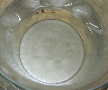

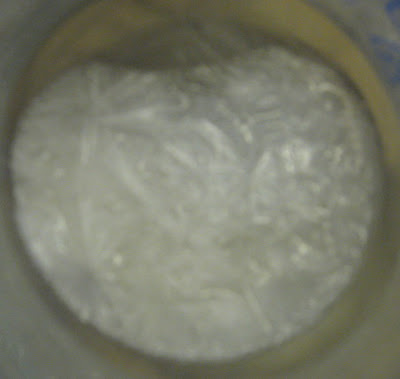

[*] posted on 18-9-2011 at 04:51
Well, well, well. On icing almost the whole mass crystallised out into a snow white crystalline mass with maybe only about 40 - 50 ml of mother liquor left:
This stuff will now be isolated, washed and weighed for yield determination.
I’m also wondering whether the lead sulphate in a spent and discharged battery could be converted to ‘white lead’ (basic lead carbonate) by treating it with hot soda:
3 PbSO4 (aq) + 2 Na2CO3 (aq) + 2 NaOH (aq) === > (PbCO3)2Pb(OH)2 (s) + 3 Na2SO4 (aq)
… because lead sulphate is slightly soluble in water. The basic lead carbonate should be soluble in strong acetic acid.
Or rewrite as:
3 PbSO4 (aq) + 3 Na2CO3 (aq) + H2O (l) ==== > (PbCO3)2Pb(OH)2 (s) + 3 Na2SO4 (s) + CO2 (g)
I recrystallised the lead acetate after washing it with small amounts of iced water to get rid of the excess HAc, then added a small amount of DIW and heated lightly until complete dissolution occurred. On cooling the product crystallised in about 30 seconds flat, with crystals growing radially from crystal nuclei at a rate of approx. 1 mm/s! The structure can just about be seen with this resolution:
[Edited on 18-9-2011 by blogfast25]

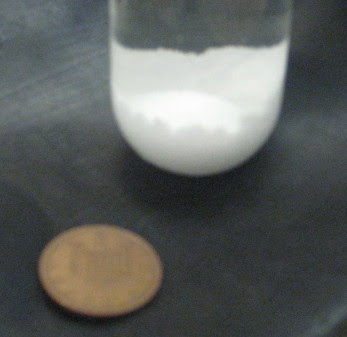

Conversion of PbSO4 to lead basic carbonate (‘white lead’ - vernacular)
I’m interested in converting the lead (II) sulphate from my spent lead battery to lead (II) acetate.
Yesterday and today I explored the following displacement reaction:
3 PbSO4 (s, aq) + 4 Na2CO3 (aq) + 2 H2O (l) === > (PbCO3)2Pb(OH)2 (s)+ 3 Na2SO4 (aq) + 2 NaHCO3 (aq)
… taking advantage of the slight solubility of PbSO4 and the complete insolubility of ‘white lead’.
To that effect 3.25 g of PbSO4, 3.4 g anh. Na2CO3 and 17 ml of water were mixed in a 1” test tube. The amount of soda is almost 3 times the stoichiometric amount. The test tube was heated on steam bath for about an hour, and then allowed to cool and stand overnight.
The resulting precipitate was the filtered off, setting aside the first portion of filtrate and carefully washing the filter cake with multiple aliquots of hot DIW until it ran almost neutral and no bubbles formed with strong HCl (evidence that soluble carbonate had been eliminated).
The filtrate set aside was first neutralised slowly with strong HCl until no more bubbles formed and the solution reacted strongly acidic. It was then tested with Cu(NO3)2 for residual carbonates and tested negative, then tested again with conc. CaCl2 which caused a shed load of white CaSO4 to precipitate. It appeared the anticipated reaction had proceeded.
The filter cake had in the mean time been dried on filter, on a low setting hot plate and two medium pinches were added to 2 test tubes and a little water added: this stuff appears to be almost water repellent! The lead sulphate I started from did not show this.
Adding 38 % HNO3 to the first, fizzing started, then subsided and a perfectly clear solution resulted. To the second tube, some glacial acetic acid was added. That was noticeably slower and needed a little heat but it too resulted in a perfectly clear solution. All 3 test results are strong evidence that the displacement reaction had proceeded to completion.
The next step will obviously be to test this on battery lead (II) sulphate.
