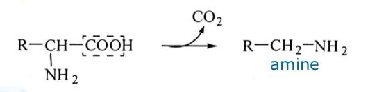

The general reaction of amino acid decarboxylation is:
decarbpic.jpg - 7kB
I decided to use L-Proline as the amino acid because I had it and the end product of this reaction (pyrrolidine) would be a really useful compound in my inventory. (And because I failed with the lysine decarboxylation, but that`s another story.)

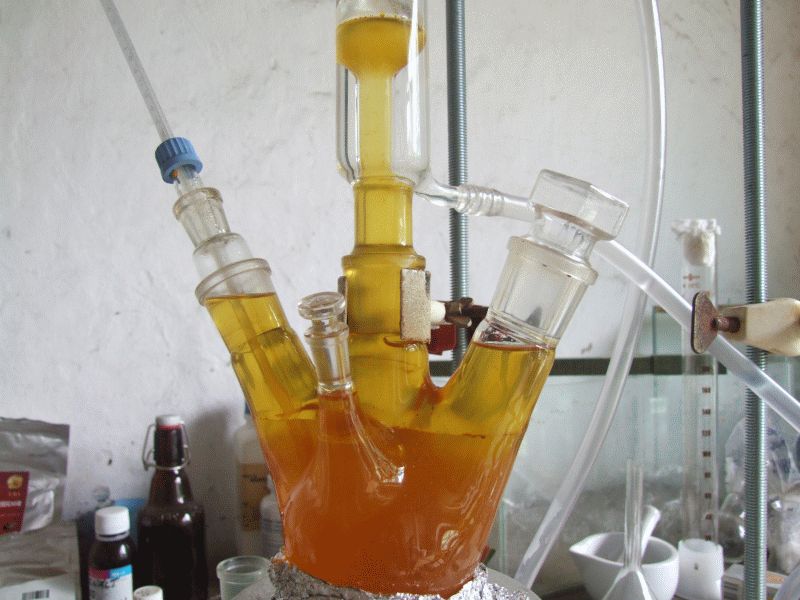

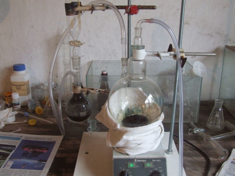

The optimization started with the introduction of a primitive gasometer (big pickle`s jar immersed in water, mouth down, heavy brick on top to prevent it from falling, permanent pen marking the meniscus from time to time.) At first I just wanted to monitor the progress of the reaction because I was not sure when to stop. Is 3 hours enough? Or should I reflux it all night? Collecting the CO2 and measuring its volume at intervals gave me the answer.It showed me that the reaction is a slow one and there`s surely room for improvement. So I decided I would use a different catalyst for the next run. Then I relized that a “ketone with high bp” not necessarily means good catalytic activity in this particular reaction. Second surprise was that not even a “enone with high bp” means automatically a good catalyst.This was the point when I systematically started the screening of various ketones/enones under my arbitrarily choosen “standard” conditions to shed more light on this reaction.
My standardized conditions were the following:

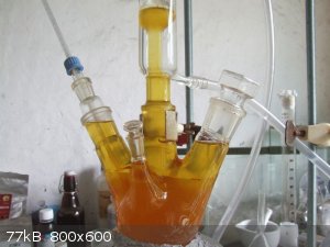

100 mmol L-Proline (11.4 g) + 10 mmol catalyst added to 130 ml lighting kerosene (mostly C9-C13 paraffins, max 2% aromatics) and heated to (and held at) 142 Celsius during the entire course of the reaction. Collection of CO2 starts when the temperature of the reaction mixture reaches 110 Celsius. Heating was done by a magnetic stirrer/hotplate and stirring was turned on, around 700 r/min all time.
suckback.jpg - 77kB
Lesson learned: at the end of the reaction it is not enough just to turn off the heating and stirring. The plastic tube from the gasometer should also be removed. If not, a massive suckback can happen! (Characteristic orange color of the reaction mixture can be seen.)

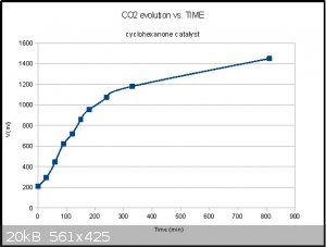

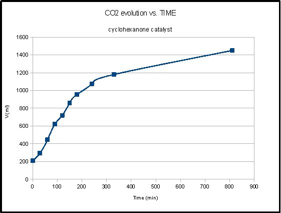

Drawing V vs. time gives a saturation curve of which the first part is a fairly straight line - if you are lucky. Linear regression on the first 3 or 4 measurement points defines a y=sx+i curve and we are interested in s or the slope of this curve, which is the rate of the reaction during the initial phase when the concentration of substrate (proline) and the catalyst is closest to the initial concentration.
A picture is worth a hundred words so here`s one of the V vs. time graphs and you can see what I tried to tell you:
graph1.jpg - 20kB
Graph 1.
There is a simpler method to calculate reaction velocity between two measurements:
velocity = (Vn+1 - Vn)/(tn+1- tn) , which is: calculate the volume difference of captured CO2 between two readings and divide it by the interval of time between these two readings.

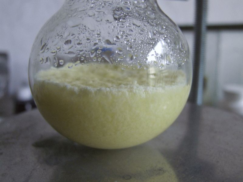

I measured 2.6 g (18.5 mmol) p-chloro-benzaldehyde and 4.0 g (69 mmol) acetone into a 50 ml Erlenmeyer flask. The aldehyde dissolved fully in the aceton within 2 minutes. I also measured 23.0 ml 10% NaOH solution into a 50 ml beaker and with stirring turned on I poured this solution into the aldehyde solution. Heating was turned on and temperature set to 100 Celsius. I put a reflux condenser onto the flask with circulating water as coolant (water temp. was around 20 Celsius).
The reaction started quickly, at first white precipitate formed then its colour turned to sulfur yellow. During this time the contents of the flask started to boil because the reaction is exothermic and the hotplate also quickly reached the set temperature. I was lucky and no overboil happened, but more care would be needed next time.
I continued stirring and gently refluxing the mixture in the flask for an hour. At the end of the hour orange coloured oily droplets sank to the bottom. I let the system cool for a few minutes, removed the condenser and removed the flask too. Then added a little dilute (8-10%) HCl solution to the flask to neutralize most of the NaOH. This dilution/cooling caused the product to aggregate into small, yellow balls. The salt solution was decanted, then I washed it again with tap water (20 ml) until the pH became close to 7. It required an additional heating/melting then re-cooling cycle on the hotplate with stirring.
The product was not crystalline yet, it formed an amorphous mass with a nice yellow colour. Tried to recrystallize the mass from MeOH, but failed: the solubility was too low. So I evaporated the methanol and let the sulfur yellow honey-like liquid to stand at room temp for 24 hours. By next day most of the product crystallised and only a small part of the mass was still honey-like. It had a faint, cumin-like smell. I didn't check its melting point because it was not a clean product and I didn't see the reason in recording/reporting a way off mp value. On the other hand for my evaluation purposes I regarded that crystall mass suitable.

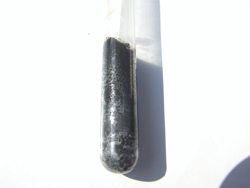

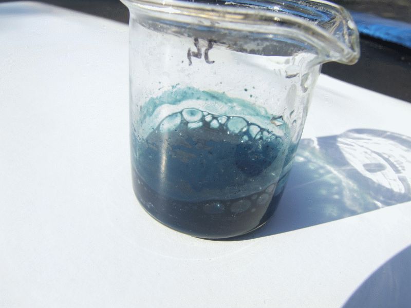

For the synthesis of benzoin I had to prepare some cyanide first. (I know thiamine could be used too but wanted to prepare some cyanide and it was a good excuse for that.) It was in itself an interesting synthesis. Here's how it went:
I measured 6.500 g K4[Fe(CN)6]x3H2O into the bottom of a glass petri dish then heated it on a hotplate around 100 Celsius for 1-2 hours in order to remove the crystal water. After cooling the measered mass was 5.674 g.
Mtrihidric = 422 g/mol, Manhidric = 368.4 g/mol. Expected anhidric mass (from 6.500 g trihidric) = 5.669 g. Difference: +0.08%, seems OK.
Reaction:
K4[Fe(CN)6] + Na2CO3 ------> 4 KCN + NaCN + Fe + CO2 + NaOCN
According to the preparation recipe 4 parts of anhydrous ferrocyanide and 1 part anhydrous Na2CO3 should be mixed and then melt together and heated until no more CO2 bubbles from the melt. This way one can produce 8.8 parts cyanide along with 2.2 parts of cyanate. (And some fine Fe powder. The product is a so-called “mixed cyanide” because it contains both sodium and potassium ions. It is sometimes better than a pure cyanide because it melts at a lower temperature and is easier to work with.) Don't take the above stoichiometric equation too seriously thoug! There are dozens of different ones circulating in the papers and the process is probably more complicated than this. According to e.g. Boffis CO also evolves and only 70% of the cyanide can be recovered. Anyway, I only needed just a small ammount of cyanide ions so this half-true equation was sufficient for me. :-)
I mixed 2.0 g ferrocyanide and 0.5 g Na2CO3, put the mixed fine powder (was mixed and powdered in a mortar with a pestle) into a standard glass test tube and started heating on direct gas flame. At first the white powder became black then melt. It started fizzing (actual bubbling was hard to see because the dense, black melt quickly obscured the sight). I kept the test tube at good visible red heat for 20 minutes or so, then turned off the gas. It was still fizzing but I was afraid of a possible test tube failure (red heat) and decided to stop at that point. I let the test tube cool in free air and at a point I heard a familiar “click” sound. I kinda expected it from the solidifying cyanide to break the glass but I still felt sorry for the test tube.

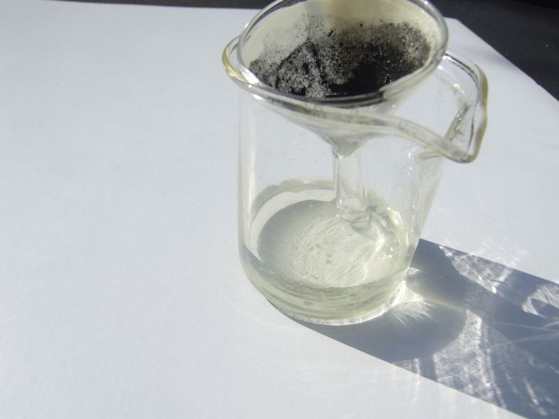

After cooling down I added small ammount of water (2-3 ml) to the tube and started cautiously swirling the water around the wall of the tube to dissolve the cyanide. It dissolved fairly easily and the Fe powder sank to the bottom. Purification was easy: filtering through filter paper. I repeated the dissolution-swirling-filtering procedure two or three more times and in the end I got around 8-10 ml cyanide solution. I checked the cyanide content with FeSO4 solution and it produced a thick, deep blue precipitate immediately. At this point I could be sure I had enough cyanide for the benzoin dimerisation.
cyanidestart.jpg - 33kB
Starting mixture in a test tube.
cyanideend.jpg - 36kB
After heating for 20 minutes and cooling. You might even see the crack on the tube a bit above center, horizontal line, on the left side.
cyanidefiltered.jpg - 51kB
Nice, clear cyanide containing solution.
prussian.jpg - 57kB
The prussian blue test of around 1 ml of the filtrate. It is blue enough I think.

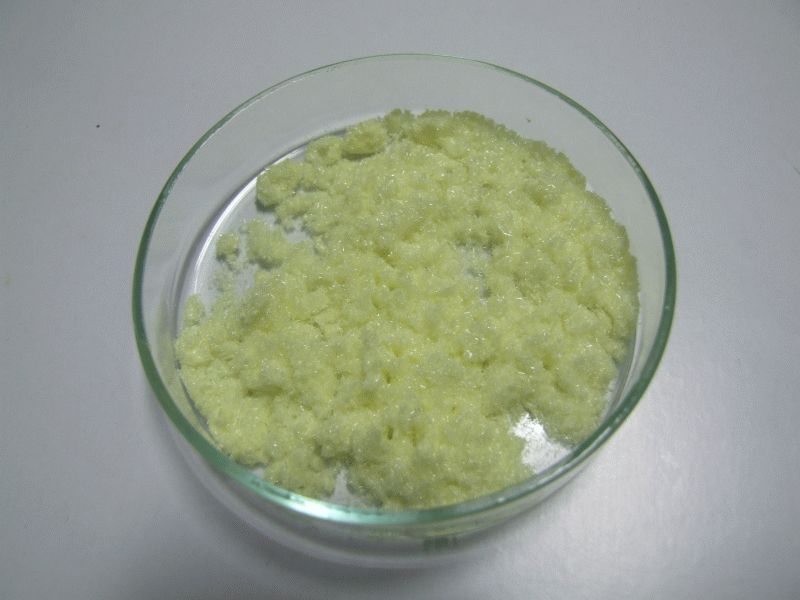

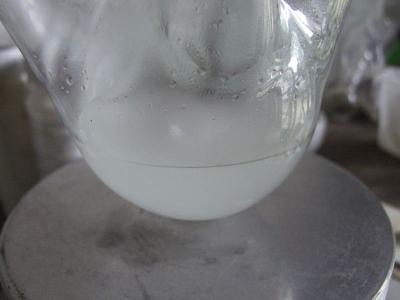

Dimerisation:

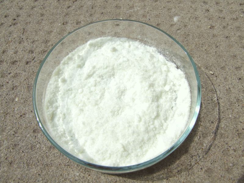

Into a 100ml round bottom flask I measured 10.1 g benzaldehyde and 20 ml denatured alcohol. (Denaturant: 2% MEK.) The benzaldehyde was not previously distilled or purified in any way, it was straight from a 20+ year old small glass bottle. I also added 5 ml cyanide solution (see above synth) to this benzaldehyde solution. I had it stirred on a magnetic stirrer hotplate under gentle reflux. The initially white opalescent liquid turned yellowish within 10 minutes. After 90 minutes intensive stirring I turned off the heating and let it cool. It formed a yellowish, sticky-crumbly mass upon cooling.
I filtered the mass (with resuspension) on a Buchner filter and washed three times with distilled water on the filter until the prussian blue reaction of the filtrate became negative. Three washings were enough. Recrystallized from ethanol, roughly 65 ml ethanol was used for this.
The mass of the dried product was 6.9 g. Yield: 68%. Melting point: 134.5 – 134.9 Celsius. (literature: 134 – 138 C) Almost white crystalline powder with no odour.
benzoincrude.jpg - 60kB
Crude benzoin cooling in the flask.
benzoinrecryst.jpg - 104kB
Recrystallized benzoin in a petri dish.

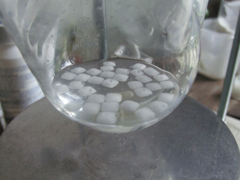

I suspended 4,0 g benzoin into 10ml cold 50% nitric acid in a 50 ml Erlenmeyer flask. While cold there was no appreciable reaction. On slow heating the benzoin melt, turned reddish orange and the mixture started to emit NOx. After 30 minutes of gentle warming (around 60-70 Celsius) the upper organic phase was reddishbrown, the lower aqueous acid was orange. After another 30 minutes the acid layer lost most of its colour while the organic layer brightened to strong yellow / faint orange. At this point the Fehling reaction was negative. (The starting material benzoin did show a positive reaction, I checked that.)
I let the mixture cool, diluted with some cold water and filtered on a Buchner filter. I washed the yellow crystalls with water again, then recrystallized the still somewhat wet mass from denatured alcohol. 15-20 ml alcohol was used for this.
Mass of dried product: 3.4 g. Yield: 85%. Melting point: 92.1-93.6 Celsius. (literature: 94-96 C)

Mass: 7.2 g. Yield: 72%. Menthone melts at -6 C so I could not meausre its mp. What I got is a nice, menthole-smelling liquid.

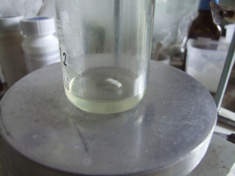

menthonestart.jpg - 57kB
Dissolving menthole prills in acetic acid. They dissolved in two minutes.
menthoneend.jpg - 48kB
Finished menthone preparation. You may see a thin layer of menthone oil on top of the acid. The white blobs are Na2CO3 lumps.

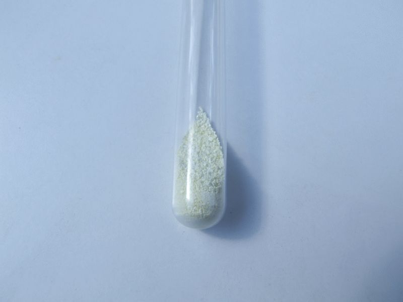

menthonecrude.jpg - 54kB
Crude menthone while evaporating chloroform.
Cyclohexenone
[2]
I assembled an O2 generator at first: into a 500 ml flat bottom flask (generator body) put a distillation vacuum-adapter and on the top of this adapter a dropping funnel was inserted. To the vacuum side-arm of the adapter a flexible plastic tube was attached. The other end of this tube ended in a ground glass gas inlet tube in the reaction flask, a 2000 ml two neck round bottom flask.
To the other neck of the reaction flask another flexible plastic tube was attached and it ended in a water filled gasometer. (The usual 2 litre pickle's jar mouth down filled with water in a big bucket of water, hevy brick on top to prevent the jar from falling over.)
Before the reaction was started I put 1,0 g MnO2 (powdered pyrolusit, actual MnO2 content 93%) into the generator flask and measured 80 ml 30 % H2O2 into the dropping funnel – tap strictly closed if you want to avoid surprises! :-)
I also measured 23 ml cyclohexene (previously made from cyclohexanole and phosphoric acid /sulphuric acid, another interesting synthesis on its own) and added 2,00 g analytical grade Cu(II)-acetate as a fine powder to the cyclohexene in the reaction flask. A big, oval shaped teflon coated magnetic stirring bar was also placed cautiously into this flask. The end of the O2 inlet glass tube was not immersed into the liquid, it ended at about 5 mm above the surface of cyclohexene. After a final inspection of the proper fitting of the ground glass joints I started stirring the cyclohexene quite intensively: the stirring bar made small droplets from the liquid and these droplets trickled back from the inner surface of the flask. (To promote absorbtion of O2 into the liquid.) To my surprise the copper acetate dissolved somewhat in the dry cyclohexene, the liquid became faint blue in a few minutes.
Then I started the reaction by very cautiously opening the tap of the dropping funnel and let the peroxide drip onto the MnO2. The first few drops were somewhat frightening I admit but later, as more and more water diluted the pyrolusit powder it tamed and the generator worked satisfactorily.
I filled the gasometer jar twice with the air/oxigene mixture from the generator/reaction flask/tubings and then released this gas into the air. Then I filled it again but this time this gas was not released. It became the “chamber gas” or “reaction gas” for the coming days.
Unfortunately I could not put a thermometer into the cyclohexene but the temperature of the hotplate was around 60-70 Celsius. (guesstimate)
After 24 hours the reaction mixture showed only minimal signs of change: the blueness of the copper compound became a bit deeper. At 36 hours though the change was striking: the liquid became blackish green and something black, goey-like substance was clearly visible. On the sides of the flask the dripping back liquid was no more blue, the colour turned to yellow like the yellow of dilute FeCl3 solution. At 62 hours I decided the reaction was over and turned off the heating but stirring was still on.
Washed the liquid in the flask with FeSO4 solution (in the hope to destroy organic peroxides) and separated the oily phase in a separation funnel. It was a bit tricky because both phases were almost the same: brownish black! Fortunately there was a slight difference in the colour of the two phases and they were separated nicely. No nasty emulsion, nothing.
Then I distilled the organic phase. At first the excess of cyclohexene came then I collected another two fractions. The temperature of these fractions were not recorded because there was water in the system so it was more like steam distillation.
The composition of the first fraction was confirmed by TLC, it was essentially pure cyclohexene. (20% acetone – 80% petrolether 80-100, Merck Art. 5554 DC-Alufolien Kieselgel 60 F254, iodine vapour): no spot was visible either from pure cyclohexene standard or the first fraction. I know it sounds much like “the lack of evidence is not evidence of non-existence”-or what, but it was sufficient for me at this point. If I had a better TLC method for detecting cyclohexene I surely would choose that.
The smell of the fractions was also a telltale, the third fraction was the worst. I mean really unbearable, almost made my stomach move upwards! I hate the stench of pure cyclohexene too, but this was definitely worse. Do this experiment in a good fume hood or (as I did) outside! (LD50 of cyclohexenon is around 200 mg/kg, it is a poison!)
A few milliliters of black, viscous (resembling to glycerine in this respect) “oil” remained in the distilling flask. I think something still could be steam distilled from this mixture but I thought I had enough for the test.
The composition of the third fraction on the above TLC system showed three spots. The slowest (most polar) was the bulk (Rf:0-0.42), then there was two much smaller but distinct spots above this (Rfs: 0.45-0.54, 0.58-0.64). The quantity of the bulk overwhelmed the plate, it showed a continuous streak from start to 0.42. Or was it the water in the sample?
cychexenoneend.jpg - 76kB
Cyclohexenone making machine. O2 generator on the left, reaction flask on the hotplate. Picture was taken at the end of the reaction. You can see the blak reaction mixture in the flask.

It seems that acetophenone has a pronounced induction period at the beginning and gains momentum slowly but afterwards it works nicely. Like a mule. In contrast, cyclohexanone has almost zero induction period and works at full-throttle from the start but looses the speed in the later stages of the conversion. Like a cheetah. To illustrate this here's some data:
Cyclohexanone: time to 50% conversion: 45 mins, to 90%: 270 minutes.
Acetophenone: time to 50% conversion: 131 min, to 90%: 277 minutes.
(14 mmol proline, 1.4 mmol catalyst, 20 ml solvent. T roughly the same.)
Incidentally, the above data-pairs show the futility of my efforts too: the initial rate constant means nothing. If I want to compile a nice table with rate constants from WHICH point of the reaction curve should I pick that constant?
Cyclohexanone is more than 3 times as quick initially as acetophenone but still, they finish the reaction almost at the same time!
From the point of view of the synthetic chemist they are practically the same: they transform a given ammount of substrate during the same time period.
(Of course, they may not be the same at all, but we need more data. E.g. it is possible that they finish the conversion during the same period but one may produce a cleaner product! I did not check the purity of the product, but I can tell qualitatively that acetophenone produced a less coloured reaction mixture.)
