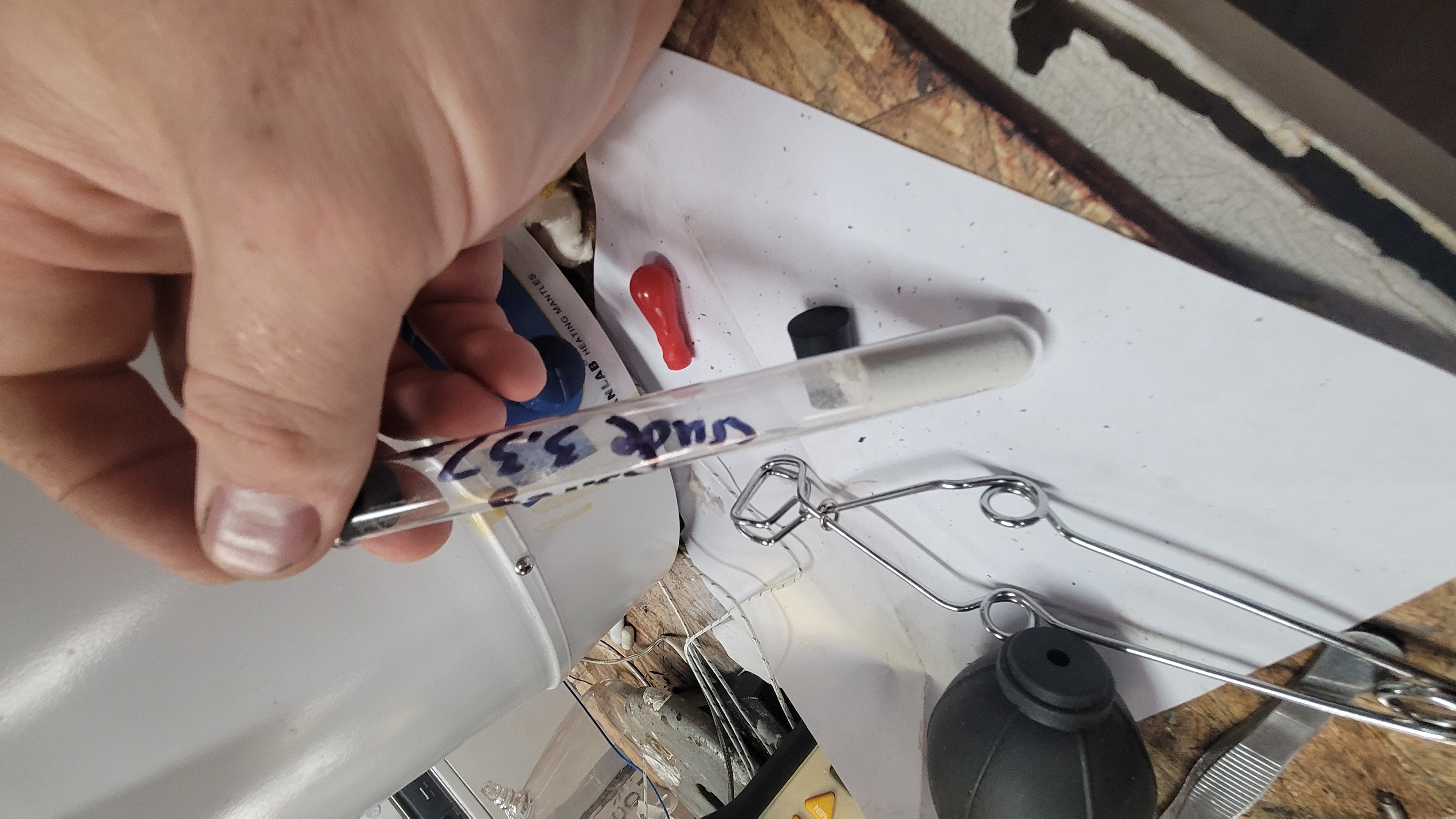

Ya
So after drying the ammonia by heating it until it decomposes/sublimated. Let everything cool.
I added aluminum foil. What I believe to be a stoichiometric excess, and started heating.
I witnessed a red/orange liquid forming on the bottom of the tube. Likely to be a molton salt, or even molten aluminum. Or the red stain on my test tube left from the silver testing.
Most of the aluminum was consumed in the reaction.

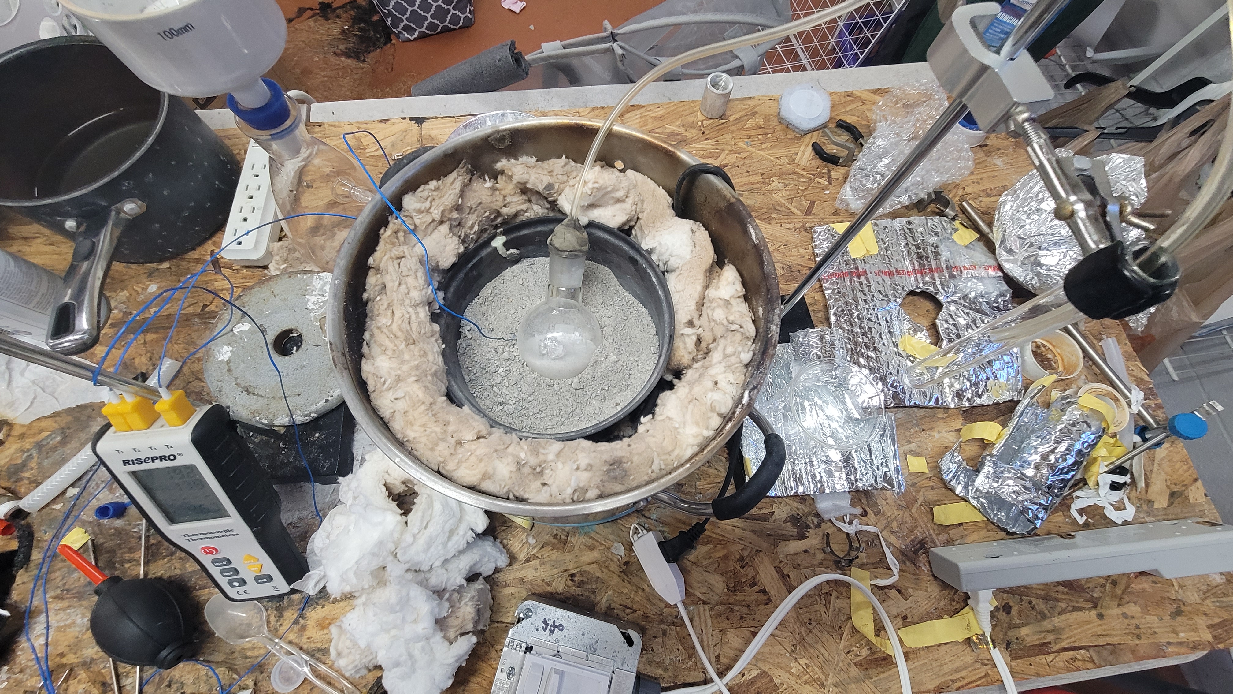

Proposed appratus
My thinking is to start with a 100mL Rbf, clasien adapter with thermocouple and gas port, tubing and mineral oil bath, under an inverted cup flooded with oil.
Proposed procedure
A1) By monitoring the temperature vs power input, I should be able to see that at some point the apparatus requires more heat/power to maintain/increases the apparatus temperature. Being an endothermic reaction this will signal that the reaction has started and ended. This will require another software rewrite to add more data collection so may not happen this time. But deffenetly sticking a thermocouple in there
A2) By using a bubbler, i hope to collect any gases that are generated by this reaction. Maybe even use the gas as a method to measure reaction rate and endpoint
A3) by taking accurate weight measurements of all components of the appratus both before and after the reaction, then using the formulas R1 and R2. One formula should predict the observed weights

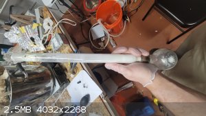

20221218_160332.jpg - 2.5MB20221218_155738.jpg - 2.3MB
20221218_161041.jpg - 2.4MB20221218_161407.jpg - 3.1MB
If i get to name something im calling it "ashley's oxidation"
Lab notes
Code:
2022-12-18 Test tube placed in sand bath, 900watt heater controled by a triac in insulated pot. Duckseal will be used to secure gas collection tube in reaction vessel. Tub leads to a test tube(15ml) in a dry ice acetone bath. Thermocouple is tapped to bottom of the reaction vessel. Reaction vessel weights 23.35g 0.48g of aluminum foil was weighed. When added to the reaction vessel the total weight is 24.01g That is a difference of 0.66g I will trust the weight of the aluminum packed into the test tube vs the weight of the foil in air. Math section NH4Cl mol weight 53.49g Al mol weight 26.982g NH3 mol weight 17.031g Ammonia density 0.6819 g/cm3 at −33.3 °C Predicted products are H2 gas and NH3 gas 0.0244607516mol of aluminum are in the reaction vessel Gas collection test tube is 15ml By reaction R1 8mol of NH4Cl = 6mol NH3 By reaction R2 6mol of NH4Cl = 6mol NH3 5ml of liquid ammonia seems like a safe limit. By reaction R2, which will produce the most NH3 per mol of HN4Cl, 5ml * .6819g/ml ÷ 53.49g/mol NH3 = 0.0637408861 mol of NH3 to collect, which requires 6mols or 20.47g of NH4C and 1.71g of al. So aluminum was added until 1.71g was the weight And i dont know if i can fot that much salt into the test tube Switching to rbf 100ml weight 63.54g Rbf w/ al 65.29g = 1.75g difference 1630 heat applied. 20% power Sand bath 16c Cold trap -67.8c 1640 no observation Sand bath 112.5c Cold trap -67.2c Heating played with. Full power 30seconds then minimum power, repeat when temp quits rising 1646 sand bath 155.0c no observations 1648 sand bath 165.0c no observations 1650 sand bath 178.0c no observations 1656 sand bath 193.8c no observations 1700 sand bath 202.5c no observations 1704 sand bath 226.8c no observations 1710 sand bath 271.5c no observations 1712 sand bath 282.0c no observations 1714 sand bath 292.3c no observations 1716 sand bath 309.4c no observations 1718 sand bath 321.5c no observations 1720 sand bath 330.1c no observations Heating adjusted to maintain slow temp increase 1725 sand bath 332.1c power ~50% 1726 sand bath 335.6c reaction vessel appears to have white dust on the inside where their was none before 1730 sand bath temp 334.6c amd falling, nonadjustment to power has been made since 1725 1734 sand bath 332.3c heating power increased 1738 sand bath 352.7c reaction vessel has much more dust on the inside 1742 sand bath 358.8c heating power increased 1746 sand bath 389.5c 1753 sand bath 414.0c heating stopped. Chear Liquid has condenced in my test tube. Verified by smell, ventilation was inadequate, need bigger fans Added sodium metal. Condensate turned blue. Appratus cooled and capped gently
Edit:
As it has been kindly pointed out to me, this proves nothing but
1) you can make silver metal explosively from AgCl + Al
2) you can collect HCl Solution from the solid product of (NH4Cl + Al) plus H2O
3) you can create NH3 from NH4Cl + Al
4) 2 wide open garage doors and 2 box fans are not enough to deal with liquid ammonia
[Edited on 19-12-2022 by Rainwater]

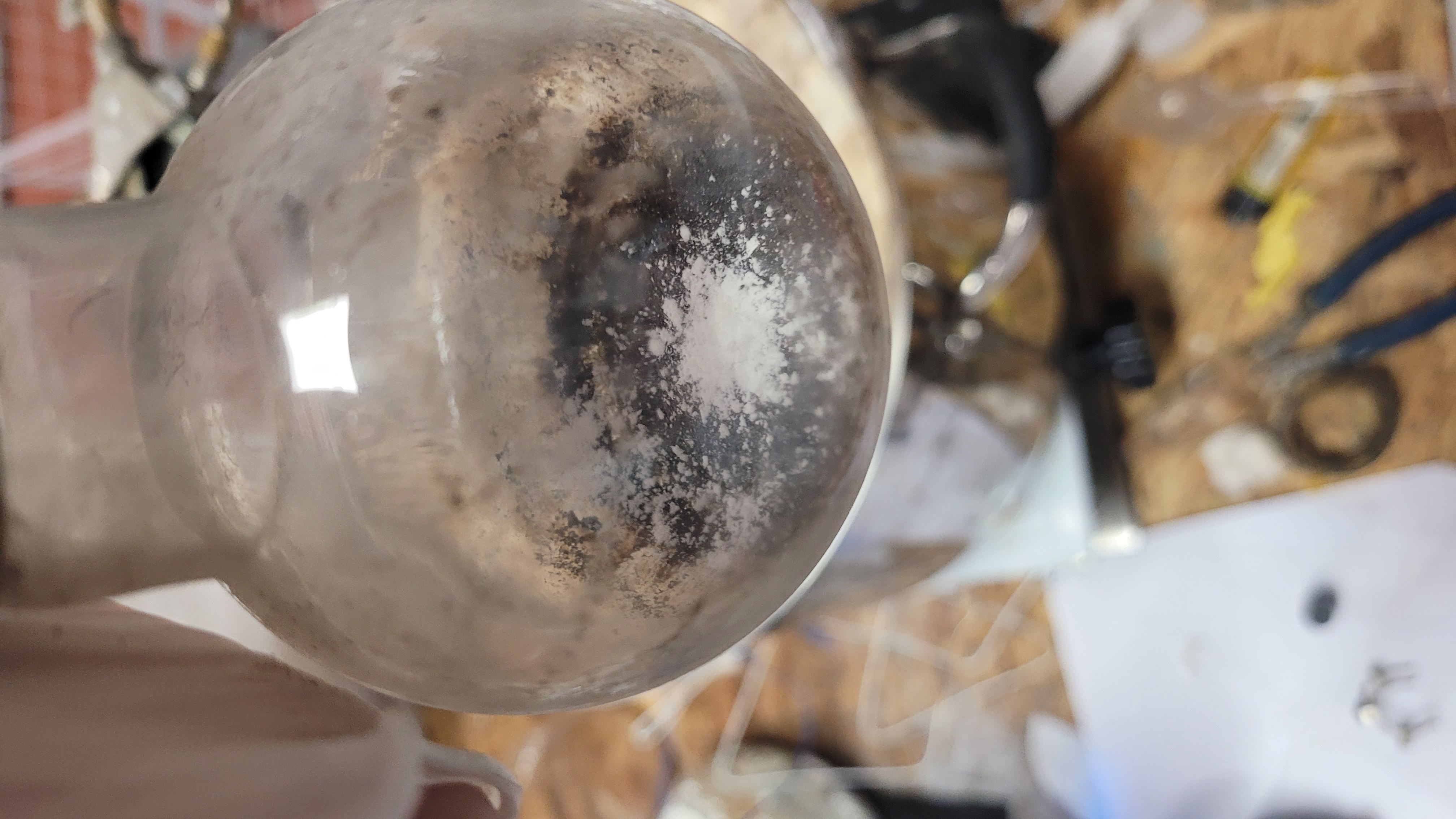

Updated Pdf including this mornings experiments
https://www.dropbox.com/s/ahcf7pm7pd4wpsr/Alcl3%20test%20202...
Got a bunch of pictures in it 30meg file
Im trying to narrow down tempature the reaction takes place
Looks to be just north of 350c
Lab notes

Glass wool fibers that where inserted into the column as a filter, where placed into a test tube containing 1 drop of the generated ammonia solution, 5ml of water and 1 drop of universal indicator. When the fibers contacted the solution, the ph went from 8.1~12.5 to 6.4.

I think that the observations I have witnessed were occurring in the gas phase.
Which is incredibly dangerous and hard on equipment.
I let that flask cool for 4 hours. It is currently 175c and dropping nice and slow.
I fully expect the rbf and column to be unfit for further use after this mornings experiments.
All downsides to this procedure. But a proof of concept for further research

So here's what I got so far
20221220_072617.jpg - 2.1MB20221220_075502.jpg - 2.1MB20221220_072634.jpg - 2.5MB
The reaction vessel (100ml RBF) has survived. And currently contains 8.02g of material.
The total reaction weight was 22.24g meaning 14.22g has moved
white solids recovered by scraping was weighed 3.37g and labled "crude"
20221220_094055.jpg - 2.2MB
At least twice that was rock hard in the column and would not scrape off.
Column washed with room temp(16c 250ml) acetone and contents scraped off with a metal rod.
Currently removing acetone by distillation.
Acetone turned to milk upon contact with products.
Compounds will be processed separately.
Noticed that at first, all the easy-to-remove powder, was free-flowing and clump-free. After moments in the air it begain to get clumpy and lumpy. Powder stored and capped as fast as possible.
Crude powder turns damp ph paper red upon contact.
Acetone solution turns damn ph paper red upon contact
Di water being used does not change ph paper color
Acetone being used does not change ph paper color
Next test will be sublimation tempature of both samples.

Got something after holding 190c for 30 minutes.
Currently going to 230c.
20221221_135922.jpg - 1.2MB 20221221_140035.jpg - 2.7MB
Edit: at 230c a liquid was observed in the test tube labeled "RBF"
It quickly solidifies when removed from heat
[Edited on 21-12-2022 by Rainwater]
