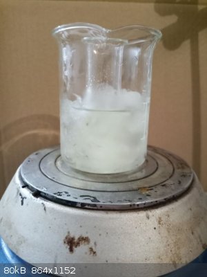

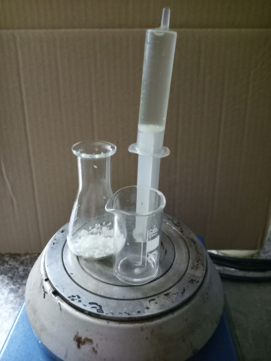

Into 25 ml Erlenmeyer flask was put fine crystalline benzylideneacetone 1,46 g (10 mmol), 1 ml of 20% NaOH, 25 ml of 12,5% NaOCl (+4 C cold from fridge) and stir bar. The flask was closed with a plastic foil, cooled in water-snow bath and magnetically stirred at high RPM for 15 minutes. Then cooling bath removed and stirring continued for 1 day at room temperature. Sometimes the pieces of solid had to be crushed using glass rod.

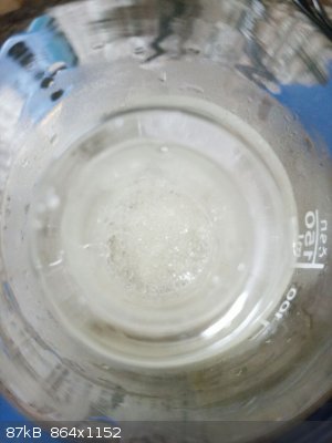

Product was recrystallized from 100 ml of water, here during filtration colorless filtrate obtained and impurities stayed on filter paper. Cooled to +4 C in fridge and filtered on Buchner funnel.

reactants: benzilideneacetone in the Erlenmeyer flask, solution of NaOH in the beaker, solution of NaOCl in the syringe

the reaction was magnetically stirred for 15 minutes while cooling in snow-water bath

recrystallized from boiling water, filtrate colorless, impurities insoluble and captured on filter paper
IMG_20221121_165149_9.jpg - 100kB IMG_20221121_165153_5.jpg - 70kB
cooled, crystals filtered on Buchner funnel, air dried
IMG_20221121_184131_8.jpg - 74kB IMG_20221121_184534_0.jpg - 75kB IMG_20221121_185537_1.jpg - 59kB
