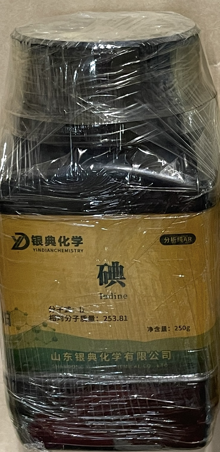

Hello, all!

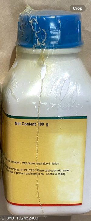

I have a small amount of iodine that I may have mistakenly stored alongside other bottles. While I know iodine tends to stain its surroundings, I assumed it would be fine since its container was unopened and sealed. However, after just a few months, I noticed that all adjacent bottles had become stained, even though they were still wrapped in unopened plastic seals.
I’m trying to determine whether the contents inside those bottles could have been contaminated. Has anyone had a similar experience, and if so, were the contents ultimately unaffected or compromised? I understand there are many professionals here, and I would greatly appreciate any insights you might share.
Please see the picture of the aftermath.
On a separate note, what’s the best way to store iodine, or I would just have to accept that it would stain its surroundings?
IMG_1148.jpeg - 2.3MB

It’s a bottle of ammonium cerium sulfate. In theory, it shouldn’t react with iodine. But I’m thinking if I need to open the bottle and transfer them to a different container; or worse, purity the reagent.

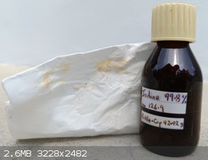

just fyi, one example
About 232g iodine stored for over 5 years in various climates.
I saw a dusting of tiny iodine crystals around the neck
the tissue shows what came off.
It is an ex-medicine bottle, not perfect, but the cap has not yet corroded
IMG_20250818_110333.jpg - 2.6MB
(photographed just after reading the above posts)
even though the paper labels are covered in tape, some of the ink has been oxidised.
I have tried other bottles/caps, this one is the best survivor so far.
I think that I bought 250g about 8 years ago, only used 18g so far :(
_____________________________
most iodine deposits slowly evaporate (sublime) away if given ventilation.
I would expect some superficial damage to plastics,
and a very slight porosity to iodine vapour
but unless your reagents are of reference quality I doubt that you would notice.
I would re-bottle. HDPE is great, but certainly not perfect.
(eg both az. sulphuric and az. nitric slowly corrode hdpe)
The shrink-,wrap seems to have absorbed most of the iodine,
I would remove the shrink-wrap and inspect the jar, it looks quite clean.
I would look at the inside of the cap and the top of the jar for indications of iodine.
re-bottling will minimise future doubts.
[Edited on 18-8-2025 by Sulaiman]

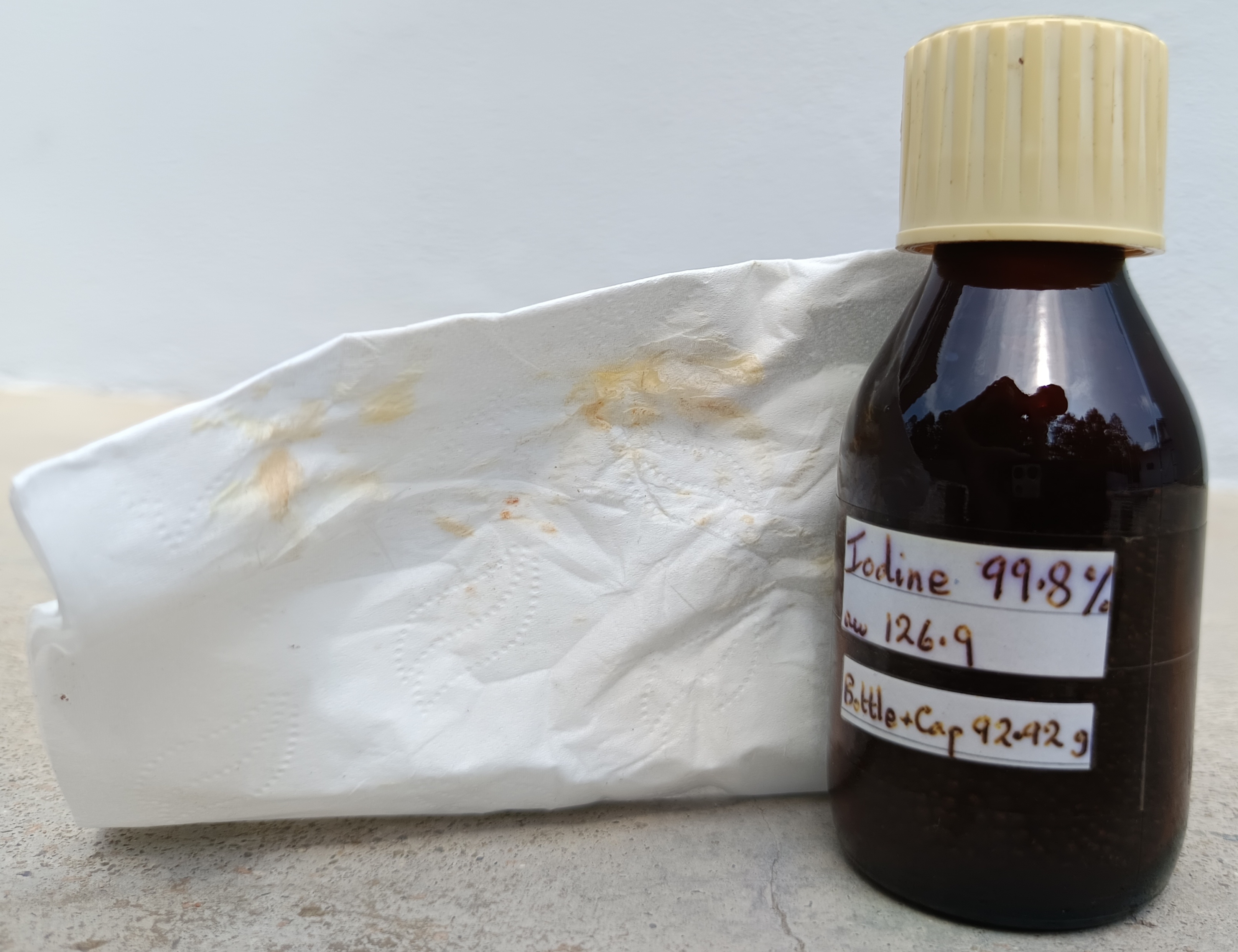

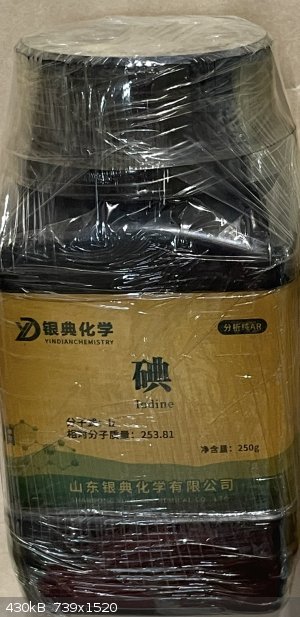

Here’s a photo I just took of the iodine bottle. You can clearly see the stain, even though the bottle is completely sealed and has never been opened. Perhaps I should transfer them to a medical grade glass bottle like you did. I’m just surprised that within just a few months, the iodine vapors managed to penetrate multiple layers—from a sealed container, through the plastic wrap, into the sealed wrap of a neighboring bottle—ultimately staining the other bottle.

Cover the I2 package with few layers of Al foil and replace the foil when you observe a corrosion. It works also for Br2, acetyl chloride, SOCl2, anhydrous AlCl3 and so on. All the lab scale I2 produced (or at least packed) in my country was always packed into ground glass joint jars (decades ago, now not anymore and everything "fresh" is from abroad) so there are permanent microleaks through the gap in the ground glass joints and I have to replace the Al foils like once per 3-5 years.
I2 is very nasty even in microleaks, if your storage box has metal hinges, they will corrode - it happened in my job when storing I2 disinfectants (solutio iodi spirituosa) - the closest hinges corroded severely and further hinges corroded less.

Using Aluminum foil as a “sacrificial layer” is indeed a very smart idea. Since you mentioned iodine erodes metals - I had stored my iodine bottle in a wooden shelf (where it stained adjacent bottles) and I’ve now moved it to a separate plastic storage container. But I’ll inspect the metal containers nearby.

Keep your iodine under concentrated sulphuric acid? It is said to suppress the tendency of iodine to sublime.

I understand ampoules are the best storage method but I don’t have high-temp torch in my house (nor am I good at making ampoules). I’ve now moved the iodine bottle to a separate storage container, and it was wrapped with many layers of packaging paper. Unfortunately this wouldn’t prevent iodine from escaping; but it would hopefully prevent it from staining something else. Since iodine stains paper quite easily, I can visually check if iodine vapor has made its way through.
You had a brilliant suggestion of using sodium thiosulfate. I will try to clean the stains with it. If the stains are superficial it should come off for the most part. I’ll update later.

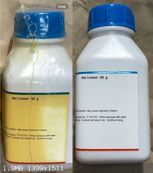

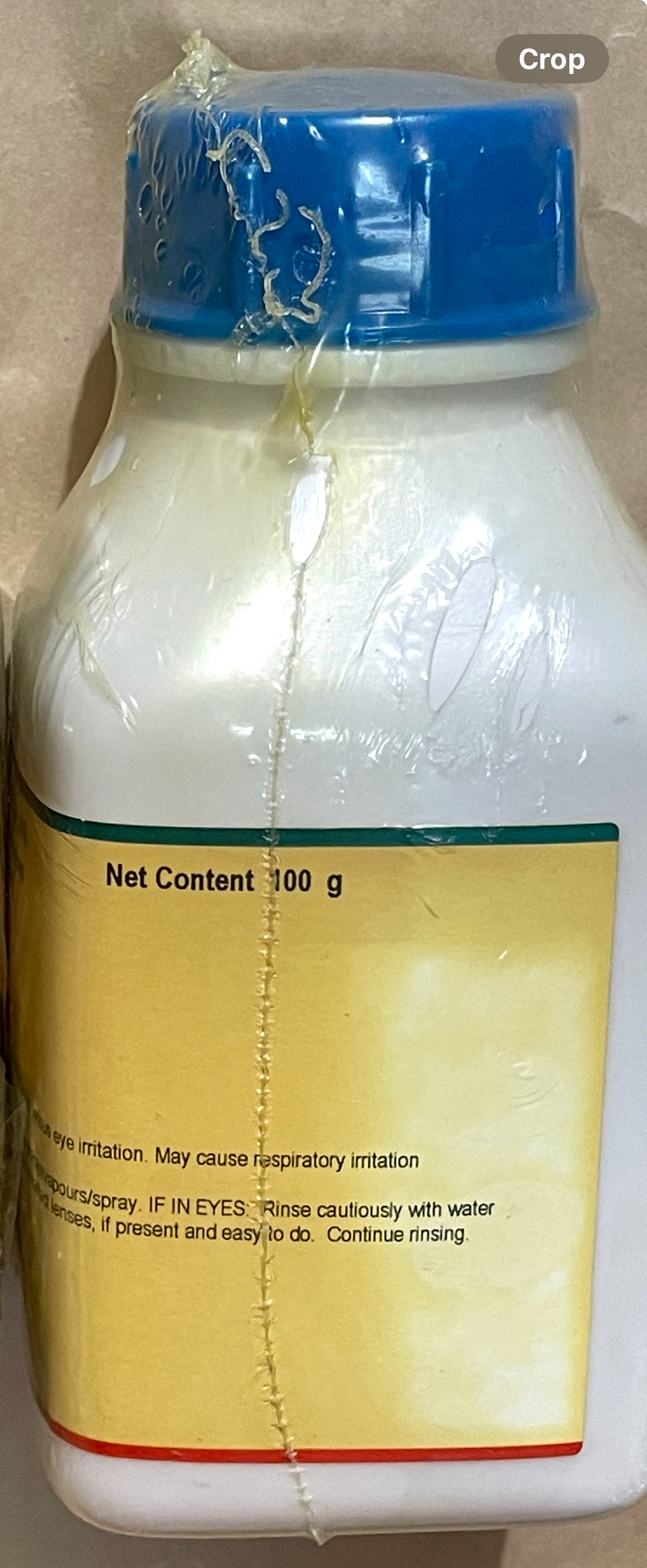

I opened the plastic wrap and wiped the impacted bottles with dilute sodium thiosulfate solution and then water. It worked really well! See the attached picture for a comparison.
I wanted to say that sodium thiosulfate works in aftermath cleanup, too!
I also tried to clean the stain with isopropyl alcohol wipes (since iodine dissolves in alcohols as well) but this turned out to be a bad idea. The isopropyl alcohol dissolved the ink on the label much faster than dissolving iodine stains. Another lesson learned.
I keep a lot of my iodine in ampoules -- various sizes so I can open one most suited to my needs. All of my recovered/recycled iodine is kept this way.
I also keep some in the container it was bought in. This is prone to leakage and I know I have lost a proportion of it over the years. I keep this small container in a sealed glass jar with some sodium thiosulfate in the bottom. I find this perfectly adequate for protecting other chems/objects – even if it does not prevent iodine losses.
IMG_0790.jpeg - 1.9MB

WOW ! nice cleanup job
when I had a lab, sodium thiosulphate solution was one of my 'antidote' chemicals on the shelf immediately behind me when in my usual working location, for halogens but mostly for silver salts.
I am amazed how nicely you've cleaned it
- I usually have to make a new label.
(ok, in truth, I often just do nothing and live with ugly labels)
