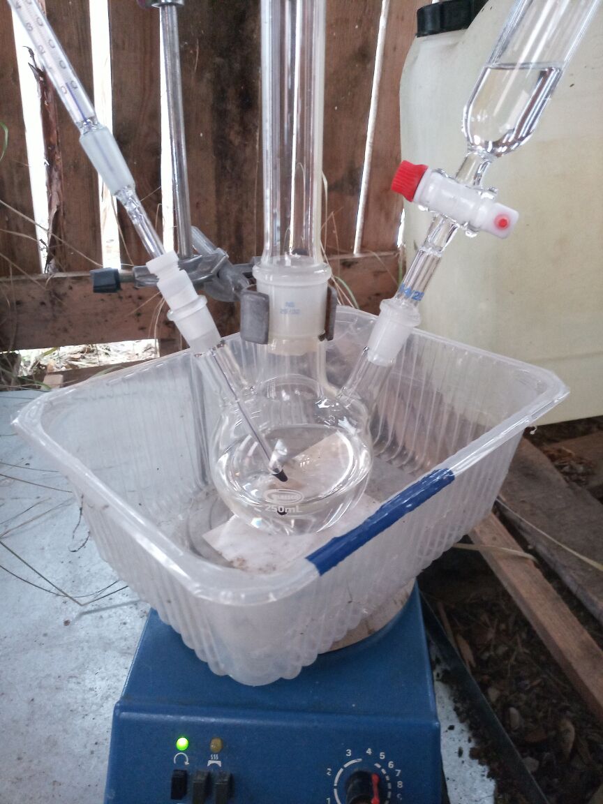

preparation before experiment: t-butanol was dried using anhydrous K2CO3 at temperature above 25 C for 1 week and distilled
apparatus: 3 neck 250 ml RBF equipped with air condenser, thermometer, dropping funnel, magnetic stirring
experiment:

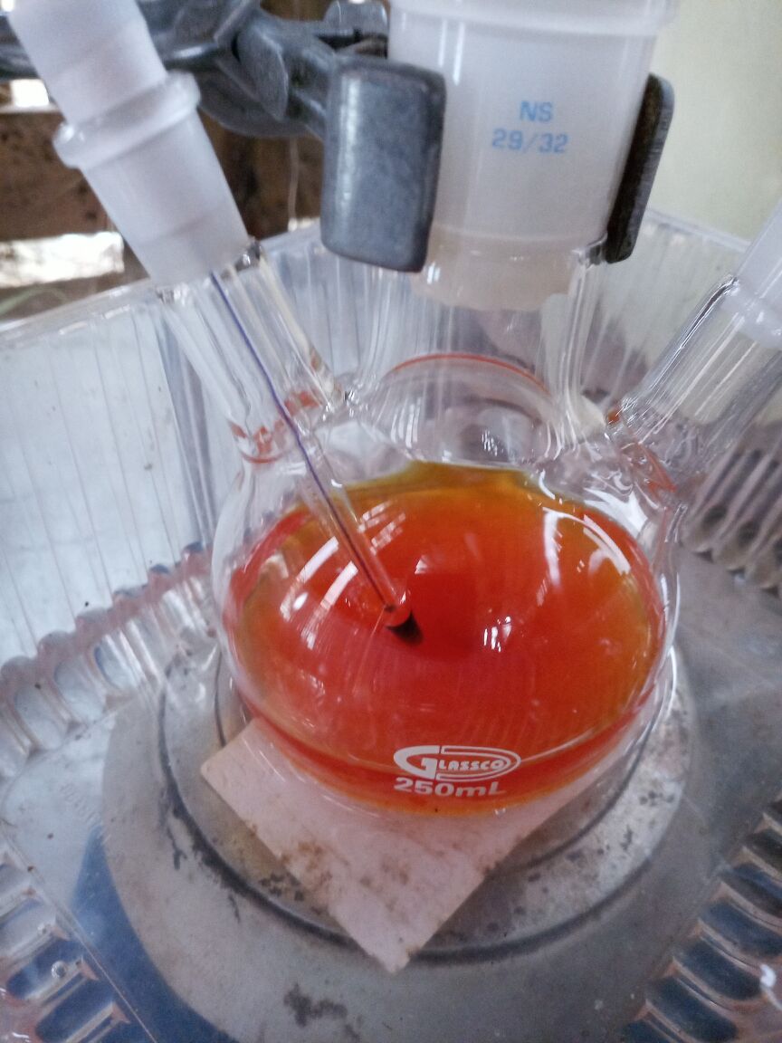

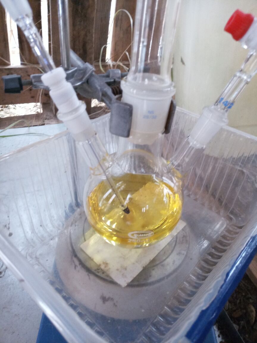

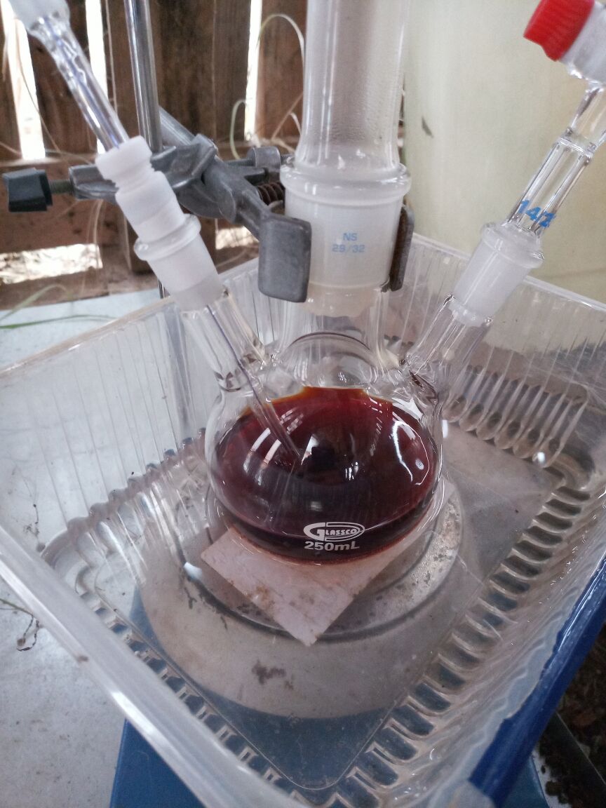

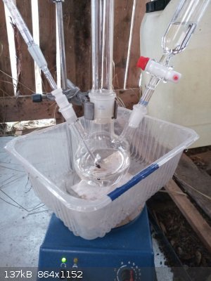

Into RBF was added 14,8 g t-butanol + 102,0 g acetic anhydride at room temperature while mg. stirring, transferred outside and let to cool down below 0 C.

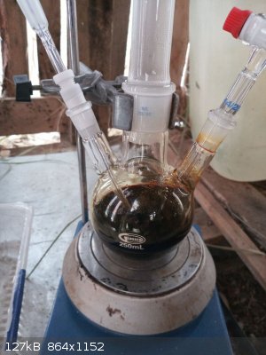

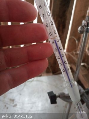

25,0 g 70% HClO4 was dropped into the reaction very slowly from the beginning. Snow-water bath was applied to keep T below 50 C until crystals of product appeared. Then the addition of HClO4 was continued faster than at the beginning, when completed, the T was 70 C (too much cooling or too slow addition or just 10-times less scale?). Heating was applied to reach T 105 C which was kept for 15 minutes, then heating stopped and the reaction slowly cooled down to 10 C. Magnetic stirring stopped and flask let to stay undisturbed for 2 weeks at 10 C (unnecessary long, I did not have time to complete the experiment earlier).

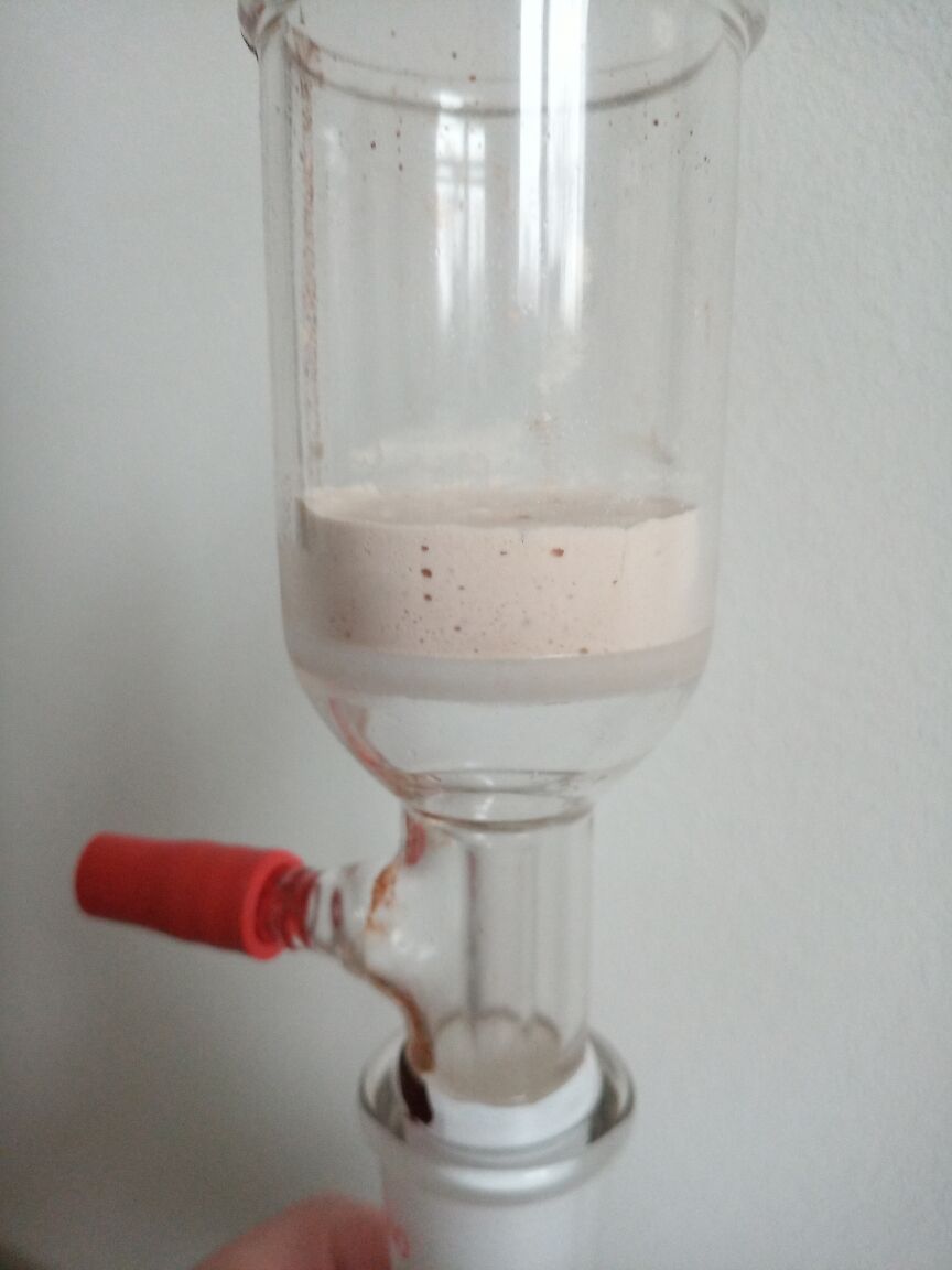

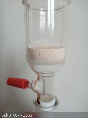

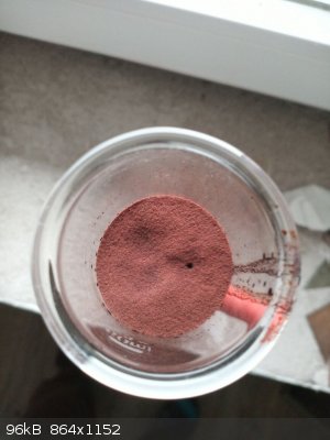

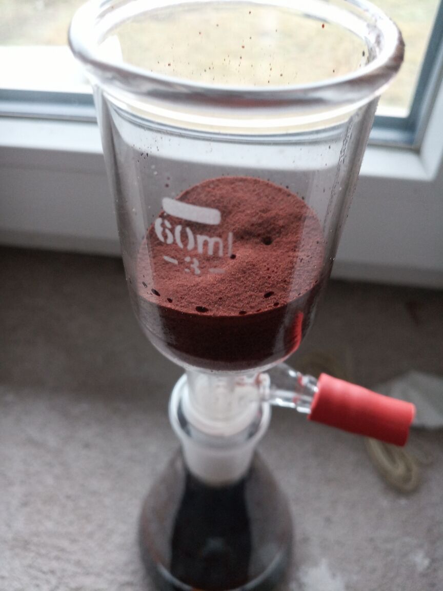

Product was vacuum filtered on sintered glass, washed 2x with 20 ml of 1:1 mixture acetic acid : diethylether (orgsyn washed only once, but I wanted my product as pure as possible), 2x with 20 ml of diethylether. Air dried. Yield 8,9 g.

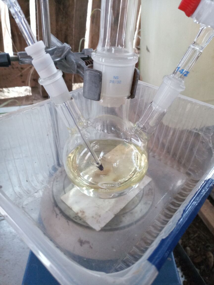

t-butanol + acetic anhydride before HClO4 addition
IMG_20260122_105854_6.jpg - 137kB

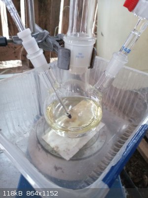

after first drop of HClO4
IMG_20260122_110006_2.jpg - 118kB
after few drops of HClO4
IMG_20260122_110024_8.jpg - 112kB

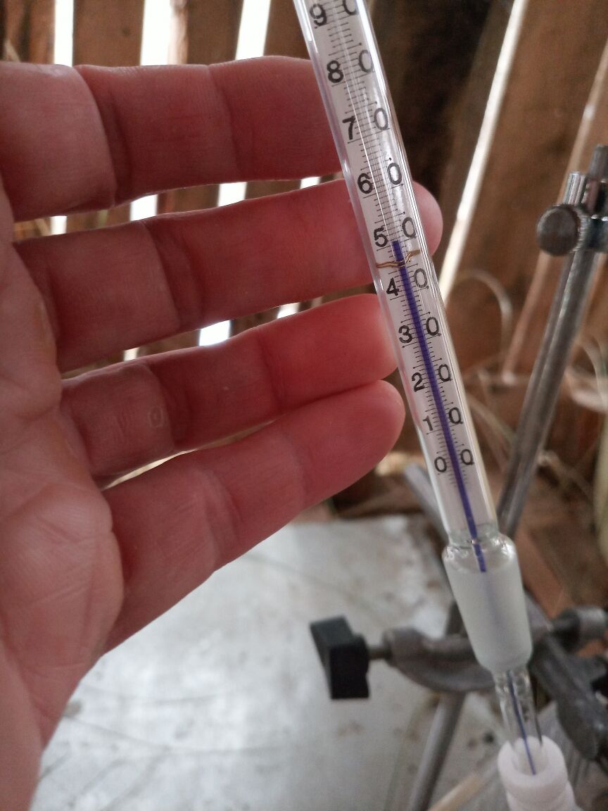

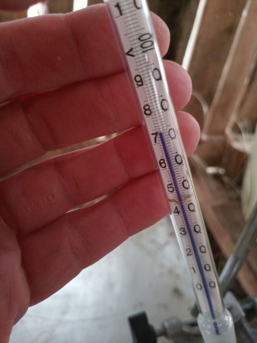

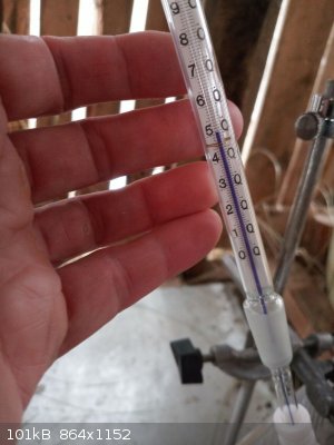

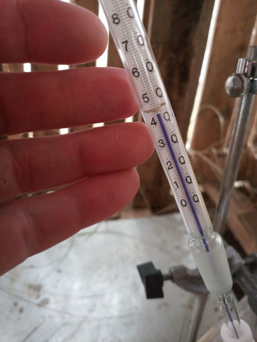

T rose quickly at the beginning
IMG_20260122_110146_7.jpg - 94kB

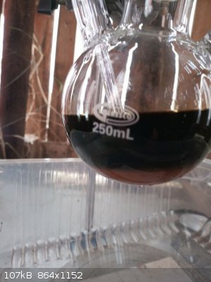

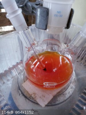

continuing addition of HClO4
IMG_20260122_110242_8.jpg - 114kB IMG_20260122_110508_2.jpg - 133kB

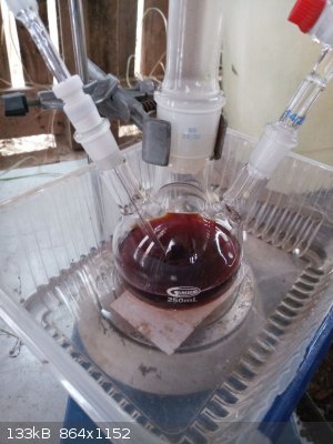

snow + water cooling applied to keep T below 50 C until crystals of the product appeared
IMG_20260122_110514_9.jpg - 101kB IMG_20260122_110754_0.jpg - 107kB

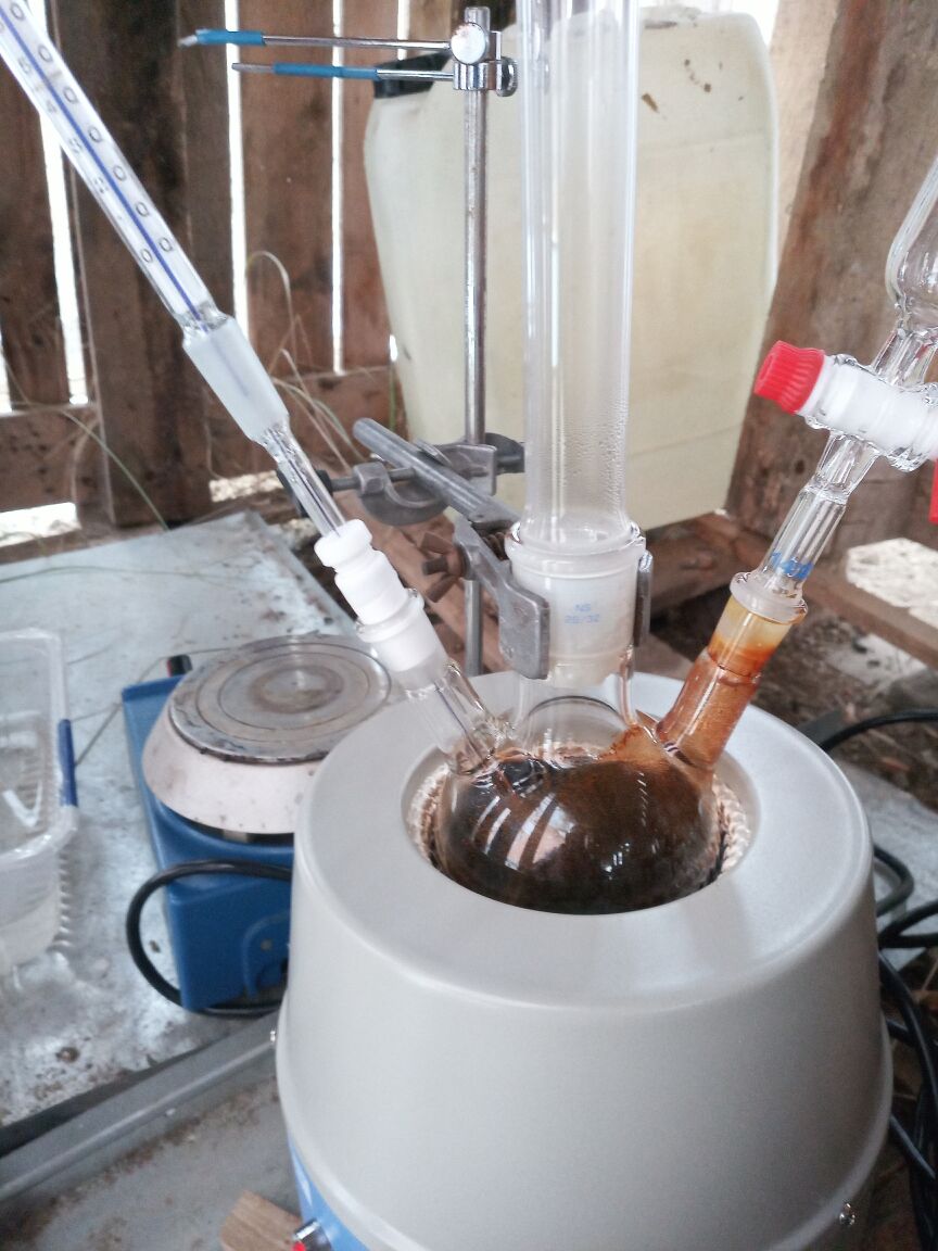

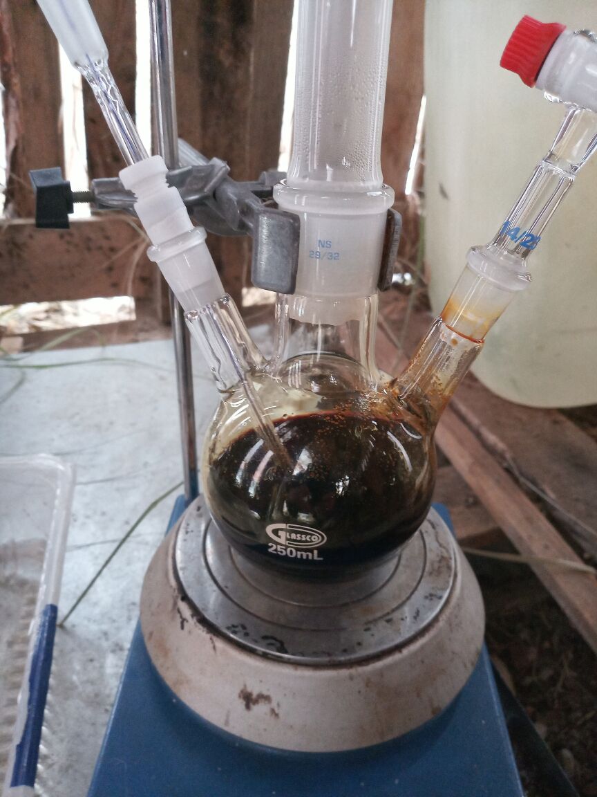

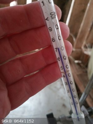

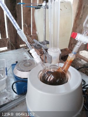

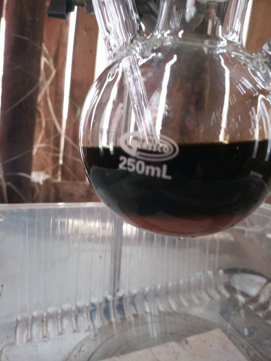

when the addition was done the T was only 70 C so cooling bath removed, but the T did not rise further, then heating mantle used to increase the T to 105 C... I do not know whether heating was necessary and whether the 70 C was not already enough
IMG_20260122_110954_2.jpg - 127kB IMG_20260122_111147_0.jpg - 96kB IMG_20260122_111642_7.jpg - 123kB

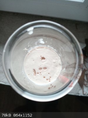

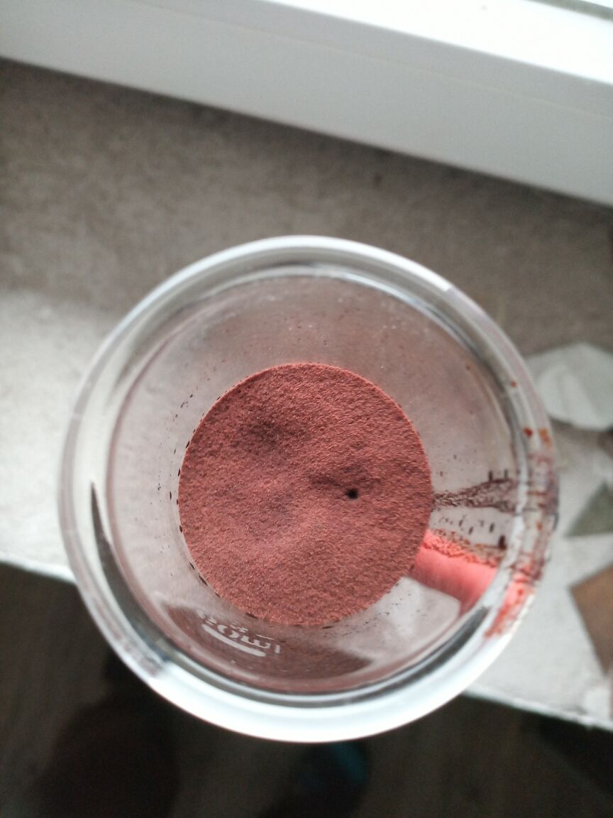

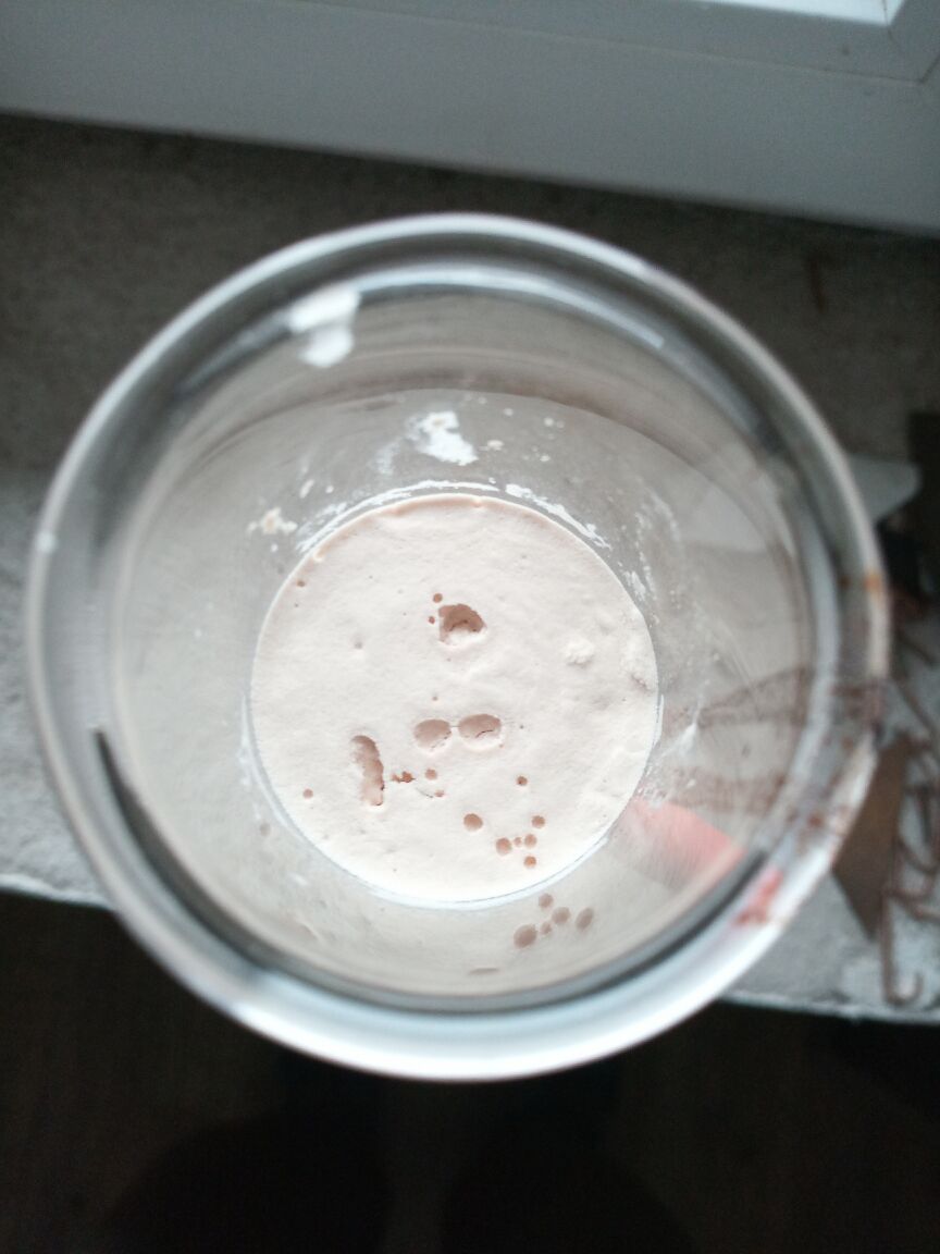

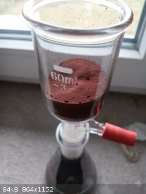

vacuum filtration of the product and the product after washing
IMG_20260207_155550_9.jpg - 84kB IMG_20260207_155556_5.jpg - 96kB
IMG_20260207_161248_2.jpg - 78kB IMG_20260207_161326_2.jpg - 58kB

Hi Boffis, I scrapped the product while it was still wet, I used plastic spoon. I had a big protective shield on my face just to be sure. Using Buchner funnel with filtration paper is safer.

Kitchen plastic funnel with a plastic mesh (analogy of Hirsch funnel) with filter paper could be much safer than sintered glass or porcelain Buchner. Shrapnels of glass are not visible in tissues by surgeon eyes thus impossible to remove from body on an accident, they are also almost invisible on X-ray scans.
