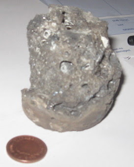

[*] posted on 19-8-2011 at 06:14
This is an example of thermite alumina but not a very good one. This silicon thermite, boosted with chlorate/Al powder, didn’t reach a high enough temperature for the reaction product mix to collect at the bottom of the crucible, so a lot of it froze up on the way down. Despite its porous nature, this little sculpture resists hammering down very well: it's much harder than many a common rock. In it are embedded ‘studs’ of silicon metal (hard to see on the photo), one about a cm wide.

As said above, thermite leftovers are fused alumina - hard, unreactive, and contaminated with whatever metal was being reduced as well as anything else around. Alumina targeted at abrasive use is also the fused variety, it dissolves in HF or fused NaOH. Pottery grade Al2O3 isn't much better, even pottery grade Al(OH)3 can be slow to dissolve in HCl.
Which is why I suggested starting with agricultural/gardening grade Al sulfate and using one of the bases I listed to ppt out nice fresh Al(OH)3.
Bezaleel
Posts: 444
Registered: 28-2-2009
Mood: transitional
[*] posted on 19-8-2011 at 06:20
On the Ammonia aluminate, you have the literature as I gave it to you, and my comment was completely in keeping with it, to quote "only limited indirect support for its existence) or, more likely, an ammonia peptized Al(OH)3 gel"
Maybe you could post the reference to literature that I may read the article myself? I'm amazed about amonia being capable of reacting with the oxide layer in one way or another.
