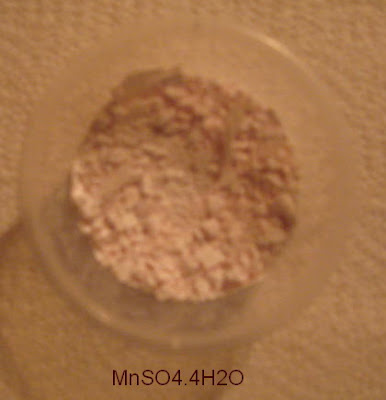

Here’s the product, 34 g of pink MnSO4.4H2O:
But that’s only the equivalent of 8.4 g Mn or 13.3 g MnO2, so actual percentage yield from 100 g of crud was quite low.
