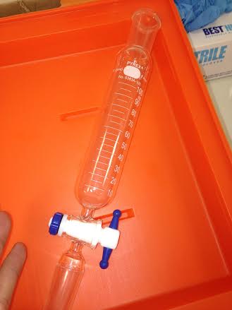

Is there an easy way to do it without an FTIR or similar to analyze your product? I'm actually a professional chemist working my first job in R&D at a plastics company but the place is brand spanking new and therefore is light on a lot of chemistry basics you'd find at an average lab (I had to buy RC car fuel and distill out the nitromethane when I needed methanol). Anyway, the glassware kit we bought had this addition funnel with ground glass joints top and bottom that I'd like to try and use for fractional distillation. I bought some 1cm glass beads at the craft store and used them to fill the column which I think will make for a good fractionating media. Of the non-chlorinated solvents we have available (ethyl acetate, IPA, THF, acetone and xylene) I think the best pairing for a test would be acetone/THF (BPs 10°C apart ). I have it handled up to that point, what I'm struggling with is how I can confirm the purity of my final product without the spectroscopy I took for granted back in undergrad.

In your original post you show a picture of a piece of glassware. What is it and how do you intend to use it in this case?

It is an addition funnel. However, he intends to use it as a fractionating column. I think it's worth a try, but is unlikely to be as good as the real thing.

Don't bother trying to use that addition funnel as a <a href="https://en.wikipedia.org/wiki/Fractionating_column" target="_blank">fractionating column</a> <img src="../scipics/_wiki.png" />. Just buy a real column off of eBay, or from a lab supplier&mdash;they're relatively cheap. There's too much of a constriction in the stopcock bore for your plan to be successful. Also, stainless steel, copper, and bronze scouring pads ('wool') should all be available at a local hardware store, and make great column packing.

I agree. The bore on that stopcock plug is likely no more than 3mm. It will severely restrict your boilup rate.
Separating two liquids with a bp difference of only 10°C is going to be a challenge. My guess is that you will need a column of length no less than 600mm. You might also need a still head that will provide reflux control.
Packing diameter should be ideally be no more than 1/4 or 1/5 the diameter of your column. And almost anything will be better than spheres. Broken glass is not bad and a SS scrub pad can be quite good.

If you somehow managed to connect the addition funnel upside down it should work fine. Just a thought.
I agree it's far from ideal but I thought I'd give it a try just to see. I obviously won't get great throughput but I'm curious if it will work at all. I might also try removing the stopcock and sealing the sides so that the vapor can pass through the bore with less restriction. Teflon tape and parafilm perhaps? I hadn't considered using a scouring pad as a packing material, definitely worth a try. Are glass beads really *that* bad?
