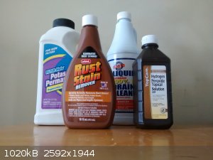

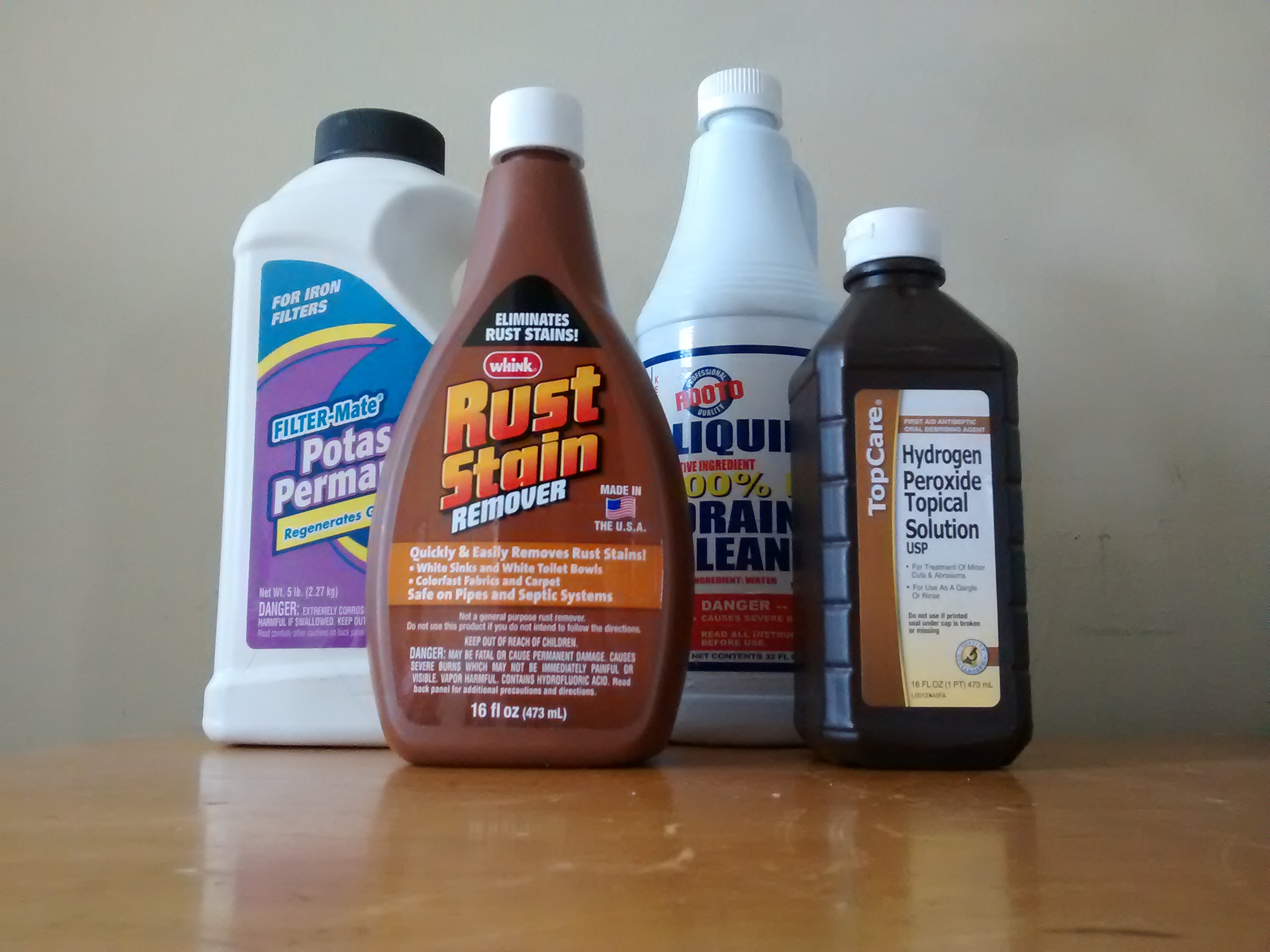

IMG_20151118_120028737.jpg - 1020kB
300ml of dilute hydrofluoric acid solution was added to a 500ml polypropylene beaker. The exact concentration is unknown; the MSDS states 1%-2.3%, and the quantities of other reactants were calculated assuming 1.2%, as an excess of hydrofluoric acid does not effect the reaction. To this was added 12g of 14% potassium hydroxide solution, 4.7g potassium permanganate dissolved in a minimum of water, and 52g 3% hydrogen peroxide.
<iframe sandbox width="280" height="160" src="//www.youtube.com/embed/PgXvecQw6yQ?rel=0" frameborder="0" allowfullscreen></iframe>
The reaction produces oxygen gas; avoid inhaling the fluoride-containing aerosol. The result is a light yellow solution/suspension.
K2MnF6 is a sparingly-soluble yellow compound, so the synthesis was successful. This liquid could be mistaken for a suspension of extremely small manganese dioxide particles, however, once enough peroxide has been added to remove all purple/pink color, addition of additional peroxide does not produce more gas, as would be expected from a suspension of manganese dioxide particles.

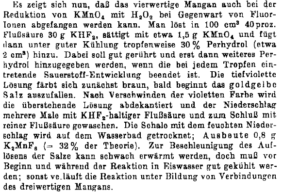

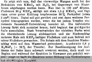

This is not K2MnF6. The salt is decomposed by water and you are working in nearly pure water with neglectible concentrations of reagents. The whole procedure is different from your experiment. And the "original documentation" is a different one. This:
Unbenannt.png - 87kB
http://onlinelibrary.wiley.com/doi/10.1002/ange.19530651108/...
You did't get a precipitate, so your conclusion is wrong.

Pok
potassium Prometheus
Posts: 176
Registered: 5-12-2010
[*] posted on 19-11-2015 at 09:46
Take a look at the references of your source. Your source quotes my source. And your source doesn't specify the reaction conditions. Anhydrous conditions aren't necessary, but highly concentrated solutions - e.g. 30 % H2O2 instead of 3 %, 40-50 % HF instead of 1-2 %. H2O2 has to be added drop by drop. The reaction has to be cooled with ice.

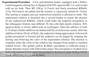

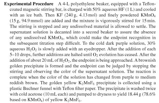

Here is a similar instruction from Christie's description:
Unbenannt.png - 156kB
http://onlinelibrary.wiley.com/doi/10.1002/9781118409466.ch1...
The lack of a precipitate isn't surprising. But your observation is only based on a colour and nothing else! There is not the slightest evidence for the existence of the desired product.
What the yellow stuff could be? I stated it: impurities. You used household chemicals. These aren't pure reagents but can contain all sorts of contamination. It's impossible that it is K2MnF6, because that hydrolyses in water and your whole procedure lacks in some essential conditions.

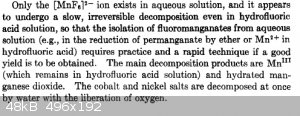

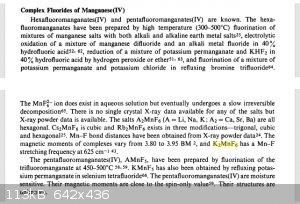

Here's an excerpt from the reference fluorescence mentioned. My wishful thinking has me focused on the keyword "slow".

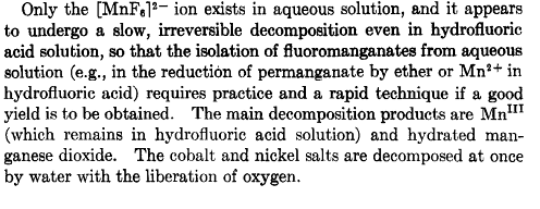

Not "slow" is the keyword but "even in HF solution"! Again the original literature:
Unbenannt.png - 48kB
https://books.google.de/books?hl=de&lr=&id=DbACnFyLS...
So you see that your source simplified the main statement from the original source!
In "aqueous solution" can mean anything but it doesn't necessarily mean "in water". 50 % HF is an aqueous solution, too. If you look at the decomposition products: Mn(III) ions will form. These are yellow/brown in solution as far as I know.
