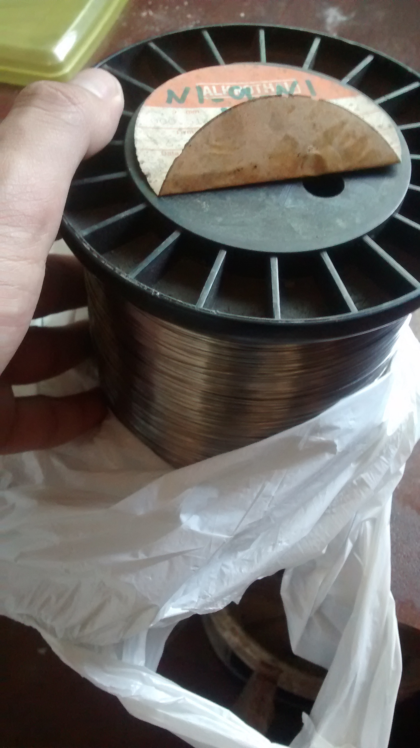

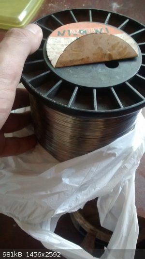

Hello
Bringing up this old thread since I got a roll of over 2 kg of NiCr wire and because I dont have any nickel salts I want to extract some of it to make a small amount of nickel sulfate.
The_Davster in this thread and someone in another thread said that because of the amphoteric nature of chromium oxide will dissolve in excess of base, so my plan is to dissolve some (about 50-100g) in HNO3, aqua regia or HCl/chlorate and precipitate all with NaOH, wash with water then leach with hot concentrated NaOH to dissolve chromium oxide.
Could this work well?
Thanks!

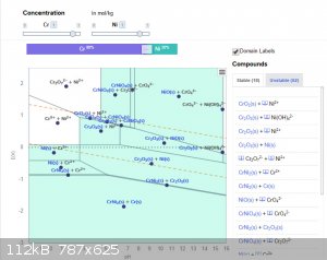

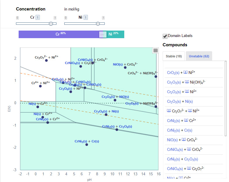

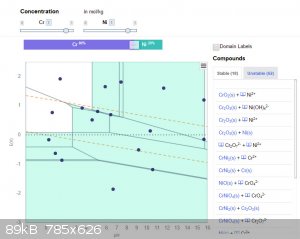

I know my link did not work. But it did contain the answer to your question (and a lot more besides.)
Pourbaix diagrams show pH on one axis and oxidative potential on the other. They show what ions and precipitates will be present for any combination of these two parameters. The entire region is divided into zones so that you can see what is stable under what conditions.
19-02-2016 10-23-33 AM.jpg - 89kB 19-02-2016 10-23-45 AM.jpg - 112kB
Typically, there are dotted lines shown that indicate stable aqueous conditions. Outside those dotted lines you can potentially oxidise to produce O2 or reduce to produce H2. (It does not always happening depending on what other redox reactions are occurring.)
Anyway, for the Cr/Ni at high concentrations, this is what the diagrams look like...
(The labels do get in the way but when you view it online there is a nice mouse-hover that tells you what is stable in each zone.)

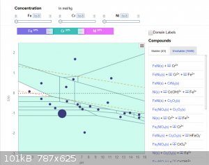

You can also see what happens when Fe is added to the system. Regions shaded blue are where there is an insoluble component. Even at very low concentrations, inclusion of Fe will result in a lot of precipitate -- which may or may not be helpful in any given application.
