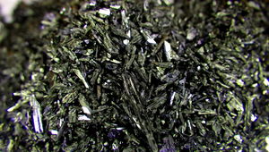

| Ammonium permanganate crystals

| Appearance | Violet-brown or dark purple metallic crystals |

Ammonium permanganate is a violet-brown or dark purple metallic crystalline or powder, which slowly turns steel-gray over time. Aqueous solutions are magenta–rose in color. It is slightly soluble in water and insoluble in acetone. The density of NH4MnO4 is given different values in literature, with the most recent measurement being 2.2 g/cm3 at 20 °C.[2]
