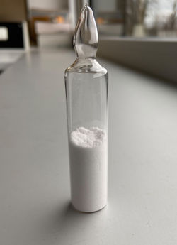

Copper(I) chloride
| CuCl prepared by a member of the Ex&F community.
