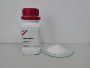

Caesium chloride
| Caesium chloride sample

| Appearance | White hygroscopic solid |

Caesium chloride is a hygroscopic colorless solid, extremely soluble in water.
