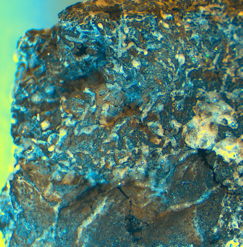

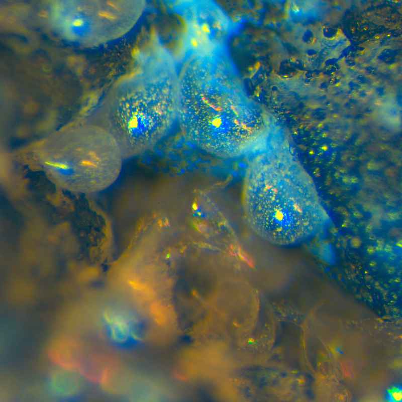

I did a few exploratory experiments with these carbon foams and a sodium silicate solution (waterglass). I tried three basic treatments:
* repeatedly soaking in waterglass, then dilute sulfuric acid, then rinsing
(Na2O)x·(SiO2)y + xH2SO4 -> xH2O + ySiO2 + xNa2SO4
the idea was to coat or permeate the foam with silica. The foam was baked to dry after each dunking in the waterglass, which led to the formation of many tiny sodium silicate bubbles. These structures survive the acid treatment as this photomicrograph show. At high magnification, there appear to be small silicate needles on the carbon.
roastedSilicateWide.jpg - 1.3MB roastedSilicateBub.jpg - 959kB

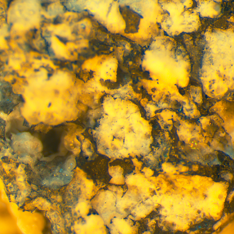

It seemed to stand up to a MAPP gas torch pretty well; afterwards, the pores of the carbon foam seemed to have been filled with a bubbly/crystalline silicate
blazedSilicate.jpg - 1MB

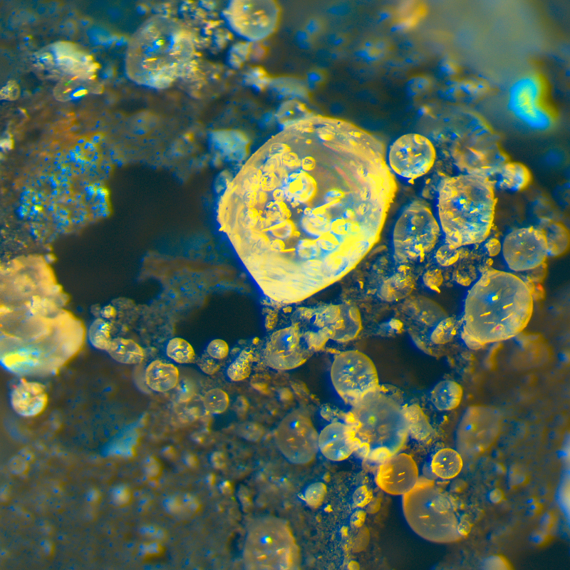

* soaking in boric acid, baking to dehydrate to boric trioxide, then soaking in waterglass
(Na2O)x·(SiO2)y + zB2O3 -> (Na2O)x·(SiO2)y·zB2O3
Boric acid was dissolved in absolute EtOH, and the carbon foam soaked in the solution. It was dried, then baked to dehydrate, then soaked again. After a couple of repetitions, this was dunked in waterglass and baked dry again. The result was a fluffy, flakey white crust on the foam. When hit with the MAPP gas, the whole structure crumpled, suggesting that the boric/silicate soak had permeated and disrupted the carbon network, such that it lost all integrity when the intersitial material melted. When examined, the silicate/boric material had melted into droplets clinging to the foam surface, which cooled into tiny beads containing air bubbles. I wonder what role the foam geometry (voids, ridges) have in forming the beads?
glassDroplets.jpg - 1MB
