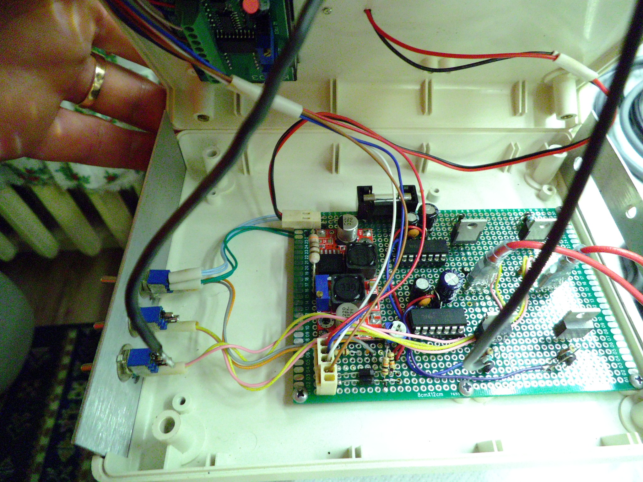

hacker
Posts: 34
Registered: 18-12-2018
biggrin.gif posted on 2-1-2019 at 03:01
Housing for Power Controller
regulator.jpg - 510kB

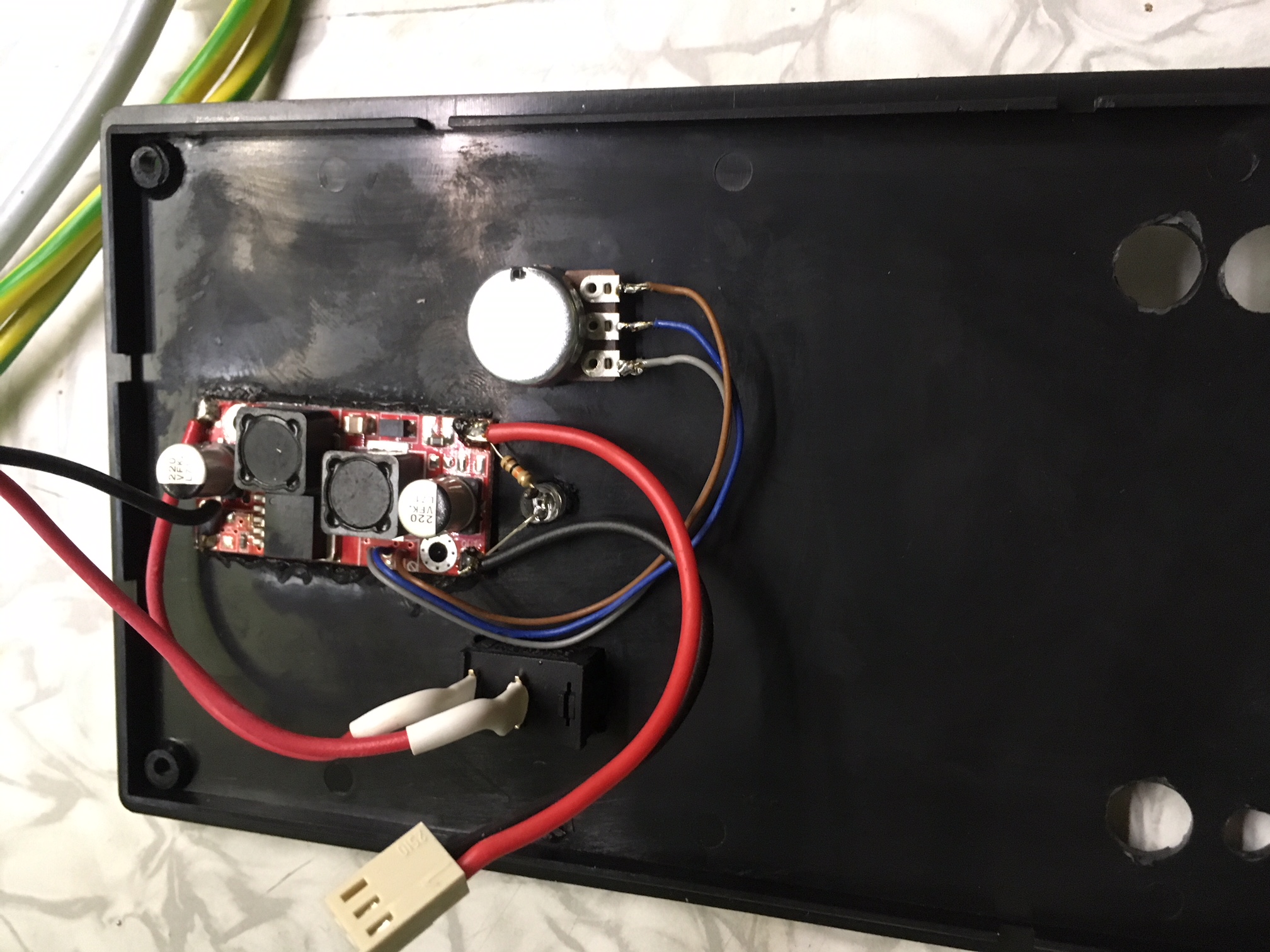

Time to build this into a proper casing and add a speed control circuit:
IMG_3940.JPG - 775kB IMG_3942.JPG - 933kB IMG_3944.JPG - 759kB IMG_3945.JPG - 852kB
All done and the two stages connected in series for vaccuum operation:
IMG_3948.JPG - 1.7MB IMG_3949.JPG - 1.1MB IMG_3934.JPG - 683kB
Due to the sepic converter I added it can now be operated from basically any source of DC voltage in the range of 3-35V. Rpm can be fluently regulated with the pot knob. It runs very smooth and quiet and pulls more than enough vaccuum for filtration operations even at minimum speed.
