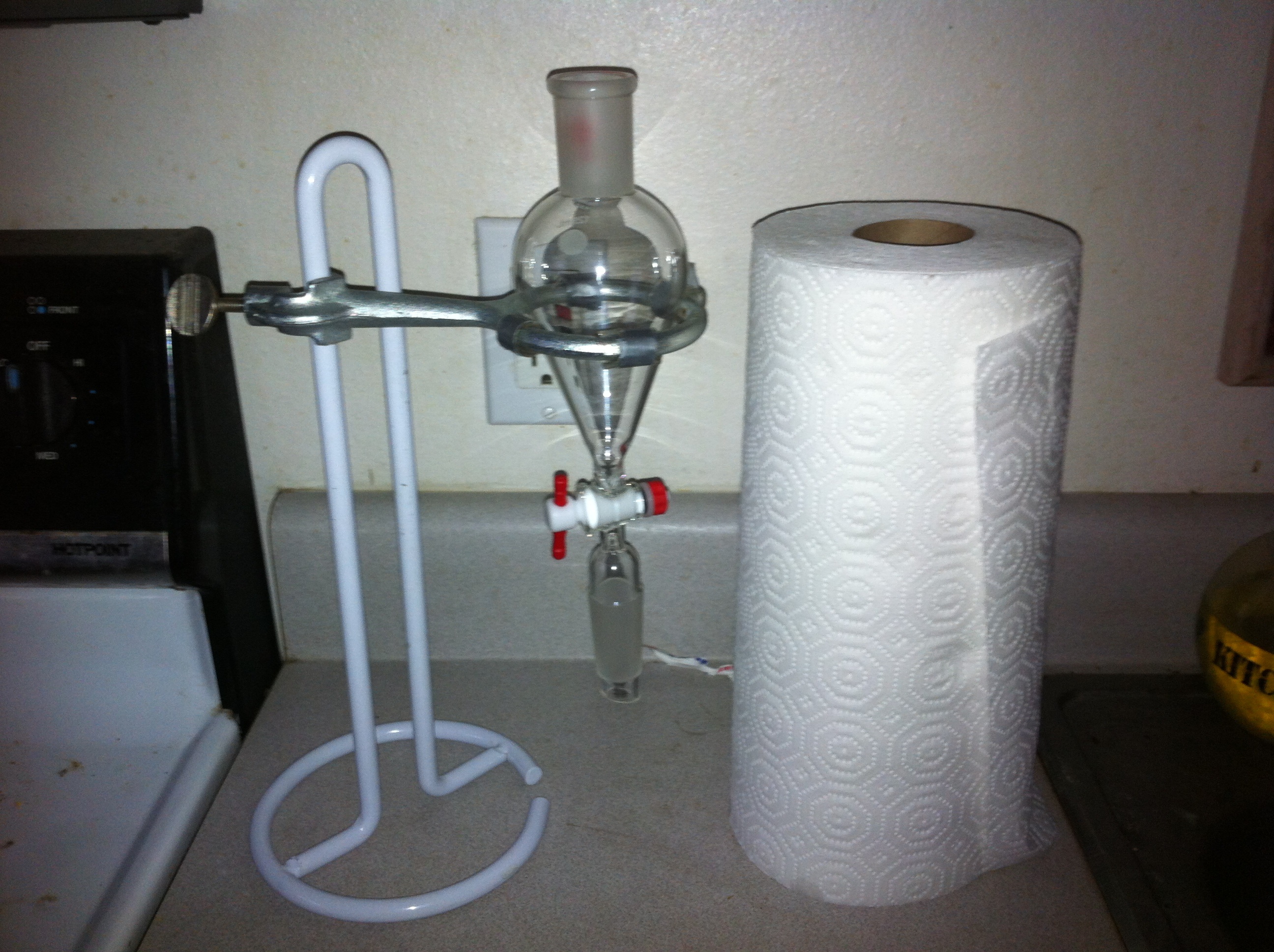

Here is a $2 paper towel holder from the thrift store that makes a great lab stand!!
image.jpg - 1.2MB

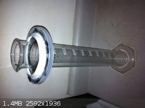

And this is the top of a plastic supermarket hummus container turned into a bumper for a 500 ml graduated cylinder
image.jpg - 1.4MB

What's the idea of the "bumper" on the graduated cylinder, Hellafunt ?
In case of tip overs?

[*] posted on 13-3-2015 at 11:53
response to zombie
exactly. they keep the cylinder from breaking if it topples. commercial bumpers are available, but they come in sets and I didnt need all sizes. I think if one buys a cylinder new a bumper is included, but i avoid new equipment whenever possible.

That is quite tidily done Sulaiman.
Posts: 3947
[*] posted on 14-3-2015 at 02:39
Thanks,
there is one oversight though,
the horizontal bars can rotate or slide up/down or on/off,
but I should have made the vertical dowel removable from the base for easier storage.
It was made quickly from various bits of wood that were in my shed and I don't have a tap/die of suitable size.
I thought of using a tapered wood screw in the base of the dowel to make it removable but I was lazy so I just glued it in.
