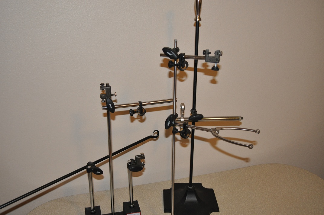

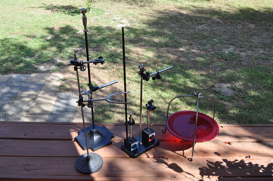

Yesterday I fiddled around in the garage and came across some magnet clamps purchased from Enco and thrift store stands bought a few years back. One
stand was from a fireplace utensil set where a stoker, broom, shovel and tongs hung from. Another some lamp base or such and another mystery stand.
The other parts are an old curtain rod I had with a curl or hook at the end, some V-shaped fixture that held a light bulb, and odd little square beam
clamps bought at a habitat for humanity store that accepts 1/4 20 screws in 3 places and a smaller screw in another plus some holes - maybe not all
that useful here, but an afterthought.
The last parts are some fixtures or branch pole things for the magnet bases that are all iron or steel except for the knobs that sleeve over nuts
underneath. In a way they are reminiscent of ring stand parts. Its curious how the outermost hole tightens first and then the inner, kind of unusual
to get used to. The outermost holes are two sizes if you have rods/poles that match the diameters.
https://www.bhphotovideo.com/c/product/1084866-REG/platinum_...
This hodgepodge isn't all that great or ideal, but was a start cobbled together from dissimilar parts just to see what might evolve.
Now to find some fingers of some sort I guess ...
The small 3-legged stand is another object bought at the thrift store and an old ~12 inch diameter glass stoplight lens which is now a little bird
bath.

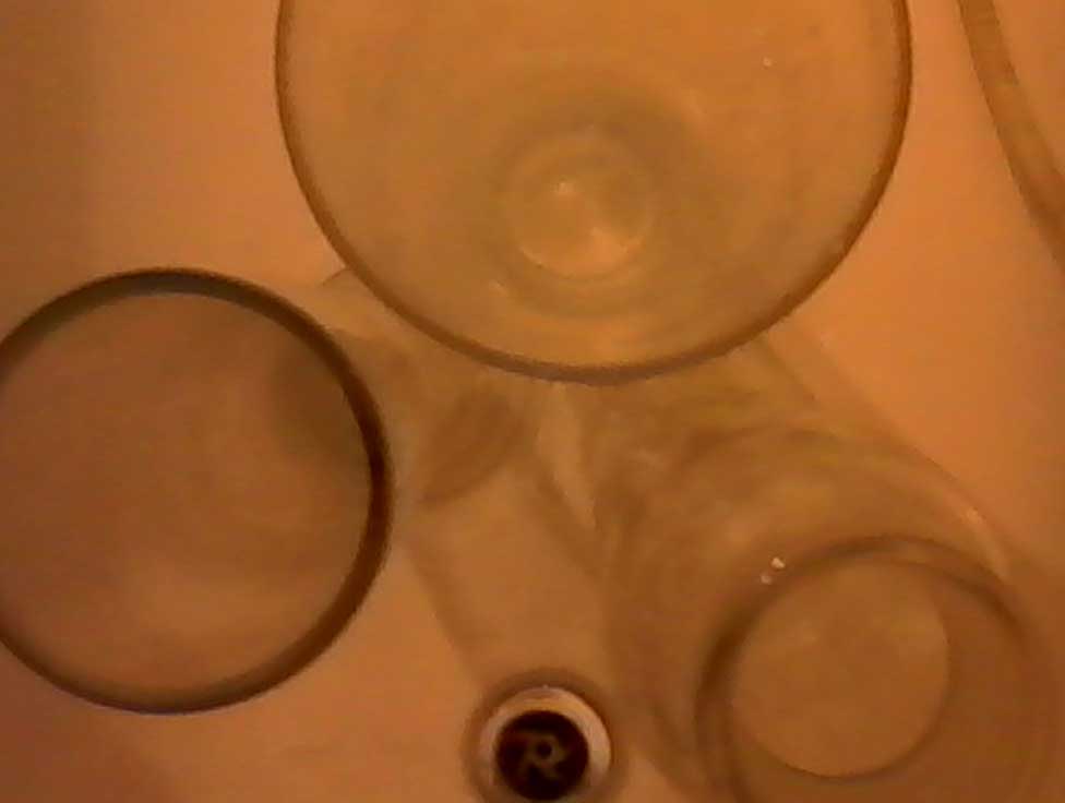

Here is a pic of the two coffee glasses side by side. The green tint of the right hand one is distinct. Of cause although they looked identical and
come with identical metal housings (removed for the pic) I am not certain they are. I also swapped the position of the glasses incase the green tint
was from a nearby object.
This is weak evidence as I am assuming they are identical as they were purchased together. Apparently the the green color comes from iron impurities
in the material used to make the glass. So these must have been made from different batches of material.
This particular green tint seems more emerald green than the dull green tint I usually see in bottle glass.
Here is a pic of two tall vases and a boro 2l measuring cylinder from Fisher Scientific (right lower). All three are about 0.8m tall. The left hand
vase is dark with a hint of green, the top vase has a slight dull green tint and the boro cylinder is lighter with almost no color. I assume the
vases are soda glass. All three appear clear when viewed from the side.
Sorry the pic is poor quality it was taken under fluorescent lighting in the bathroom having just rinsed off the dust.
PS I got lucky when I won the measuring cylinder on ebay no one else bid on it so it was very cheap. Its very impressive given it is almost a meter
long. I am still trying to buy a stopper for it that does not cost more than I paid for it.
