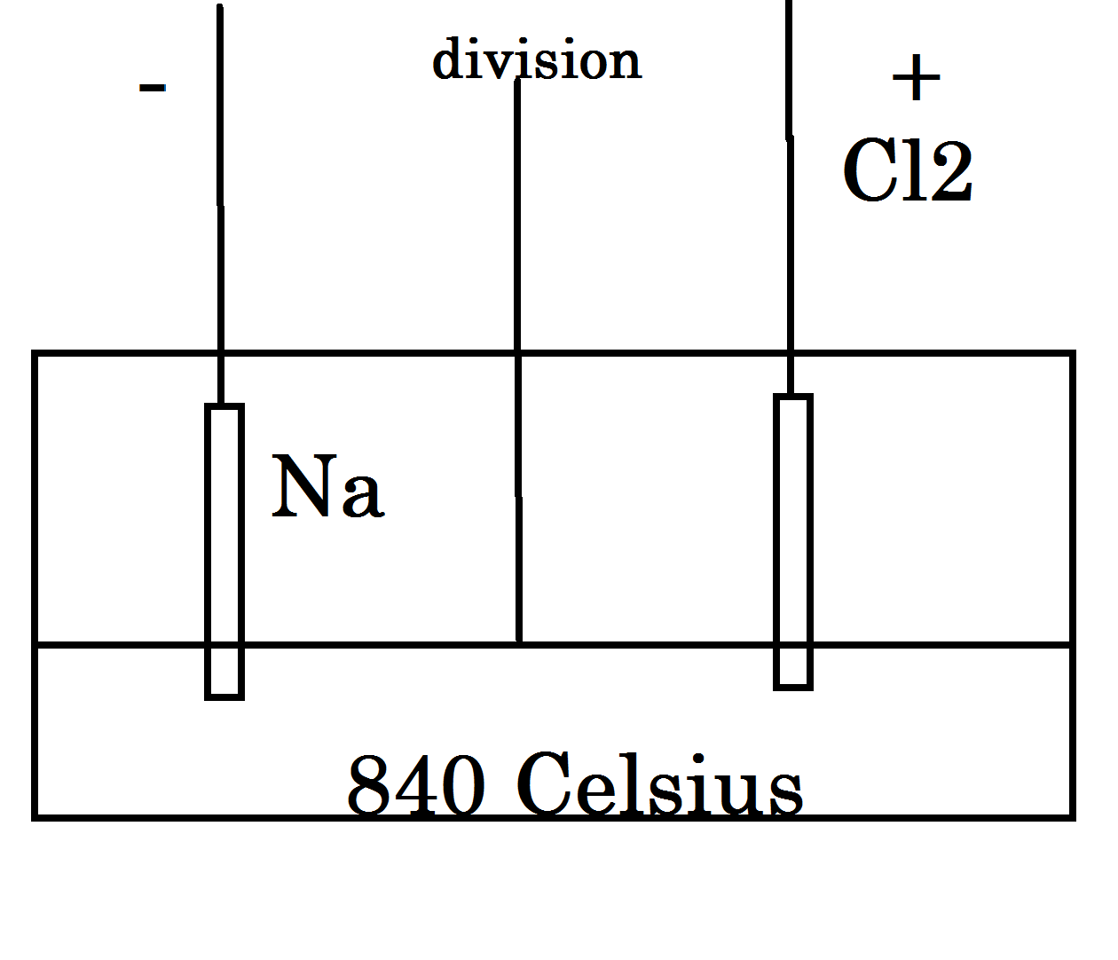

Before you all get too carried away with the math... :D
Remember that chlorine, the product generated at the anode, is a gas and as such, impedes the reliable flow of current. Unfortunately, molten NaCl whose temperature range falls anywhere above NaCl MP and below Na BP is considerably viscous. I suppose this isn't such a big problem if the bath is heated externally in that the NaCl bath will remain molten regardless of the current density, etc.
In any case, once a certain anode current density is exceeded, a fearsome hiss will ensue and efficiency will go through the floor. This is actually an equilibrium between chlorine gas generation (and NaCl displacement from the anode) and the electrolyte flowing back to the anode (as chlorine bubbles off). The result is that the tip(s) of the anode(s) will carry more average current and will erode much faster than the superior part of the anode(s).
When the current density is decreased below that bitter sweet spot, I get 'burbling' at the anode. Sodium and chlorine are red/ox'ed rapidly. This is the Downs Cell sweet spot as far as I'm concerned.
Sorry, I got a bit off topic. Anyway, how does one account for gaseous product(s) when planning out electrode configuration, resistances, etc?? Surely the viscosity of the electrolyte must be taken into consideration??
Tank

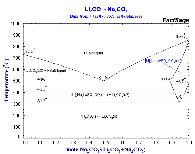

Using the information from this phase diagram here:
Li2CO3-Na2CO3.jpg - 78kB
I made a 50/50 mole% Li2CO3/Na2CO3 melt of about 17 grams total. The crucible was mild steel. I actually just wanted to
watch it melt, but once it did I decided to try electrolyzing it to see what would happen.
I figured that no alkali metals would form at the cathode, because for one thing, lithium is so reactive at those temperatures
that it would immediately react with the electrolyte if it was formed at all. So I used a copper wire as a cathode, and a graphite
rod as an anode, and electrolyzed the melt at 0.5-1.0A.
After running the cell for ten minutes or so, the power was shut off and the electrodes removed. The anode showed noticeable
erosion, but it was a "clean" erosion; it wasn't disintegrating or spalling, but wearing smoothly. The cathode was encased in a
hard, black, material that looked like carbon sponge. It was quite hard, but voluminous considering the amount of energy
that had passed through the cell. Upon submerging this cooled material in water, no gas evolution was noted. The black material
was then crushed underwater with pliers, and still no gas was produced.

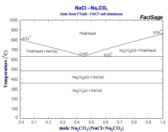

The next experiment will probably start from this system:
NaCl-Na2CO3.jpg - 70kB
with Li2CO3 added incrementally until I begin obtaining an adherent deposit of carbon at the cathode. The current density was
probably too high for that little piece of wire last time, so I'll adjust it downward until sodium stops floating to the top of the bath.
Over time more carbonate will have to be added. In a way, CO2 is being co-electrolyzed using lithium as a catalyst
of sorts. According to the reference mentioned previously CaCO3 can be used to add CO2 back into the system, as CaCO3
is soluble in the melt, but the resulting CaO precipitates out.

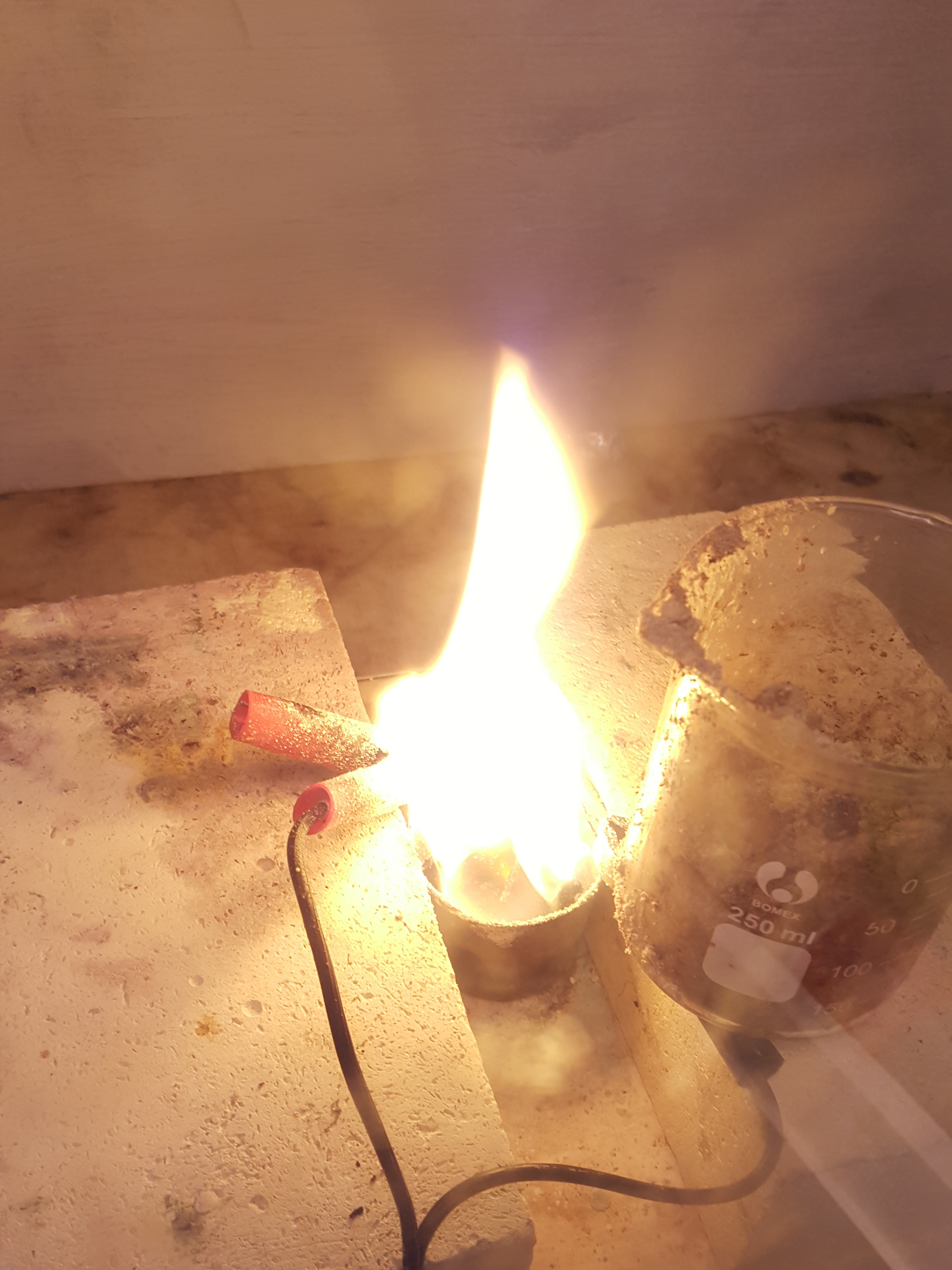

NaK alloy production; shielding with wax
30g NaOH and 30g KOH were melted together in a 100 mL Ni crucible, then ~10A of current were passed through (voltage controlled with variac and rectifier to keep current more or less constant). Unfortunately, the metal burned off as soon as it formed.
Then, I realized that, because the temperature wasn't too high, I could melt paraffin wax on top of the hydroxide to exclude air. In this way, I obtained a pea-sized amount of NaK alloy, liquid at room temperature.
NaK metal.jpg - 126kB
Very good job! That's an innovative and cheap solution to a difficult problem in lab-scale alkali metal production. If you
make another video using the paraffin approach, it would go right to my "download" folder.
Metacelsus
Posts: 2554
Registered: 26-12-2012
Location: Boston, MA
[*] posted on 15-7-2015 at 10:43
Caution: wax is flammable!
I was doing another run, trying to make a good video (so I had my camera with me). A little bit of NaK must have come into contact with air despite the wax. It set the wax, which was heated past its flash point, on fire. I put it out by covering up the cell with a metal lid and waiting a few minutes for it to cool down.
wax fire.jpg - 7.2MB

Making sodium metal from sodium hidroxide
This process uses electrolysis as a means of synthesizing sodium metal. . . Using a heat-resistant vessel that does not conduct electricity, place sodium hydroxide in it and heat it to 320 degrees Celsius. When it reaches such temperature the compound will be liquid and therein place the positive and negative poles of the electrolysis cell and begin the process Of decomposition of the element, soon after a few hours will see white balls in one of the poles, this is the metal sodium, remove it from the container and put in a bowl with mineral oil and store, hopefully have helped. . . You may be confused by what I said, well I do not speak fluent English.:D
Na_sodium.jpg - 15kB
Jstuyfzand
Posts: 166
Registered: 16-1-2016
Mood: Learning, Sorta.
[*] posted on 15-7-2017 at 02:29
Congratulations! You just described the Castner process. :)
Although in practise it's a little more difficult.
[Edited on 15-7-2017 by Jstuyfzand]
Novichok
Posts: 3
Registered: 15-7-2017
[*] posted on 15-7-2017 at 03:14
Making sodium metal from sodium chloride
This medium uses sodium chloride electrolysis. . . In a divided, heat-resistant container (between 1000 ° C) and that does not conduct electricity, place Sodium Chloride and warm the container above 800 degrees Celsius and below 850 Celsius, when heated place the positive and negative poles and when Once the electrolysis process is started, after a few hours there will be a chlorine smell, keep the place ventilated, the negative pole will have metallic sodium balls, separate them at the end of the process and place them in a pot with mineral oil
Attachment: phpOSLjs6 (33kB)
This file has been downloaded 1748 times
[Edited on 15-7-2017 by Novichok]

Would a mixture of NaOH and NaCl have a lower melting point than NaOH?
I could not find any papers or write ups about such mixture, which leaves me with low expectations, but it isnt disproven either.
If this mixture would have a lower temperature, it could be promising for Sodium production at home.
metalresearcher
Posts: 822
Registered: 7-9-2010
Mood: Reactive
[*] posted on 13-8-2017 at 09:12
Add CaCl2 to the NaCl and the mp will lower to 640 C.
Jstuyfzand
Posts: 166
[*] posted on 14-8-2017 at 06:10
I am aware of that, but 640 is still a bit high and unpractical.
A eutectic made with NaOH would be sub 330°C, so I was wondering whether a NaOH NaCl mixture would reach these lower temperatures.
Bezaleel
Posts: 444
Registered: 28-2-2009
Mood: transitional
[*] posted on 24-11-2017 at 09:16
If you can tolerate the presence of potassium in your mixture, then consider the eutectic of NaCl, KCl, and CaCl2, which has a MP of 465 C. Check an earlier post here.
