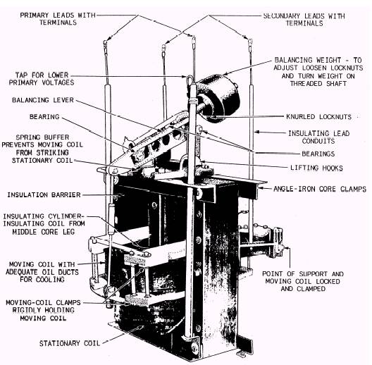

Another picture of CC transformer below from
http://www.tpub.com/celec/5.htm
The diagram suggests the middle leg is part of the 'core', ie. made of Iron.
The permeability of Phenolic would be far too low IMO. The input coil would look like a short circuit and bugger all coupling to secondary would occur.
Dann2
image012.jpg - 53kB
[Edited on 1-7-2009 by dann2]
watson.fawkes
Posts: 2793
Registered: 16-8-2008
[*] posted on 1-7-2009 at 05:17
Coils have inductance even in complete absence of a core, so-called "air core" coils. There are also air-core transformers, albeit specialty items. A core changes the inductance of a coil by a factor of its permeability, but this doesn't eliminate the inductance. Transformer coupling is about the ratio between mutual inductance and total inductance. And a core doesn't change the DC resistance at all.
This whole device hinges on an interplay between geometry of the device and permeability of the material. My intuition about the magnitude of permeability indicates that you're not going to use a maximally-permeable material, but I might be wrong about that. The reason you use a core is to minimize leakage inductance, which increases the linearity of the transformer. But a constant-current source is as non-linear an element as it gets!
If you're trying to regulate over a large range, using an iron core may not be what you want. But at this point I'll simply second the recommendation to run a simulation.
