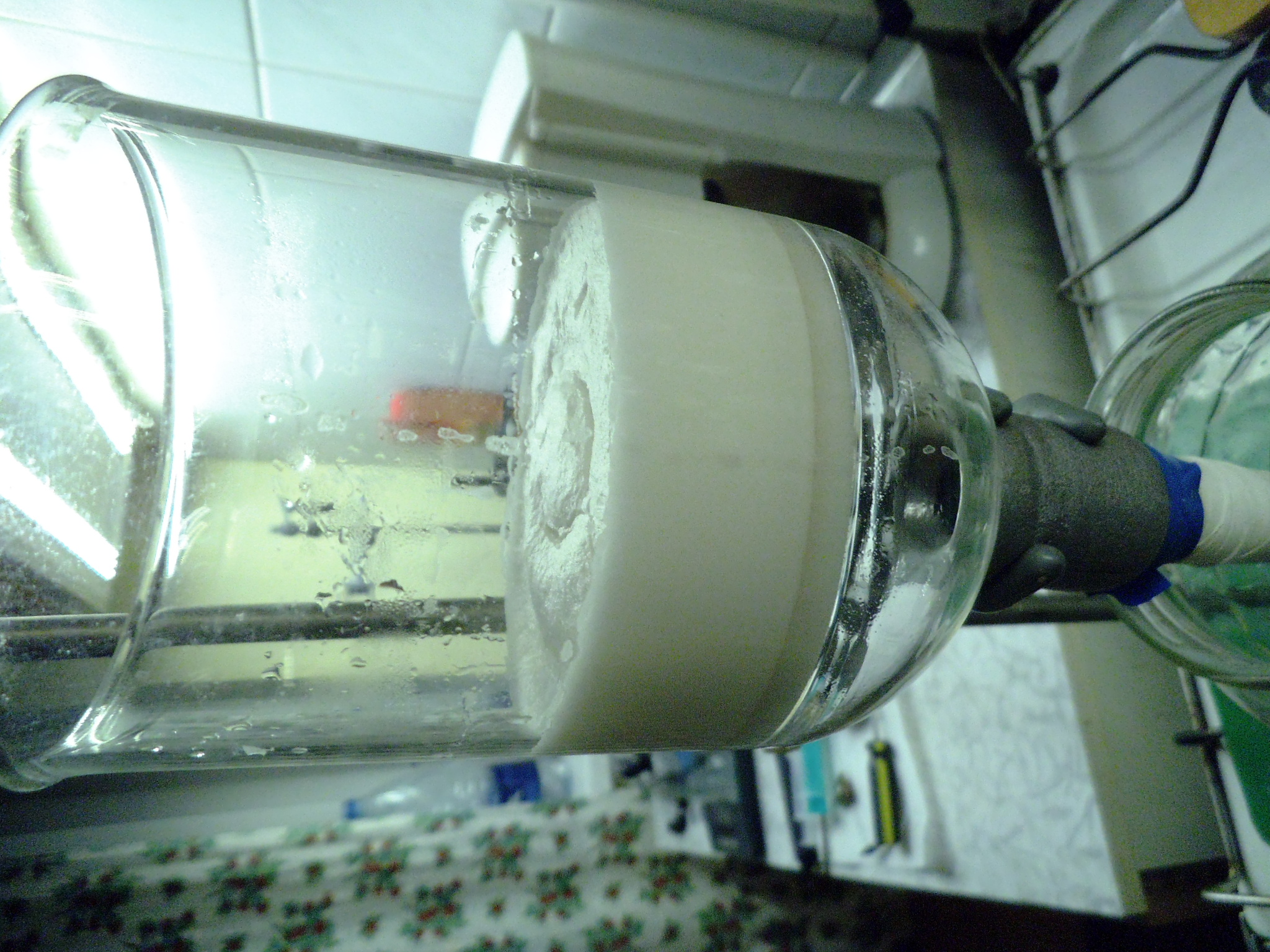

Zooo....the contrapulation has been fizzing away on my tabletop for about 5 days now. The anode stem is not corroding, the anode has not passivated
and conducts very nicely and we have indication of perchlorate in the cell liqour. Both tests, methylene blue solution and percipitation by KCl show
the presence of perchlorate:
I did upgrade to larger cathodes as the stumps I had in there did hinder the process to such degree that I could only get 4,5A through the cell at
best. This will not do in terms of time expenditure....it would take forever to convert that load in the cell. So in went the large Ti cathode plates
I use for chlorate runs. I also made special Ti "bolts" to secure the plates to stems and a key to fasten them:
That's more like it....10 amps and temperature around 50C. I try to keep it around this mark as it is a safe middle ground. No excessive heating, but
still reasonable productivity. The liqour is quite clean as can be seen, so nothing of contaminative character seems to have dissolved into the
electrolyte. Seems to work out this time...

It is coming along very nicely. ClO4- content is growing steadily as recognized from precipitation test results. Ozone can be detected in
off gas flow, not much but it is clearly noticeable.
The titianium bolts securing cathode plates to the stems:
Anode edges can be seen to have lost conductivity (the darker rim around anode bottom part):
Not too bad though, the overall conductivity is very good:
The electrolyte is very clear and translucent. It has lost the greenish hypochlorite tinge, a telltale sign that the convesion is going well and has
reached a stage where perchlorate content has become prevalent.
There is offensive salt creep down the sides of the cell, clearly the seal at the top of the cell needs improvement, but this is more of a cosmetic
issue.

I finally managed to devise a way to make the perchlorate work effectively in fuse formulations: the key is in preparation of the mix. It absolutely
needs a very intimate contact with the fuel, just like black powder based formulations.
There are two major ways to accomplish this in an amateur setting:
a) (ball) milling the mix- not viable for perchlorate formulations (at least my selfpreservation instinct does not allow it)
b) impregnating fuel by a perchlorate rich solution to form crystals in and around the fuel particles
I chose the second option. I made a small 2g sample of 75/25 KClO4/C, but this time I changed the preparation process to try out a "vaccum assisted
preparation" idea:
Ingredients were weighed into a small glass dish and 0,5ml of azeotropic EtOH +1ml water was added. The alcohol serves the purpose of lowering surface
tension to yield better wetting effect of carbon.
The ingredients were mixed with a spoon until uniform (a few minutes) and compacted into a solid cake. The consistency of the mix was like damp dirt
so it stuck together nicely.
After that the sample was placed into a vaccum chamber and evacuated for 30 minutes at room temperature (20C). Then the sample was taken out, the cake
broken up into loose rubble and put back into the chamber. Another session of 30 minutes under reduced pressure and slight warming at 40C yielded a
semi dry granulated product. It was still damp, but good enough to test for burning speed.
A small lump of the prepared mix was collected onto a stainless spoon and ignited with a butane torch: the sample burned with satisfactory violence
and was energetic enough to flying the burning lump off the spoon. Definitely the uniformity and vigor of the burn has been improved by the vaccum
assisted preparation process.
The slightly damp mix was granulated by forcing through a fine sieve and let completely dry at room temperature and atmospheric pressure (24h).
The sample was spun into a lenght of fuse after it had been dried:
It works just beautifully now! A nice hot, energetic burn that proceeds at an even pace with a sharp long flame jet and a powerful hiss. I'm very
satisfied with the outcome.
