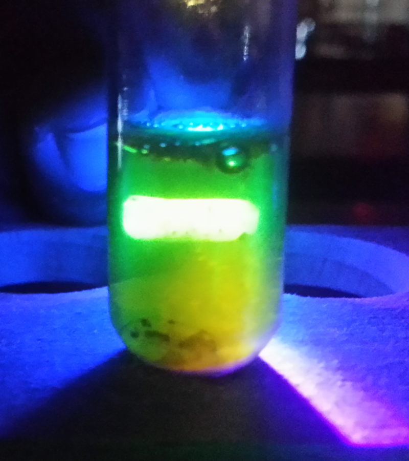

My mentor for the fair took the terbium to his house and tried to break it. He used a saw, a knife, and all sorts of other tools. The only thing that worked was a chisel. We now have small pieces, as well as a large chunk of terbium that made it.
I attempted the synthesis yesterday. 0.48 grams of terbium was added to 1.14 grams of iodine dissolved in 20 mL of methanol. Not all of the iodine was added at once because I wanted to monitor the reaction to see any signs. I added about 20 mg initially, but that was enough to turn the solution a very dark brownish-purple. I added in all of the terbium, but it was very difficult to see with the amount of iodine in solution. A few bubbles were escaping from solution. In order to accelerate the reaction, I added the rest of the iodine. The reaction did not appear to speed up at all.
In a test tube, I decided to perform a test with small flakes of iodine and terbium (exact amounts were unknown) and distilled water (about 2 mL) was added. The solution became yellowish brown and bubbling began. Not all of the iodine dissolved. The two solutions were left to sit for the next day.
The next day, no change appeared in the methanol beaker. The solution remained extremely dark, and terbium was visible at the base of the flask.
Something completely different happened in the test tube with water. The water had mostly evaporated, leaving behind a froth. On the addition of water, it became apparent that all of the terbium had reacted with the iodine solution. No oxide powders appeared to be in the solution. I added in more terbium and water to react with the iodine. After an hour or so, the terbium flakes were bubbling, and a very fine white powder appeared to be suspended in the solution. I forgot to check for fluorescence (terbium oxide exhibits green fluorescence), so I can't be sure if that was the oxide or something else.
I won't be experimenting next week, but I'll update soon.
So what did you get? A clear solution dark coloured due to a KI-I like iodine-complex?
This sounds as if no free iodine was present anymore. Is this true? If this product doesn't dissolve then you should have something different than in the first case described above!
This isn't a good way to check your product. TbCl3 also shows green fluorescence. TbI3 should dissolve in water extremely well but the oxide does not. So this is the easiest way to check your product. But: some rare earth halides form oxy or hydroxy halides when heated in water. This is what you may have produced in the second case (white precipitate)

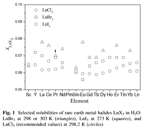

Here is a paper with solubility data for the rare earth halides (except fluorides). I don't understand Fig. 1 there, but this may be the basis to calculate the solubility of TbI3. Does anyone understand this figure and can give an example for the calculation of the solubility of one salt?

Great find [that paper]! I believe, gathered from the text, that 'x<sub>LnX3</sub>' stands for 'mole fraction of LnX<sub>3</sub> in the solution'. A very thermodynamics type of solubility measuring unit. It can be easily converted to the more traditional 'g / 100 solvent'.
And how? Please tell me if the following calculation is correct:
Example: NdCl3
Solublity of NdCl3 = 967 g/1000 ml at 13 °C.
967 g NdCl3 = 3,85 moles
1000 ml water = 55.5 moles
Sum of moles = 59.35
moles NdCl3 / total moles = 3,85 / 59.35 = 0.0649 = the "x" ?
According to Fig. 1 (see below) "x" would be ca. 0.063 at 25 °C.
This sounds correct, right?
test.png - 24kB
Solubilities of rare earth halides
[Edited on 23-11-2013 by Pok]
[*] posted on 23-11-2013 at 10:51
Ok. Suppose a binary system of A and water, with x<sub>A</sub> the mole fraction of A. Call n<sub>A</sub> the amount of A in moles and n<sub>H2O</sub> the amount H2O in moles . Then:
x<sub>A</sub> = n<sub>A</sub> / (n<sub>A</sub> + n<sub>H2O</sub>;)
and:
x<sub>H2O</sub> = n<sub>H2O</sub> / (n<sub>A</sub> + n<sub>H2O</sub>;)
It follows that x<sub>A</sub> / x<sub>H2O</sub> = n<sub>A</sub> / n<sub>H2O</sub>
Also: mass balance: x<sub>A</sub> + x<sub>H2O</sub> = 1
Assume you have 100 moles of mixture (or any number, for that matter), that contains 100 . x<sub>A</sub> moles of A and 100 . (1 - x<sub>A</sub>;) moles of water.
Multiply both numbers of moles by molar mass to obtain weight in g (say A g and H2O g). Divide A g by H2O g and multiply by 100 to obtain gram of A per 100 g of water.
The hydrates of TbI<sub>3</sub> could be a serious hurdle for the OP's project: dehydrating them w/o hydrolysis is going to be nigh impossible I feel. It's hard enough for the chlorides, never mind the more fragile iodides.
[Edited on 23-11-2013 by blogfast25]

Ok. This sounds as if my last post is right. Correct me if this is wrong.
[*] posted on 23-11-2013 at 10:58
No, you are right. It's easier to do it from first principles though, IMO.

I need to clarify something else. The white powder was like suspended dust, very sparse and hard to see. I can't be sure if that was Tb(OH)3 or something else, which is why I wanted to use the UV light to check. If it was Tb(OH)3 the stuff would have glown green.
That's what I'd guess. The solution was dark yellowish brown because of iodine, but there was still some undissolved iodine at the bottom.
There was still dissolved and undissolved iodine in the test tube. Sorry, I should have clarified that also.
Here is a paper with solubility data...
Thanks for the paper; this might be useful for my write-up for the fair.
In either case, did you notice any heat being generated?
I didn't feel any heat in the methanol solution; I just saw bubbles being generated. The iodine solution in water had a lot more bubbling activity.
"No oxide powders appeared to be in the solution." Does this mean the solution was clear?
Correct.

Some success! But...
My whole post (quite a long one) got deleted when I previewed it. I'm not going to bother writing it up again (unless you want me to).
In short, I made some terbium iodide through direct union and heating. The product was confirmed by hydrolyzing a solution of it, precipitating terbium(III) oxide and some higher oxides. I didn't expect this to happen on hydration.
Enjoy the picture of terbium ions fluorescing green in solution.
terbium fluorescence.png - 1.5MB
I didn't expect this to occur. After watching mrhomescientist's video on making terbium nitrate, I found a comment stating that the salt didn't fluoresce in solution. Perhaps the anion can make a difference (there was iodide and triiodide in solution.) I'll try terbium chloride and/or the acetate.
Better pics to come soon.

Fascinating, congratulations on carrying out a direct union. When you feel up to it, I am sure we would love to hear how you did this! Sorry about the deletion :(

I'm surprised it seems to hydrolyse so easily and am wondering if you're perhaps seeing something else. If there's a next time, try acidifying the solution a little with acetic acid (I'm assuming the acetate is very soluble, so won't crystallise when you want to try and recrystallize the TbI<sub>3</sub>;).

At RT the mole fraction of TbCl3 in a saturated solution is about 0.06 (acc. that paper). That works out at 94.1 g TbCl3 / 100 g water (the MM of TbCl3 is 265.28 g/mole).
Dissolving stoichiometric amounts of Tb in HCl 37 % would give you about 142.3 g TbCl3 / 100 g water (assuming no loss of acid or water), so already above the saturation point. On cooling quite some TbCl3 hydrate should form, because much water will be tied up in the hydrate.
Awesome work! I'm glad you saw my video, too. When I made the nitrate, it definitely did not fluoresce while in solution - only the crystals. To make sure I understand your process (I'd love to see a writeup too): you heated elemental iodine and terbium together to form the triiodide, then added this to water to precipitate terbium oxides. Are these somewhat soluble? I.e. how did terbium ions get into solution to enable it to glow?
The hydrolysis, if that is what really took place, is only partial. So some Tb hydroxychloride/Tb hydroxide may have formed but there will be plenty solvated Tb<sup>3+</sup> left.
Unless oxygen got to the Tb during the direct union, of course. W/o vacuum/argon that cannot be excluded a priory.
