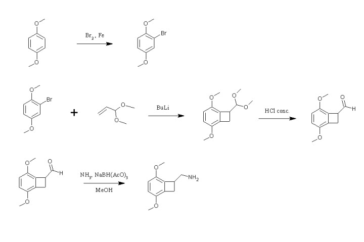

*Aminomethylbenzocycloalkanes *
Hello,
Sorry to dig up this old thread but I've just read it and i wonder if it can be possible to make the aminomethylbenzocycloalkane with bromo-p-dimethoxybenzene and acrolein dimethylacetal via aryne formation. What do you think about that ?
20.07.jpg - 24kB
