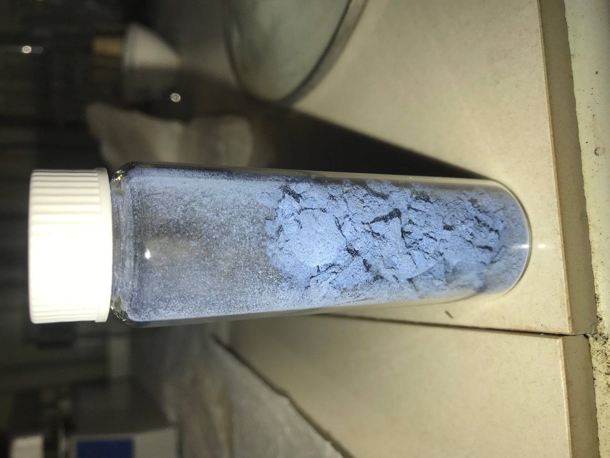

Report on making cobalt chloride CoCl2 anhydrous. My cobalt source is cobalt acetate - only because I got a reasonable quantity cheap! Seems that one
advantage of using cobalt acetate is that when acetic acid is a side product this is easy to boil out of solution. Cobalt chloride was made as
follows:
(CH3COO)2Co.4H2O + 2HCl = CoCl2 + 2CH3COOH + 4H2O
- 31g concentrated HCl added to a small beaker
- Slowly add cobalt acetate with stirring until a total of 30g added. This should have placed the HCl is excess.
- Leave stirring for a few hours. Very dark blue solution. Stop for evening, cover beaker with watch glass.
* Next day *
- Transfer very dark blue crystals and supernatant liquid to crucible and onto sand bath. Vinegar smell.
- Heat up on sand bath. Start to boil for while, with very strong vinegar fumes...had to open another door to get more draft through the shed. Boiling
at around 115C.
- Once getting near dry break up with nickel spatula while still being heated to prevent hard layers forming, easy to break up.
- Initially a dark blue mass. Now seems to be only steam coming off, vinegar smell much less.
- Color becoming lighter as it dries. See photo below showing the mix of some crystals still hydrated (the darker) and most already the final sky blue
color.
- Keep drying, check weight occasionally. Once all sky blue and weight seems constant (and close to the expected) dry for another 30 minutes and stop.
- Break into pieces small enough to go into the bottle and bottle while still very hot - compliments to whoever made these bottles, it did not crack!
- Final recovery was 15g, just half a gram or so less than the theoretical.
The leftover smears in the crucible quickly turned pink-red as it cooled down and started absorbing water. In the near future I want to try and make
the red hydrate.
Pictures of the hydrated salt below.

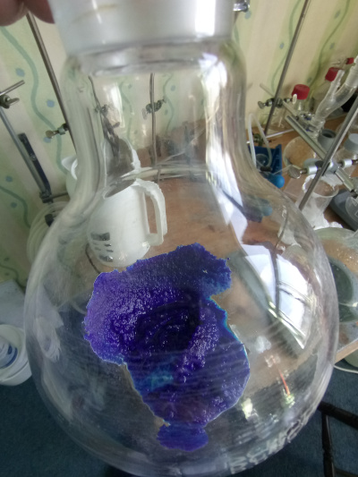

teodor
Posts: 1169
Registered: 28-6-2019
May be my experience of getting a lower hydrate of CoCl2 could be relevant to this thread.
As you know there are blue anhydrous CoCl2, CoCl2 * 9 H2O which is violet with red tint as well as some intermediate hydrates also with some distinct
colours (I can attach photos later).
As a method to low a water content I found this is working well: CoCl2 * 9H2O is mixed with calculated amount of tert-butyl alcohol (tert-butyl
alcohol forms azeotrope with water) and then the alcohol & water is distilled of. As I can see as a result CoCl2 has a greater affinity to water
but there is some intermediate hydrate which can be formed by this method. So, this way I produced very nice crystals of intermediate hydrates.

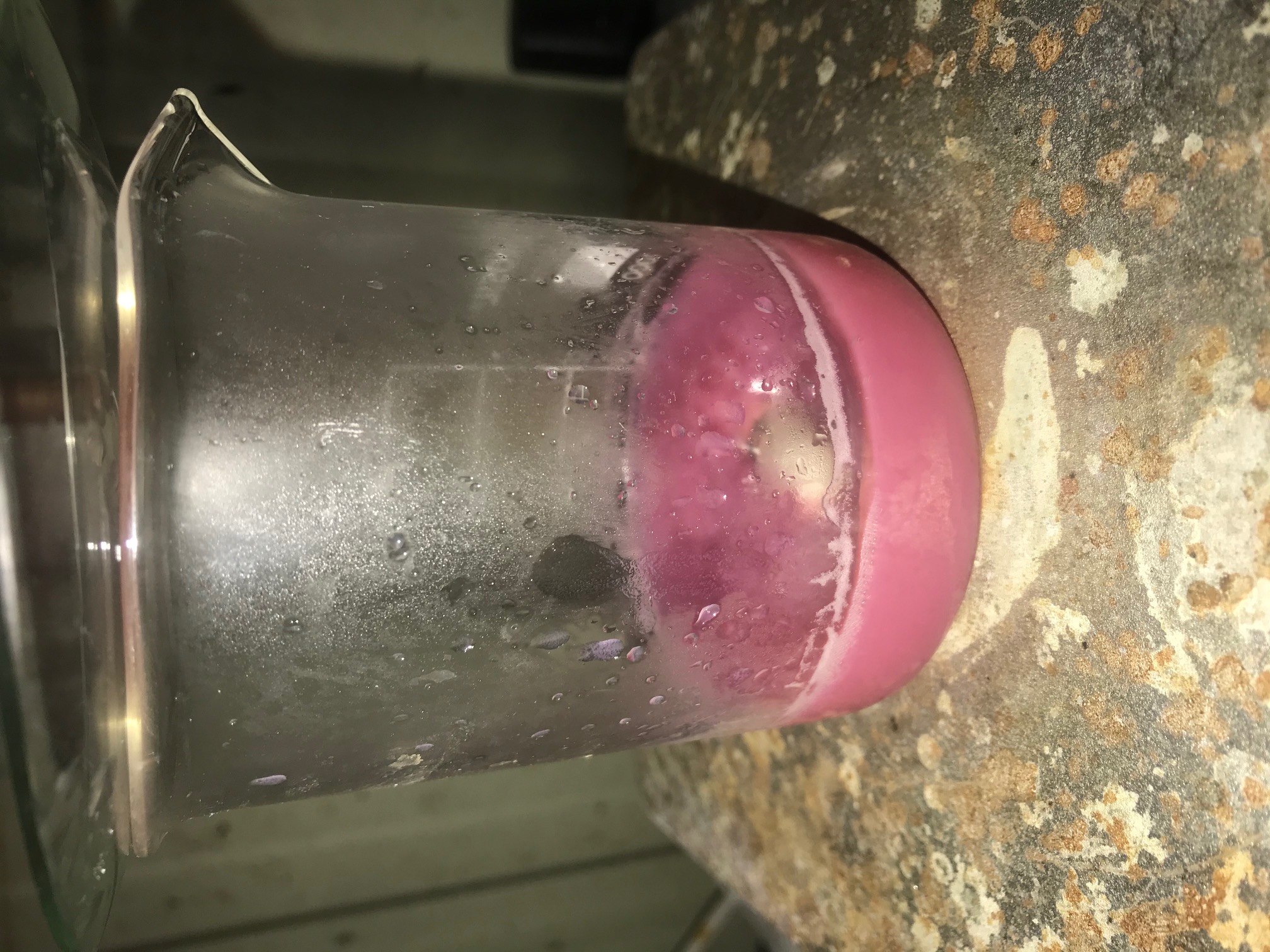

Bedlasky
Posts: 1253
Registered: 15-4-2019
Location: Period 5, group 6
Mood: Volatile
Are you sure about that? I never heard about nonahydrate. Just about hexahydrate (red solid which crystallize out from CoCl2 solutions at room
temperature), dihydrate (violet solid, observable intermmediate during dehydratation of hexahydrate) and anhydrous (blue solid).
Lion850: It is easier to precipitate basic cobalt carbonate from cobalt acetate solution and dissolve it in hydrochloric acid. Than just evaporate
water and dehydrate red hexahydrate.

Lion850
Posts: 517
Registered: 7-10-2019
Location: Australia
Mood: Great
Hi Bedlasky - I will try that. I am getting 500g basic cobalt carbonate; its waiting to be collected when I next go into town.
Teodor - I look forward to see the photos.

teodor
Posts: 1169
[Edited on 18-9-2020 by Bedlasky] |
Probably you are right. So, I've made probably CoCl2 * 2H2O from CoCl2 * 6H2O by this method. I didn't check the water contents, it was just an
experiment to check how the alcohol acts on the hexahydrate (in some old children book I have an experiment of destroying CoCl2 * 6H2O by acetone, so
I just was experimenting with this approach). Here are the photos:
[Edited on 23-9-2020 by teodor]
Lion850
Posts: 517
Location: Australia
Mood: Great
Nice colors Teodor. I tried to make the hexahydrate but ended up with a mix of colors.

Cobalt monosulphide CoS
A double displacement reaction was performed between sodium sulphide solution and cobalt sulphate solution. A black ppt was immediately obtained.
After some 30 minutes of stirring the solution was vacuum filtered, and the remainder washed with water in the funnel. During all of this there was
only the occasional hint of H2S smell. Photo of the wet remainder below.
The remainder was dried on a steam bath, the dry product is more brown. Photo below. There was no smell while it dried.
The product does not readily dissolved in hydrochloric acid, but it does dissolved in dilute nitric acid. However, there is hardly any bubbles when it
dissolves in nitric acid and no smell of H2S.
Textbook of inorganic chemistry vol 9-1 says that CoS does not always react with HCl but does dissolves in HNO3; and colors can be black or brown. So
I think there is a reasonable chance I ended up with CoS (or another sulphide) but I'm not 100% sure.

Cobalt sulphate & cobalt iso-butyrate
As a beginner in the cobalt chemistry I've made just some cobalt sulphate. I put a piece of cobalt metal in diluted H2SO4 and found this after 3 days.
I had attempt to crystallise cobalt iso-butyrate but it doesn't want to crystallise at all. But I must confess my starting compounds were not pure.

Very nice, the Cobalt Sulfate looks beautiful. Simple experiments are sometimes the best.

Very nice, the Cobalt Sulfate looks beautiful. Simple experiments are sometimes the best. |
Thank you very much. But I believe it was a first step only - also to check what people can do with that 15% H2SO4 we will have in EU. For the next
step I have some Ba2S2O6 (barium dithionate). I'd like to make some cobalt dithionate. Don't ask me why. I have no idea yet but want to do some
experiments with it.

Cobalt phosphate:
I first tried to dissolve cobalt carbonate in phosphoric acid (which worked so well with copper carbonate) but it became a sticky mess. I then tried a
double displacement reaction. The only soluble phosphate salt I had was potassium dihydrogen phosphate, KH2PO4.
- 15.7g of KH2PO4 dissolved in 70ml water, with some heat and magnetic stirring soon gave a clear solution.
- 14g cobalt acetate Co(CH3COO)2.4H2O dissolved in 40ml water, all dissolved into a dark red-purple solution.
- Add the cobalt acetate solution slowly to the potassium dihydrogen phosphate while stirring. Immediately got a lavender solution. Continued to stir
for 15 minutes. Photo below.
- Vacuum filter. Filtrate a very pale red. Rinse in funnel with 2 portions of water. Remainder a mix of lavender and darker purple, photo below.
- Leave on bench overnight. The next day the weight had reduced by 3g and the color was more uniform. Photo below.
- Dry on steam bath for many hours until weight stopped reducing: from 52g to final weight of 12.1g.
- Powdered in mortar, difficult as the product is quite hard.
- 11.8g dry lavender powder bottled.
Question: What is the correct equation for this reaction? Is it
2KH2PO4 + Co(CH3COO)2.4H2O = 2KCH3COO + Co(H2PO4)2 + 4H2O
but does Co(H2PO4)2 even exist?
Once other observation: cleaning the equipment afterwards showed the product dissolved easily in concentrated HCl giving a lovely blue solution, most
probably CoCl2.
Bedlasky
Posts: 1253
Mood: Volatile
Interesting result. I made dark violet to blue hydrated cobalt phosphate from K2HPO4 and CoCl2.2H2O. I also made lovely magenta NH4CoPO4.H2O from
NH4Cl, K2HPO4 and CoCl2.2H2O. Maybe you make some double phosphate? KH2PO4 forms more acidic solution, maybe thats why I made different phosphate from
K2HPO4.
Btw. Atomistry also mention CoHPO4, but they say nothing about colour.
