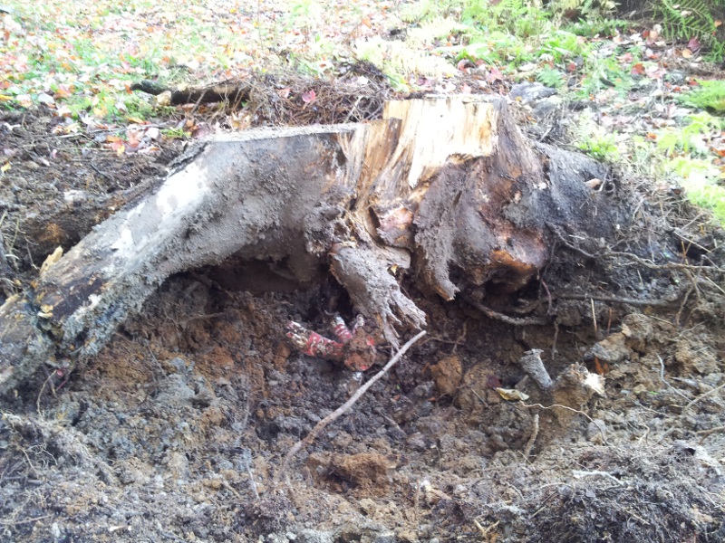

[*] posted on 27-10-2014 at 05:43
The stump pieces were in fact easily removed. A four wheel drive Toyota Tacoma was used to pull out the two remaining large pieces of the stump. Roots are similar to guy-wires; when there is only one guy-wire the wood is no longer well anchored to the ground and can be easily removed. Also the blast tends to heave the pieces at least a bit, removing tension from the guy-wires/roots, which also weakens the roots hold on the ground facilitating removal.
Stump Piece Removed 1.jpg - 307kB Stump Piece Removed 2.jpg - 300kB Stump Piece Removed 3.jpg - 292kB
