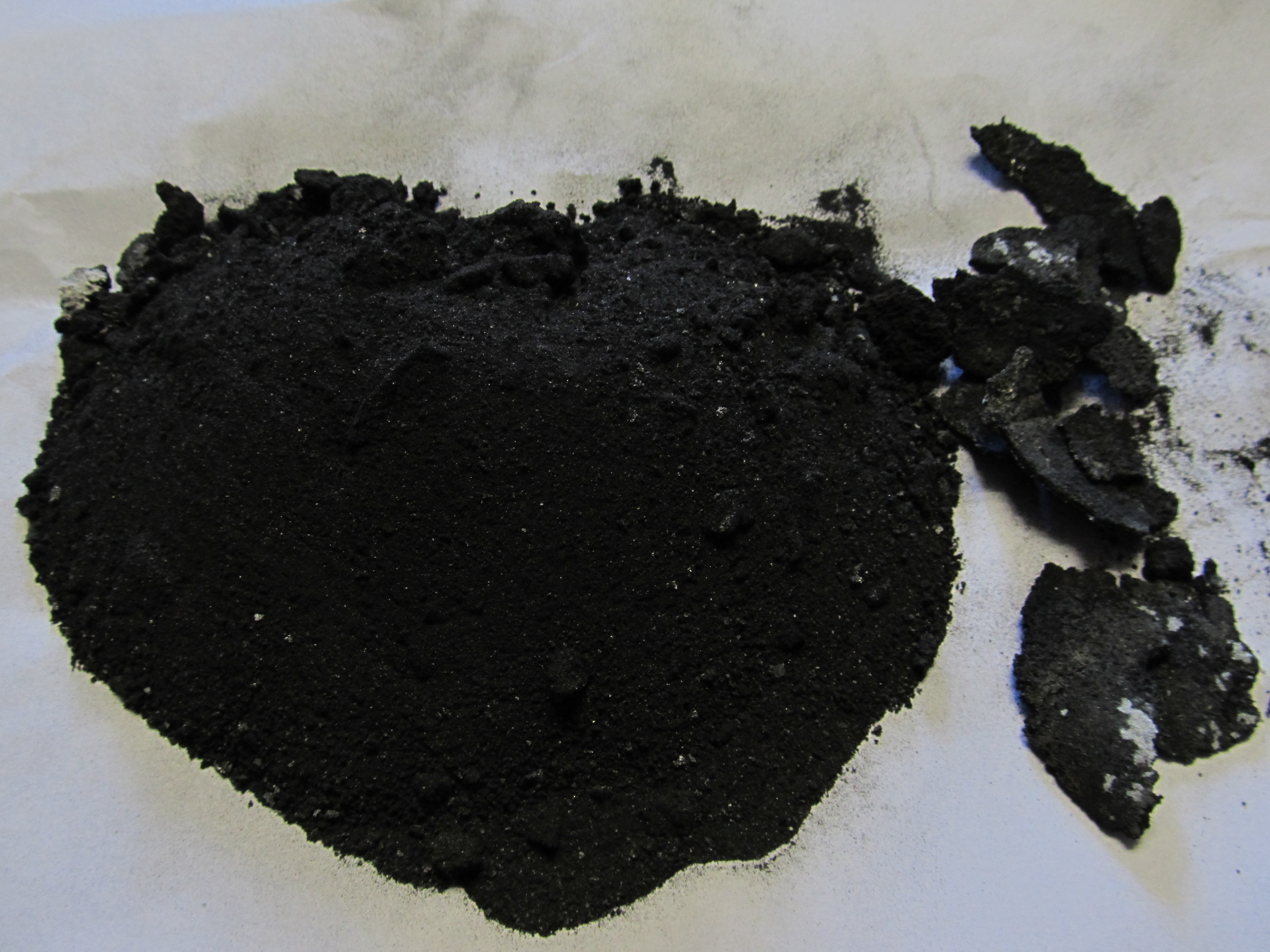

[*] posted on 19-12-2014 at 02:10
I made titanium ingot, Aluminum reacting with TiO2.
I was curious about the reaction of Magnesium with TiO2, unpressed.
Out of 300 g of a mixture (TiO2 + Mg 62:38) I have received 160 g of black powder.
The flame burned up to 1 to 1,5 meters.
Is it possible to extract titanium, from this powder ?
[Edited on 19-12-2014 by specialactivitieSK]
Al2.jpg - 62kBAl1.jpg - 78kBMg.JPG - 2.1MB
Tdep
Posts: 521
Registered: 31-1-2013
[*] posted on 19-12-2014 at 06:18
I believe that's a lower oxide of titanium. I would recommend re-doing the thermite with the black oxide to try and reduce it all the way to the metal

[*] posted on 19-12-2014 at 06:46
Yep, that's most likely titanium(III) oxide.
