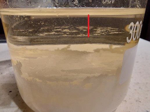

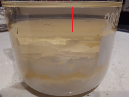

Tried the urea + bleach + MEK method on a half-molar scale with 750ml of 5% bleach ...
After the solution is cooled for an hour or so (it retains heat really really well!), MEK is added and stirred for about 3-4 hours.
Unlike what Doug's Lab said, my mixture didn't become cloudy, clear, then cloudy again (ketone -> hydrazone -> ketazine?); it stayed cloudy (and warm!) throughout.
Organic layer on top is separated, and 36% sulfuric acid is added.
White flaky ppt is formed almost immediately. An organic layer (MEK+ketazine?) floats on top of the aqueous/sulfuric acid layer (red line) ...
Will continue tmr and do a decantation/filtration to get an initial batch of hydrazine sulfate, then do a distillation with the filtrate to remove the MEK/water to get a second batch, fingers crossed.
What can I use to wash the hydrazine sulfate after filtration?

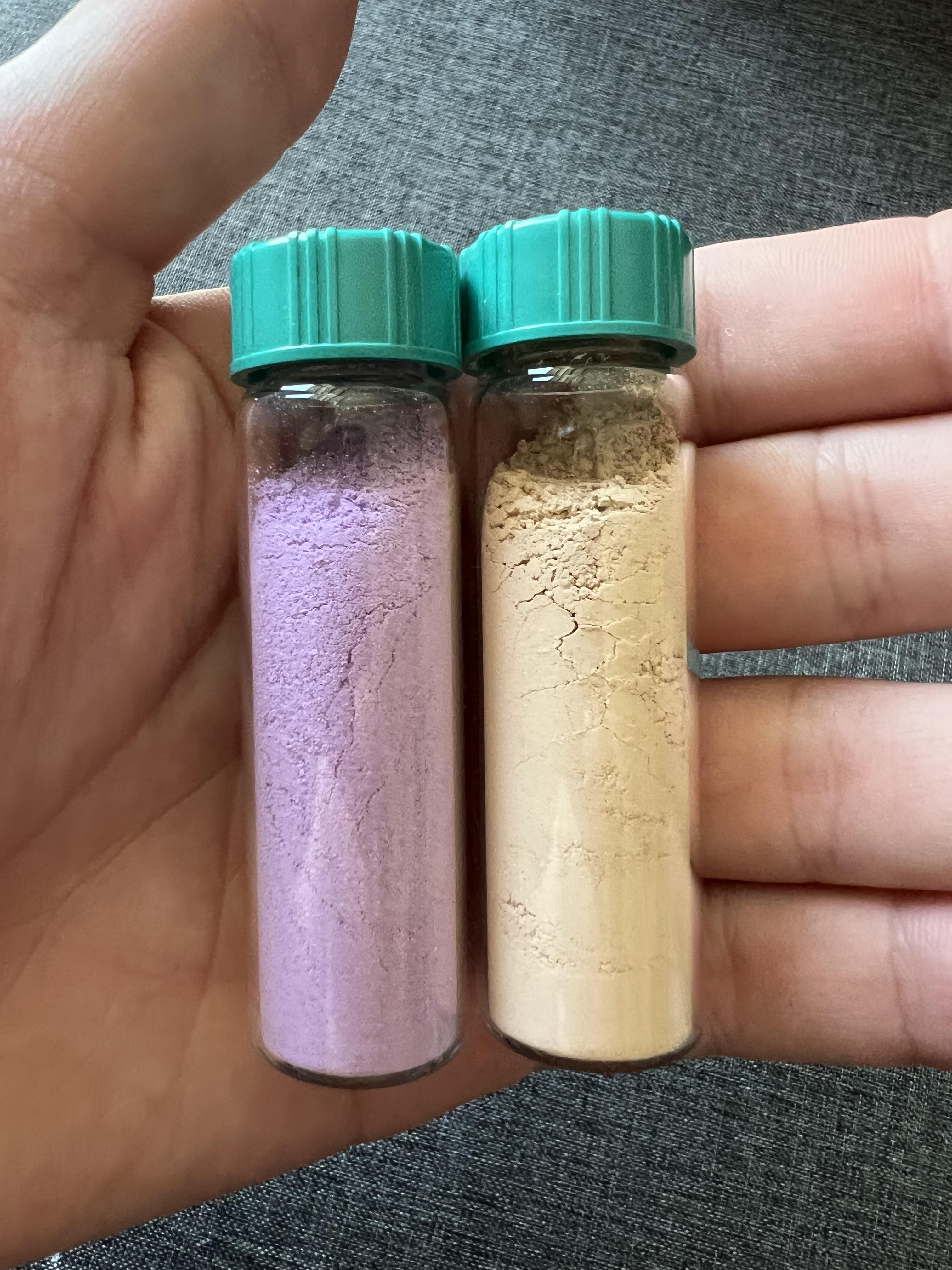

Nickel and cobalt hydrazine nitrates. Cobalt is a much better explosive material than nickel, but also unstable. two days later it became very weak because of decomposition.
