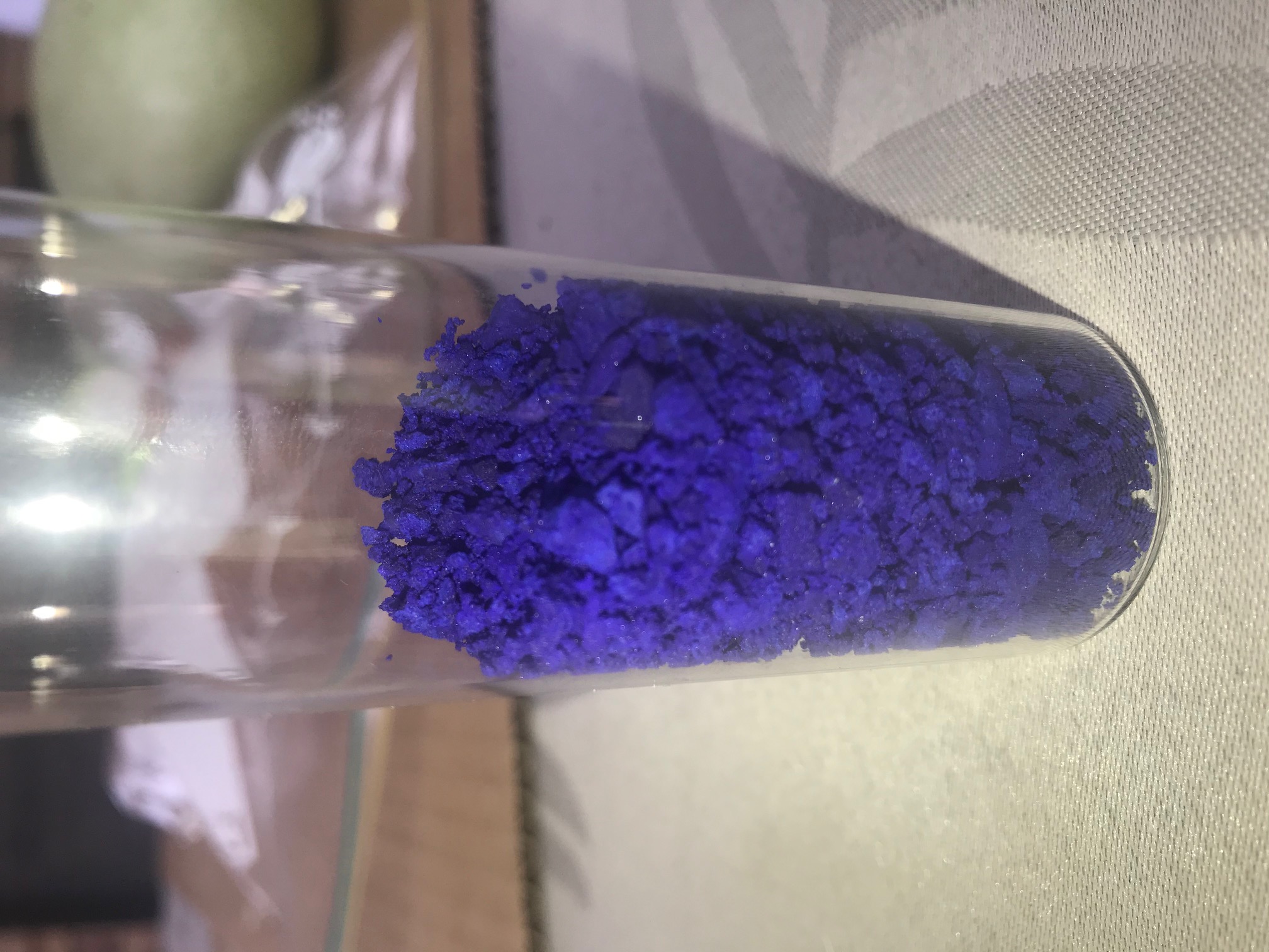

I recently made tetraamine copper (ii) sulphate:
- 20g CuSO4.5H2O in 65g water in a beaker, stir and heat a bit to get all dissolved
- Add 19g of 28% ammonia solution. A light blue suspension formed which quickly redissolved into a dark solution. Total solution volume just under 100ml.
- Continue stirring 15 minutes.
- Add 4 batches of 25ml 99% ethanol, total 100ml added.
- Dark bottom layer, clear top layer, some crystals on sides of beaker.
- Stir 5 minutes and then put aside for 5 hours.
- Blue solution with dark blue lower layer.
- Gravity filter and rinse with ethanol in funnel. Dark blue remainder, light blue filtrate.
- Press remainder dry between filter papers and paper towel
- Leave on bench overnight.
- Next morning: product has slight ammonia smell.
- Dry under a steel dish in hot sun for one hour.
- Bottled 18g of dark blue-purple crystals. Photo below.
Question: How much alcohol to add to force the crystals out of the (water) solution? I added an equal amount as the volume of the water solution as I had no clue. This seemed to have worked, but I dont know whether this was excess or maybe not enough.

Do you have a problem with it losing ammonia and changing color?
Is it blue or purple? I am trying to make a purple salt for my rainbow salts series :D

Hi Artemov it was made only 2 days ago, so far the color seems to stay the same. In an open dish there was a very slight ammonia smell, now that it in a sealed small bottle I will have to see what happens. I think it is more of a dark blue than a purple.

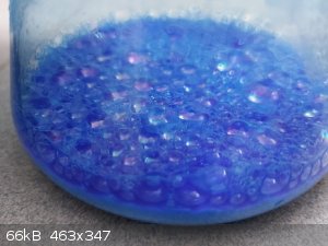

My synthesis of tetraamminecopper(II) sulfate -
Pic 1: 22.5g of CuSO4.5H2O (dissolved in 80g of H2O) and 35g of NH4HCO3 (23% molar excess).
Pic 2: NH4HCO3 is slowly added to CuSO4 solution, vigorous effervescence (CO2?) with thick light blue ppt. No smell of ammonia.
Pic 3: Solution turning a darker shade of blue as more NH4HCO3 is added.
Pic 4: Solution eventually turned deep dark blue with no ppt. Put on hot water bath to about 60-70 C to expel gases. Slight smell of ammonia near the end.
Pic 5: About 100ml of methanol added, cooled, filtered and washed with 50ml of cold methanol. Deep dark blue solid obtained, in drybox with CaCl2.
20201210_123256.jpg - 48kB 20201210_123514.jpg - 59kB 20201210_125653.jpg - 66kB 20201210_130316.jpg - 51kB 20201210_175655.jpg - 91kB
