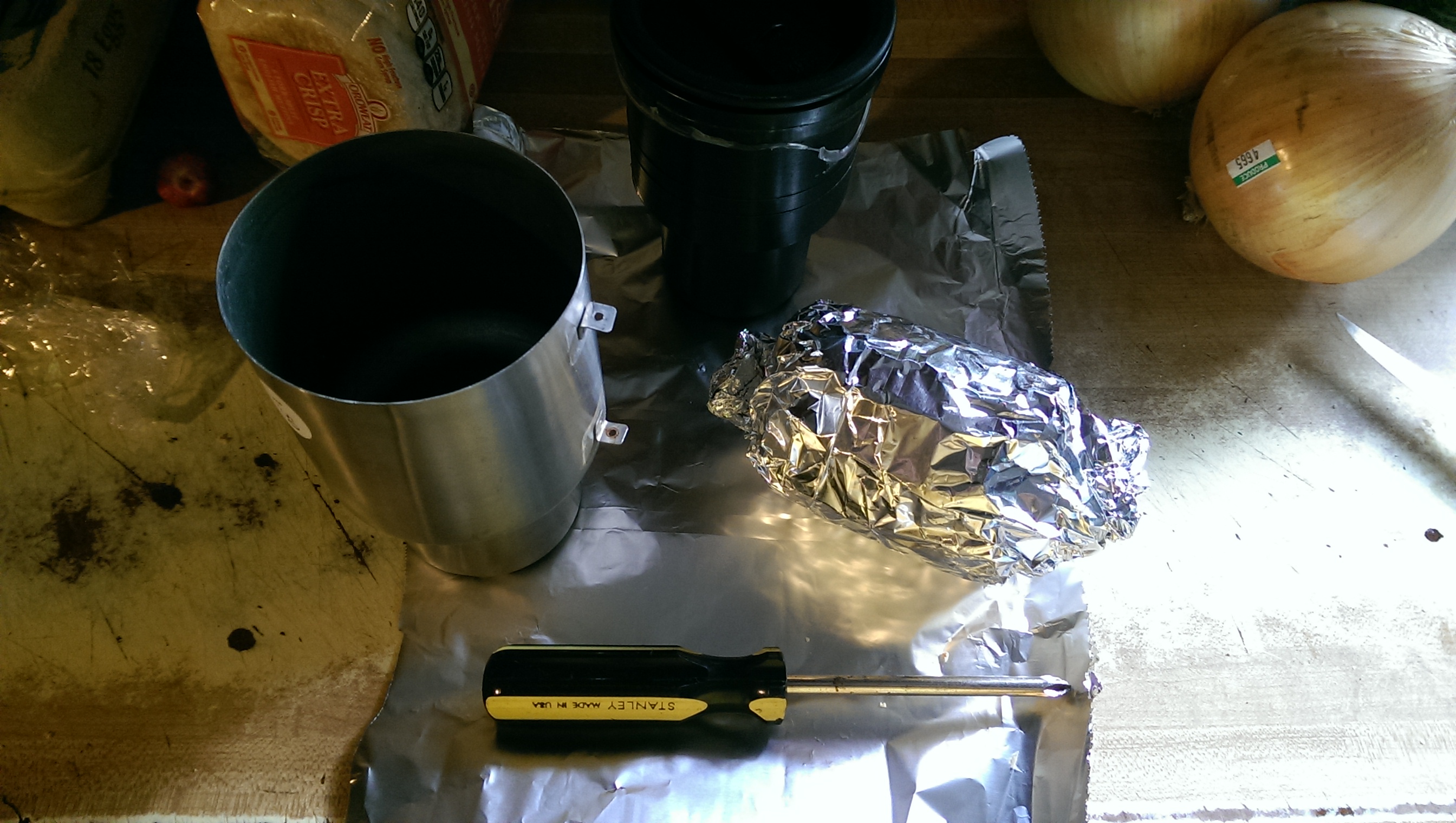

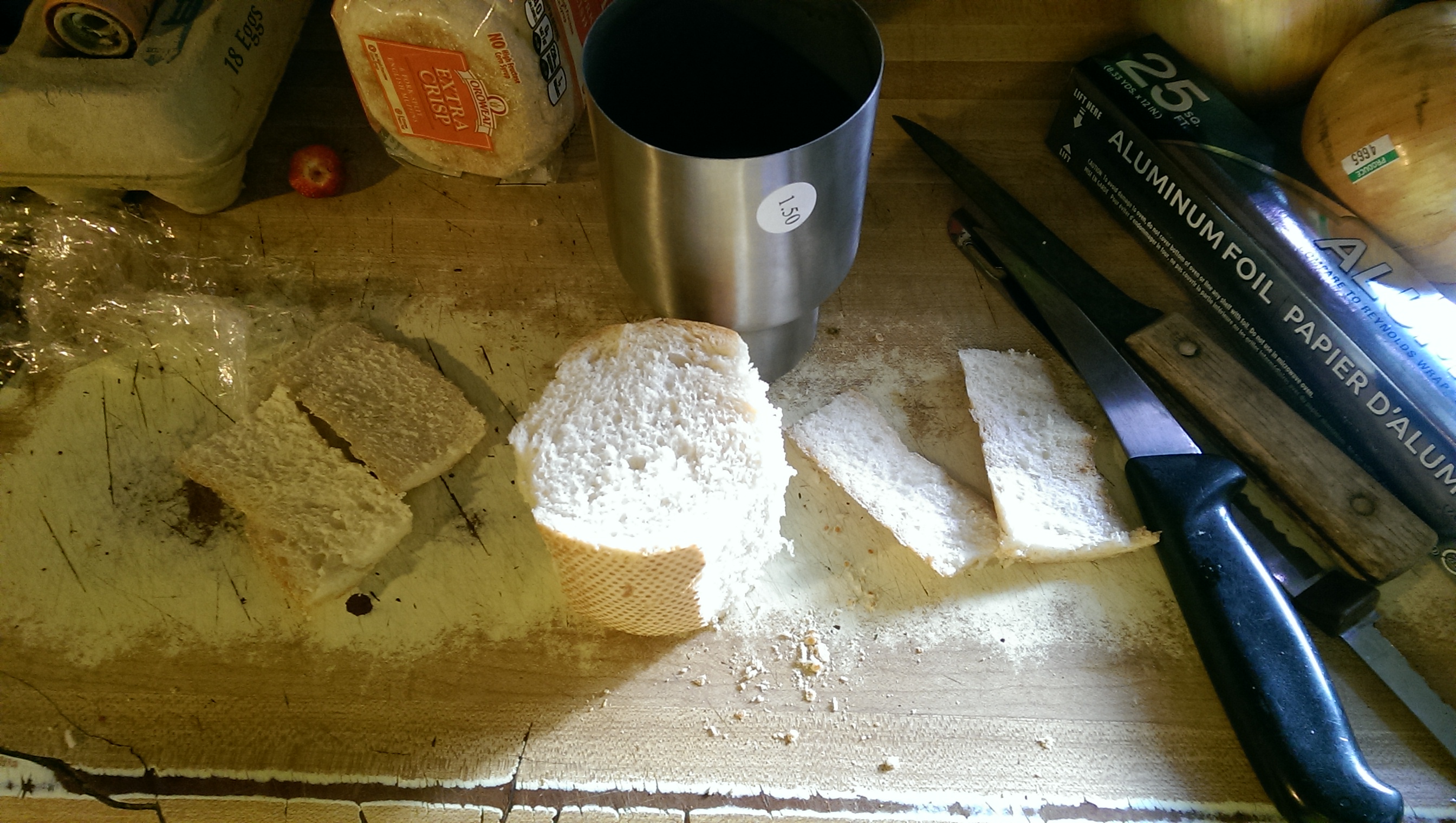

Got it to work. Took more care and a few bucks, $4.50. But a plastic insert stainles steel coffee cup from the thrift store was stripped to just the stainless shell. Safeway bakery -european french bread, cut to size, wrapped in dollar store Al foil and ends twisted, put in ss cup shell, Al foil over top, aluminum cat food can( free) covering top but fits just inside the ss shell, then the top covered in a couple pieces of foil. Put in wood stove used for heating a home. 1/2 hr leaning on few coals- rotated on 15 min, another 1/2 hr in warmer parts, repeat for a total of 2.5hr with final half hour cup glowing red on one side in a the hottest part of coals.
IMAG8107.jpg - 1.2MB IMAG8109.jpg - 997kB
IMAG8133.jpg - 1.3MB IMAG8136.jpg - 1.1MB
IMAG8138.jpg - 1.1MB
It now clinks when jarred and feels sturdy. Tomorrow I'll cut it up a bit to hopefully make some test squares. Try some soak in and reheat additives to increase conductivity or something. Hate to set up Ni bath and clean it up if there isnt enough conductivity to strike something on. Well, there ya go, did some toast burning. No scale to calculate loss on charring.
