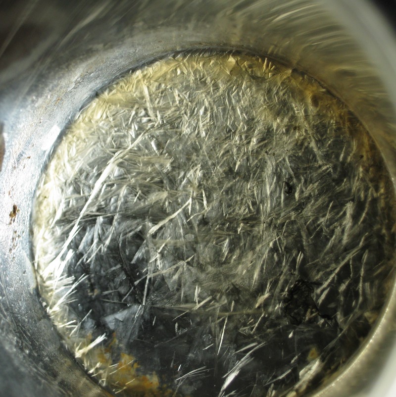

I started with (NaPO3)6 and did
a) (NaPO3)6 + 3CaCl2 --> Ca3(PO3)6 + 6NaCl
b) Ca3(PO3)6 + 3H2SO4 --> 3CaSO4 + 6HPO3
Ca3(PO3)6 is a funny substance. It's a sticky mess. Doesn't look like an ordinary salt at all (I guess these P compoounds are some kind of polymer?)
I concentrated the HPO3 solution by heating. When it cooled down, I got a mass of crystals. See picture.
In theory that stuff is rather pure HPO3, but I'm not 100% sure.
The color of the retort was kind of orange, but not too bright.

True that. Unfortunately, there was already air in the tube before the reaction, so it's not out of the question. Also, the hydrogen and carbon monoxide would have diffused into the air in the tube, so you'd likely get an unholy mix of the three.
I'm assuming you didn't distill off the phosphoric acid, which is normally clear crystals. Try a recrystallization if you're not sure about the purity.

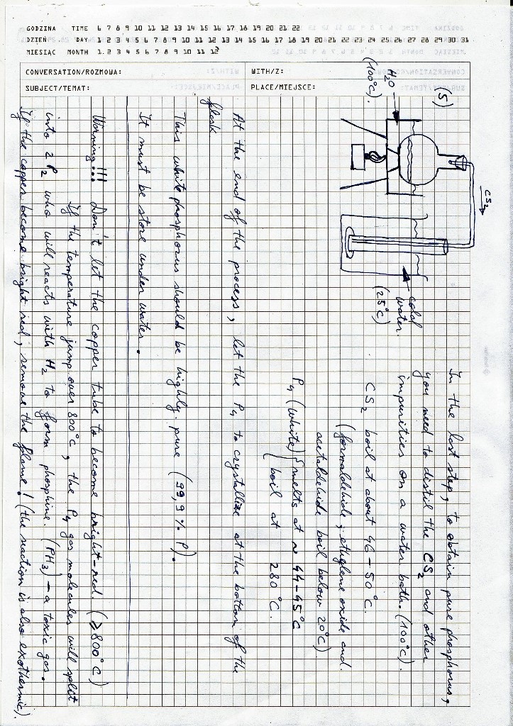

I found some papers (written by me), where I noted several experiments that I made in the past summer (or I intend to make).
I think that...these informations will be helpful:
sg0000.jpg - 359kB sg0001.jpg - 345kB sg0002.jpg - 331kB

I think I forgot to tell you something :) :
All operations involving white phosphorus should be conducted in the absence of light (especially short wavelength light) because white phosphorus can turn into red phosphorus, which is much less reactive.
...P4 molecule is freaking annoying :mad:

Thats a pretty spiffy looking setup idea there ZET, carbon disulfide seems kind of exotic to me though is it necessary for capturing the phosphorus or could you eliminate it and try to just condense the phosphorus in cold water if you're willing to live with some impurities?
I've been wanting to be able to get ahold of phosphorus for some time but haven't bothered with all the attention it gets from the DEA and lack of need that I have for it but this method would be perfect for me if its really that simple!

Problem is, that conversion to RP is actually very slow - only the surface is converted, if I recall. So, light is fine.
Doc ZET, is this an experiment you did or one you plan to do? The theory looks fine from a surface glance.

Hmmm...I think it should also work with carbon tetrachloride/chloroform/benzene/toluene (this solvents can easily dissolve white phosphorus) but be careful with first two solvents (because, phosgene can be formed in the CO+H2 output flame).
Also you can try to collect P4 vapors in cold water, then boil the water and release the white waxy phosphorus sample into the flask. I'm not sure that it will work , unless I don't try this method yet. (there can be traces of H3PO4 and other phosphorous acids in water, but not in CS2 or other nonpolar solvents)
And yes, I did this experiment (on a small scale). I have got only 2-3 grams of phosphorus ... but my goal was not to obtain phosphorus.
Guess who was my source of phosphoric acid? >>> Answer is seven bottles of Coca-Cola. :)
First, I boiled all of the juice for 2 minutes (to destroy the carbonic acid), then added 30 grams of Ca (OH) 2 to precipitate calcium phosphate.
Then I added calcium phosphate in concentrated sulfuric acid, I distilled the mixture and voila! A few grams of almost pure phosphoric acid from Cola! (almost dry).
My goal was to determine experimentally how much phosphorus is in Coca-Cola. ;)
To be sure, use acetylene instead of ethylene, but be careful! Acetylene can ignite/explode in the presence of an oxygen source (like NO2, N2O3, CuO, SnO2, PbO, H2O2 ,ClO2 ,HClO2 and, why not H3PO4 ) at that temperatures (600*C).

As I said (in the pages), the reaction between ethene and phosphoric acid at 600 * C in the the presence of CuO is exothermic, and if you try to scale up to much, you can get it out of control and produce phosphine, a toxic gas (smells like garlic when burned).
About the phosphoric acid in Cola...I don't remember the exact concentration...but I remember that if you add enough Ca(OH)2 in the boiled juice, the solution will turn basic and the calcium phosphate will start to decant at the bottom of the pot (along with the excess of Ca(OH)2 ).
Then collect the CaHPO4+Ca3(PO4)2+Ca(OH)2, remove the water from the mixture by heating it, and add the mixture to some fuming sulphuric acid (not to much, but a little excess).
After it reacts, you can distill almost pure phosphoric acid.
(CaHPO4 represent actualy some hidroxyapatite formed in the acid water solution, while the H3PO4 reacts with Ca(OH)2 )

Wow, don't everybody try to answer at once. Anyway, I've just found a very interesting document: US Patent 6207024 (accessible through www.uspto.gov) describes the production of elemental phosphorus from pyrolytic carbon and phosphoric acid, using microwaves to heat the reactants. The reaction takes place at much lower temperatures than the conventional arc furnace process. The problem (or problems), of course, is that the phosphorus still needs to be protected from oxidation, you need a relatively heat-resistant and microwave-transparent reaction vessel, and it's going to be tough to condense and collect the phosphorus if you're trying to come up with something using a domestic microwave oven. Microwave ovens are cheap at thrift stores, but there are still obstacles to overcome for performing this reaction at home...
