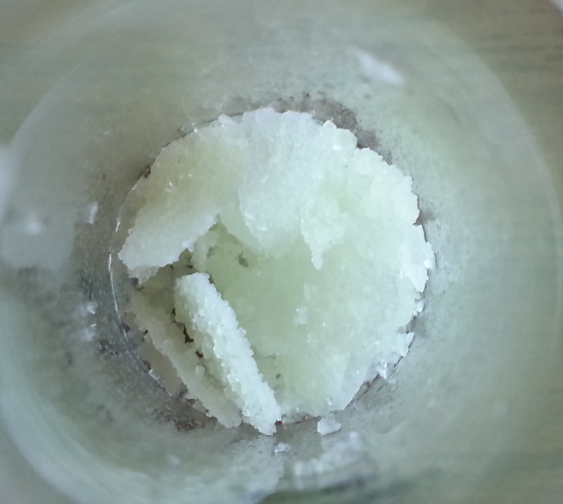

I checked on my beaker this morning and a mass precipitation occured! I think the solution was supersaturated and needed something to set it off. Some of the precipitate was collected, dried, and stored in a vial. A test with a UV source shows that it fluoresces! The sample exhibits a mint green color, likely due to fluorescence. As expected, the color is enhanced in sunlight. Some of the crystals were cubic, so likely KCl precipitated out as well.
A test was done, which involved adding ammonia to a few crystals of the potassium terbium sulfate. The crystals turned to a white powder. On acidification with HCl the powder dissolved (and a cloud of ammonium chloride was formed). This shows that terbium hydroxide precipitated in the ammonia.
I've only got one problem now: the crystals I collected weren't completely dry, so there's a bit of HCl in them. What is the best way to remove it?

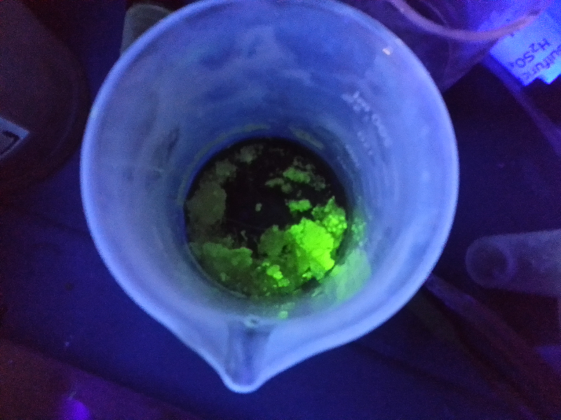

I took a picture of the solution under a black light (with the precipitate) and it appears to glow green. I don't know whether it is due to the solution or the precipitate. I'll try to figure that out soon.
crystals.png - 762kB fluorescent solution.png - 581kB

These should UV fluoresce in the dark like mad. They may also look slightly different under incandescent light (low UV) and saver bulb light (quite a bit of UV), see also Neodymium.
[Edited on 18-1-2014 by blogfast25]
Ok then, something isn't entirely right.
I believe a true alum may not have formed. The sample is only very weakly fluorescent. However, I did get a similar result with the Fe-contaminated TbCl3 (almost zero fluorescence). It appears the presence of other metal cations (and possibly even water) interferes with the fluorescence of terbium (likely due to UV absorption). I don't have incandescent lights in my house, but CFL lights and sunlight show the same mint green.
I left the vial open overnight and the compound dried up. It doesn't seem to be very hygroscopic.

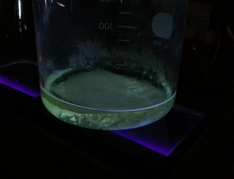

I decided to check the mother liquor for fluorescence.
Green Fluorescence.png - 1.1MB
Now that's what I'm talking about! But now I'm reluctant to destroy the crystals for Tb(OH)3...
The failure of my other batch of double sulfate to fluoresce was due to the UV compact fluorescent not actually emitting any UV radiation (test was done with my highly fluorescent T-shirt).
On a side note, my terbium crystals match my T-shirt now.

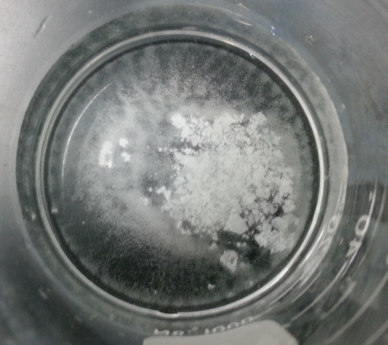

I made some terbium hydroxide by adding the first batch of double sulfate to ammonia. A white, sandy precipitate formed at the bottom of the beaker. It does not fluoresce with the good lamp. I'll try to convert it to TbCl3 and then hexakis(antipyrine)terbium chloride to see if there's increased fluorescence, as antipyrine is expected to act as a chromophore. Hopefully I can make a fluorescent solution soon.
Here's the terbium hydroxide precipitate:
terbium hydroxide.png - 1MB
[edit] Is it necessary to separate the glowing flakes from the dead ones?

[*] posted on 23-1-2014 at 05:42
The green fluorescing stuff is the double sulphate?
[Edited on 23-1-2014 by Brain&Force]
Not sure what you mean. I see some finer and some coarser material but nothing that glows?
[Edited on 23-1-2014 by blogfast25]

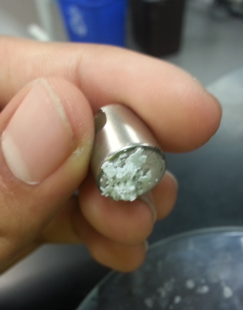

dry product.png - 682kB magnetic sulfate.png - 1.3MB

Ferric ions most definitely kill the Tb fluorescence. I made another batch of double sulfate and when it came out, they were yellowish. Rinsing with water removed the Fe and the powder immediately became fluorescent. I wonder if this is true with other transition metals as well.
Also, I looked at the emission spectrum of Tb fluorescence, and, as expected, it matches that of tube and CFL lighting. I'll try to get wavelength measurements, and hopefully images with the available diffraction grating.
