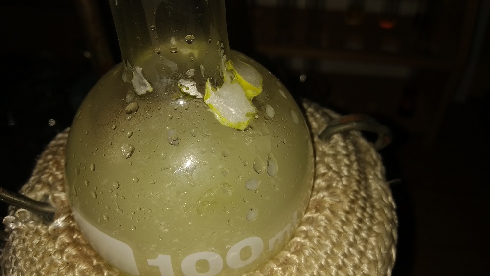

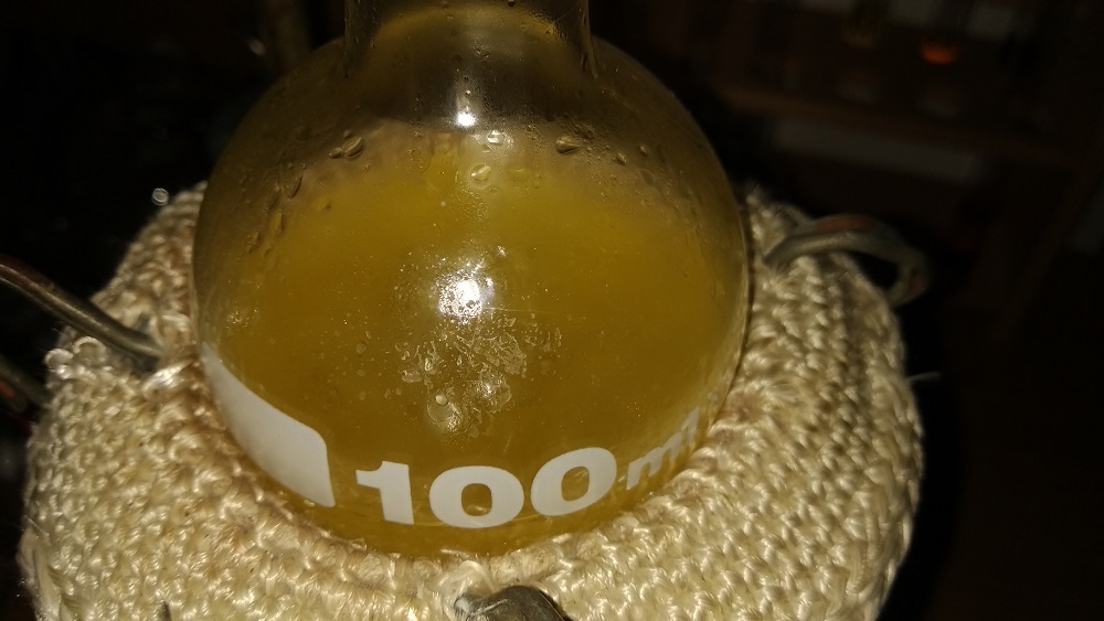

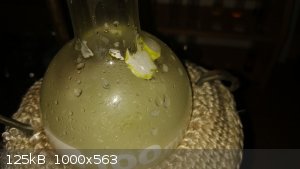

OK, I tried this and got a spectacularly shitty yield.
Lab notes start:
32.8 g (0.15 mol) of solid calcium hypochlorite (pool chlorinating agent, 65% available chlorine) were placed in a 300 ml Erlenmeyer flask. 10.8 g (0.1 mol) of benzyl alcohol ("puriss. p. a." but giving off a very slight smell of benzaldehyde) were mixed with about 150 ml of DCM. This mixture was added to the solids. 1.7 g of commercial TBAB were added, followed by a few ml of water. The water floated on top, forming a layer of about 3 mm width; the solutions were clear and colorless with the solids sitting at the bottom.
When magnetic stirring was turned on the mixture instantly turned yellow. A reflux condenser was fitted and the reaction mix was refluxed for one hour. Towards the end of the reaction chlorine gas could be smelled at the open end of the condenser.

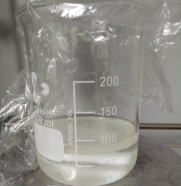

The milky, slightly yellow suspension was cooled with a water bath and allowed to settle. The precipitate looked very fine and difficult to filter. A separate aqueous layer could not be observed.
After half an hour it became obvious that waiting for the solids to settle would last too long. The mixture was filtered using a glass fritte and a layer of celite. Along with the fine precipitate some granules of unreacted hypochlorite could be seen. The filtrate was a greenish-yellow liquid smelling of DCM, chlorine and benzaldehyde. A spatula of sodium metabisulfite was added and shaken vigorously but nothing happened. As an experiment some sodium thiosulfate was added as well with no result. A few ml of water were then added, followed my more thiosulfate. On shaking the mixture turned brown. Adding more metabisulfite and heavy swirling eventually caused it to turn almost colorless.
The organic phase was isolated using a separatory funnel and dried using Na2SO4. The solvent was then rotovapped off, leaving behind about 10.5 g of a deep yellow oil that smelled of benzaldehyde.

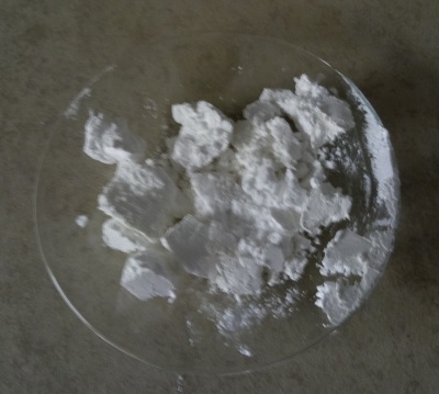

Lab notes start:
11 g (0.1 mol) of benzyl alcohol were mixed with 50 ml of ethyl acetate in a 300 ml beaker. 3.2 g (0.01 mol) of TBAB were added and dissolved with magnetic stirring. 100 ml of fresh supermarket bleach (2.8% sodium hypochlorite) were added. The mixture turned greenish-yellow. It was covered with a watch glass and vigorously stirred for one hour at room temperature (18.5 °C).
The upper organic phase was separated and the aqueous phase extracted with 2 x 50 ml of EtOAc. 11.45 g of NaHCO3 were dissolved in about 140 ml of water (pH = 8.3). The organic phase was once washed with 30 ml of this solution (which was probably unnecessary as the aqueous phase had a pH of 10.5, so any acid formed would have been in this solution anyway). The organic phase was then washed with brine and the EtOAc rotovapped off. The crude product, a yellow liquid, smelled like benzaldehyde and weighed 14.77 g.
The bisulfite adduct procedure was then done according to the instructions of Eleusis:
20 g (0.105 mol) of Na2S2O5 were dissolved in the minimum amount of water (about 30 ml). 25 ml of 96% EtOH were added. The turbidity was dissolved by adding a little more water. The total volume of the solution was about 80 ml. The crude benzaldehyde (without further drying) was slowly added to the bisulfite solution which became turbid. This time it was stirred for longer time. After two hours there was still not very much precipitate. A little (400 mg) of TBAB was added as recommended by https://www.sciencemadness.org/whisper/viewthread.php?tid=61... but there was no appreciable effect after a few minutes. The formed precipitate was filtered off and stirring was continued for six hours in total. No additional precipitate had formed. After standing for some time a separate layer formed on top, presumably benzyl alcohol/EtOAc (see image).
The filtered-off substance was washed with EtOAc and air-dried. The yield was 2.02 g of adduct (211.19 g/mol) = 9.6 mmol (9.6 % of the theoretical).
Lab notes end.
It seems that the hypochlorite oxidation doesn't work for me (as advertised, at least). Then again, I tried the persulfate method some time ago without getting too great of a yield either so perhaps it's just my bad luck with this reaction. Anyhow, I have enough adduct to make my experiments now. Should I find a way that works well (for me) I'll post it here.
Attachment: Selective Synthesis of Benzaldehydes.pdf (372kB)
This file has been downloaded 734 times
Benzyl_alcohol_layer.png - 153kB

[*] posted on 18-3-2020 at 09:07
In order to achieve selectivity in this oxidation you need to reduce the proportion of benzaldehyde that exists in the aqueous phase vs. the organic phase. Using a smaller volume of water naturally limits this. Also, EtOAc mixes with water much more than benzene, so it may allow more phase mixing than you actually want in this reaction.
I would suggest using a more hydrophobic solvent for the organic phase, like toluene or DCM, and a smaller amount of water.
RadicallyStabilized
Posts: 35
Registered: 3-10-2018
[*] posted on 18-3-2020 at 09:31
OK, thank you, clearly_not_atara.
Please see my post from 2020-3-10 where I used DCM and very little water and still got only about 24%. Do you have an idea what might have gone wrong?
Everyday consciousness classifies and subordinates, coerces under patterns of easy manipulation and disregards the essential.
Posts: 2928
[*] posted on 18-3-2020 at 14:02
Frankly I'm not sure; where I've seen this reaction before it's used for sensitive substrates and extensive precautions are taken.
But I do notice two things:
- TBAHS is an acid, TBAB is not. Small amounts of protons significantly increase the reactivity of hypochlorites. As such the rxn may have been too slow and the conversion incomplete.
- You noted in your post on 10 March that you used more water than the original procedure recommended. Have you forgotten this?
[Edited on 18-3-2020 by clearly_not_atara]
RadicallyStabilized
Posts: 35
[*] posted on 19-3-2020 at 00:09
No, I haven't forgotten, but the amount of water in my first try was much less than what was used in the sodium hypochlorite oxidation (by a factor of 20 or more). And after the reaction the water layer was gone anyway. I don't know how the calcium hypochlorite is supposed to dissolve under these conditions. There needs to be a water phase for the TBA* to work, doesn't it?
The bleach I used has a pH of about 10.5. I'm not sure whether a relatively small amount of TBAHS would be able to significantly change this.
Do you think it would make sense to buffer the solution to be slightly acidic (ph = 6 or so)?

[*] posted on 7-2-2021 at 02:15
Below you'll find my notes on the oxidation of benzyl alcohol to benzaldehyde with 10 % H2O2 and a quaternary ammonium octamolybdate catalyst, as per Green Chem. 9 (5), 421–423. DOI: 10.1039/B700534B (see attachment). I opted to go with DDAC instead of making the butylpyridine bromide for the catalyst used in the paper, since it's cheap and readily available to the amateur.
Preparation of the catalyst (didecyldimethylammonium octamolybdate)
Bardac 22 (50 % DDAC, 14.50 g, 20 mmol, 1 eq.) and 75 mL water were place in a 250 mL Erlenmeyer flask and heated to 70–72 °C under stirring. A solution of sodium molybdate dihydrate (9.70 g, 40 mmol, 2 eq.) in 40 mL water, to which aq. HCl (37 %, 5.90 g, 60 mmol, 3 eq.) had been added, was poured into an addition funnel and dripped into the stirred DDAC solution at approx. 1 drop per 1–3 s, whereupon a colorless precipitate immediately formed. When the addition was complete the mixture was stirred for a further 20 min before cooling to room temperature. The resulting colorless solid was vacuum filtered and washed with a small amount of water. Filtration was difficult due to the product turning into a thick paste on the filter as water was removed.
Don't have a yield yet as it's still drying in the desiccator, but the wet catalyst can also be used, as below. In a previous attempt I was a bit sloppy, temperature was in the 60s °C, the molybdate solution was added via pipette at a much higher rate and I ended up with an extremely fine precipitate that was nearly impossible to filter. In that attempt I also used a great excess of DDAC as in the ref, which likely contributed to the difficulties and just seemed unnecessary. Also note that the molybdate solution will not mix with the DDAC unless the latter is sufficiently diluted. Fun fact: At 2490 g/mol the catalyst (DDAC)4Mo8O26 is the heaviest substance I've ever made!
Oxidation of benzyl alcohol to benzaldehyde
To wet didecyldimethylammonium octamolybdate (0.70 g, 0.3 mmol, 0.3 mol%) in a 100 mL round-bottom flask fitted with a condenser were added benzyl alcohol (10.80 g, 100 mmol, 1 eq.) and hydrogen peroxide (10 %, 35.40 g, 104 mmol, 1.04 eq.), and the mixture heated to reflux under stirring. The catalyst turned yellow, dissolved into the organic phase and darkened over the course of the reaction, while a change to green indicated the hydrogen peroxide had been consumed after 45 min. After cooling the apparatus was set up for distillation, and the product collected alongside water over a range of 96–98 °C, while the residue in the pot took on a deep blue color and was kept for a second run. The water was removed from the distillate via pipette, the crude product dried over MgSO4, gravity filtered through a pipette plugged with cotton and stored in the refrigerator under argon. Yield of crude benzaldehyde: 6.80 g (64 % of theoretical 10.61 g).
A significant amount of benzaldehyde likely remained in the sump and some was also lost during the removal of the cloudy water layer from the product in the final step. I'm currently performing a second run with the recycled catalyst and will combine the crude products before purification.
Attachment: Ming-Lin, Hui-Zhen 2007 - Selective oxidation of benzyl alcohol.pdf (280kB)
This file has been downloaded 875 times
IMG_20210206_201601.jpg - 125kB IMG_20210206_204636.jpg - 137kB IMG_20210207_090919.jpg - 172kB

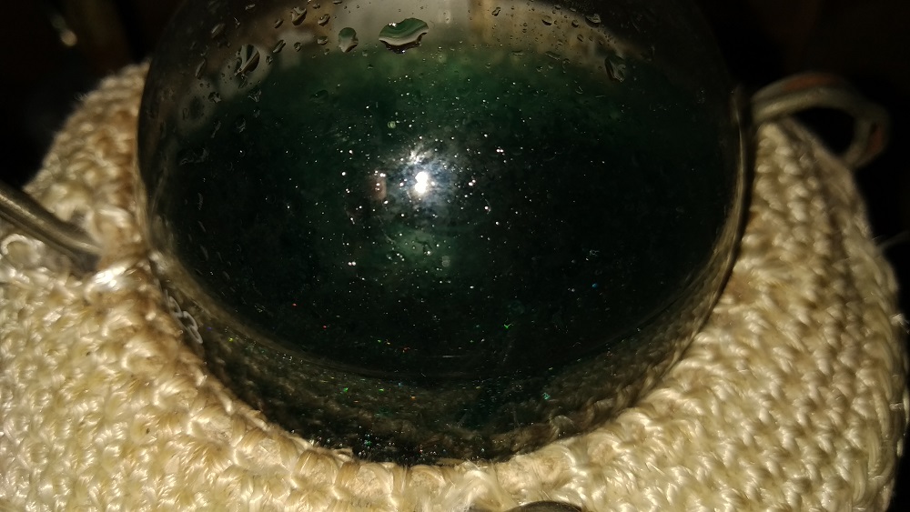

Edit: So I performed the reaction again in the same RBF including the residue from the distillation and without adding fresh catalyst. However, I increased the amount of benzyl alcohol by 33 % (14.35 g, 133 mmol, 1 eq.) and used 1.2 eq. of H2O2 (10 %, 54.30 g, 160 mmol), leading to a reaction time of 4 h. After distillation the water was removed in a separatory funnel. Everything else was performed exactly as above, yielding 10.50 g (74 % of theoretical 14.11 g) of crude benzaldehyde.
A significant amount of dark green/blue oil remained in the sump after distillation, which solidified fairly quickly upon cooling. Guess this will mostly be benzoic acid.
I didn't bother with extracting the aqeous layer in the sep funnel, but I'll likely do that when I scale the reaction up.
So far I like this reaction. Aside from the messy filtration of the catalyst I can't think of a way to screw this up. All the reagents are easily accessible and cheap as well. I'll see if I can clean up the catalyst for future batches, but I might just save it as is.
