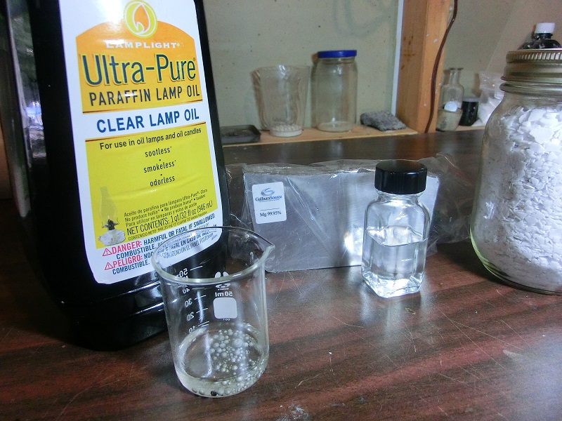

I have been following this thread from the begging and have been wanting to give a go at this reaction ever since. Well, I finally got all of the reagents together and today I have become the newest member to grow balls of potassium. :D
After 3 weekends and about 8 different runs I was getting pretty disheartened, but with patience and perseverance I was able to get those balls.
Here is a picture of the reagents I used.
CIMG1679.jpg - 212kB
The beaker contains the larger potassium balls that I was able to pick out with tweezers.
I made magnesium fillings by taking a rasp to the Mg ingot seen in the picture.
The KOH was used as is, in flake form
The recipe was 2 grams of Mg, 5 grams of KOH, 1ml of T-butanol, 30 ml of paraffin oil. All this was added in the begging in the so called one-pot method.
Potassium balls were seen in the reaction mixture about 30min after the temperature of the sand bath reached 220 C. The 50 ml flask was swirled about every 20 - 30 minutes.

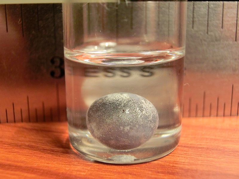

The collected balls were coalesced under heavier paraffin oil (Carolina science supply) into one large sphere. Pictured below. The fines were used to create a nice pyrotechnical show.
CIMG1683.jpg - 165kB
I would like to thank everyone who has contributed to this thread, this is an awesome synthesis that requires much patience.

I just want to mention that before having a successful run I attempted using various magnesium sources and solvents.
In the first attempts, I used magnesium that I got by drilling into a piece of magnesium alloy that was scavenged from a car's steering column. No potassium was formed during these runs.
Next I went out and bought a Coleman magnesium fire starter. I made several runs using this piece. I tried using drill shavings first with no success. I then decided to use a rough file to make finer particles. In one of these runs I believe some potassium was made because upon disposal of the reaction mixture into isopropanol the alcohol caught fire, but there were no visible shiny balls.
I finally decided to invest in some magnesium from gallium source seeing that I spent way to much on that fire starter for nothing.
The first attempt using the gallium source magnesium was done by adding the t-butanol mixed with solvent a little at a time, using a hypodermic needle through the rubber stopper, no visible potassium was seen to form in this run, but there was much fizzing and flame when the reaction sand was poured into isopropanol.
The very next run was done exactly the same way as above except that all of the reagents were introduced at the beginning and the flask was not opened until it cooled down.
I plan on trying to use larger particle size of the purer magnesium and see if that still yields potassium, because it is a real pain to file enough Mg for just a small run.

However, I did let the flask and its contents completely cool down to room temperature before I dumped it into the sink. I don't know how the magnesium could have reacted with the water and produced those sparks in the sink when it was cold.
I'm not sure I could reproduce what happened, and I'm not really sure I want to anyway. I'll try the synthesis again tomorrow with slower heating and better stirring. I have to go clean out my blackened glassware now... :(
