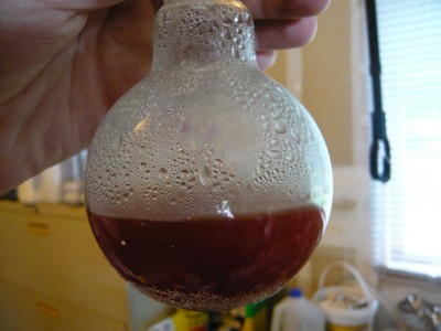

Results are in - this is not copper. Ammonia had no effect on the brown precipitate (which, if CuO, should have reacted immediately). The only other candidate I can think of is chromium, but given the prevalence of blue and violet colors at high pH, this seems so unlikely. In addition, to my eye, the green solution and the ammonia made a yellow solution, possibly indicative of chromate. Uugh, it only gets worse!
Testing on whether the pH~7, yellow liquid resulting from the green solution and sodium hydroxide - HCl combinations is pending. In the meantime, I thought some of the insoluble residue from the initial nitric acid dissolution that was mixed in with the white arsenic oxide might be elemental arsenic, so I plan to attempt to sublime some of this powder.
I think I might have to restart this with a new sample of skutterudite - I have so many solutions resulting from the initial dissolution that I frankly don't even know what happened to the arsenic anymore!
EDIT: The insoluble residue tests positive for arsenic and has a density of ~5g/mL, within acceptable bounds for As's 5.727 g/mL given my sloppy techniques. The only thing left to do for this is test whether the initial ore has the same density (which it well might!) According to MinDat, skutterudite has a measured density of ~6.5g/mL, so I might have to use some more refined techniques... Given that I only have 0.5g of the unknown substance, and significantly more of the initial ore (a few g remaining), I'd like to know if there are any more accurate volume measurements than water displacement.

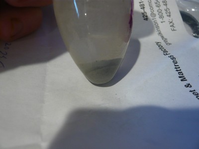

News with the gray leftovers: Almost definitely residual skutterudite. The mystery material was dried and calcined with a blowtorch, causing various brown, white, and black/silver mirrors (for lack of a better word) to appear on the test tube. I then took some of the old ore, back from when I was trying H2SO4 and NaOCl to dissolve the skutterudite (update: Still nothing.). This gave the same results upon sublimation, and upon cooling had developed the same coloration and density, which seems pretty conclusive to me. Ah well!
An interesting note on the sublimation: It's too small to tell, but what appears to be a pure black As crystal roughly 1 mm in length grew in the middle of one of the colored patches. It has very defined crystalline boundaries... whatever it might be. In addition, some of the mirrors were, in fact, bright shiny silver in color before cooling (they dulled to gray-black afterwards). This is the same result as attempting to sublime the arsenic-coated thick-gauge copper wire (it turned silvery and this flowed towards the bottom before the iridescent copper oxides took over the coloration). In fact, I tried cutting a wire in half while it was coated and subliming: The arsenic appears to have soldered the two wires together! :P
Another thought occurred to me: What if this brown precipitate is elemental arsenic? The amount could make sense given the concentration of the starting solution, woelen has mentioned impure arsenic as being brown before, and the supernatant solution (once filtered) tested only weakly for arsenic, taking days to form anything on the wire (and it still is only barely darkened), indicating most of the arsenic has now left the solution. Of course, this fails to explain the variety of colorations I'm getting, but it holds more water than the copper hypothesis (as where would significant amounts of copper enter the equation?)
I guess the only way to find out is to attempt to sublime it once it's dry.

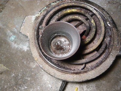

Have you been tired of the poor performance of your aluminium foil? Seeking something new and exciting? Well, try our brand new Arsenic Foil!
Anyway, this flaked off the test tube after I tried subliming some skutterudite ore. Sublimation works somewhat well - I get a mix of arsenic oxide (which fumes out of the test tube) and metallic arsenic, which forms a mirror on the tube walls. So, at least I have something...

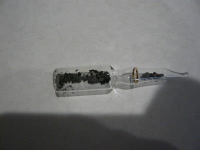

Well, that was idiotic and then brilliant. In that order!
First, I mixed in an equal volume of charcoal, in the hopes that there would be no arsenic oxides from the oxygen in the tube. This ended up being true, but having weird side effects.
Using a cap on one end didn't go so well, as nothing I did could keep it shut enough for the gases to escape. So, I took that apart, hammered both ends shut, and heated for a very long time, being sure not to touch one end (as that was where I wanted the arsenic to end up). The end result, after I hacksawed it open at the middle, was pleasing!
(Everything is a lot more metallic than it appears in the photo, because my inside lighting is frankly terrible.)
The larger lumps are actually coalesced arsenic, that appeared to have melted together! I assume this is due to the carbon dioxide (from the charcoal, the oxygen, and heat) causing enough pressure inside the tube to mess with the phase diagram and cause the arsenic to melt rather than sublime. Works for me - now I didn't have to worry about scraping off foil!
I am very glad to have a sample of arsenic in my collection, and also to never have to touch this stuff again.
