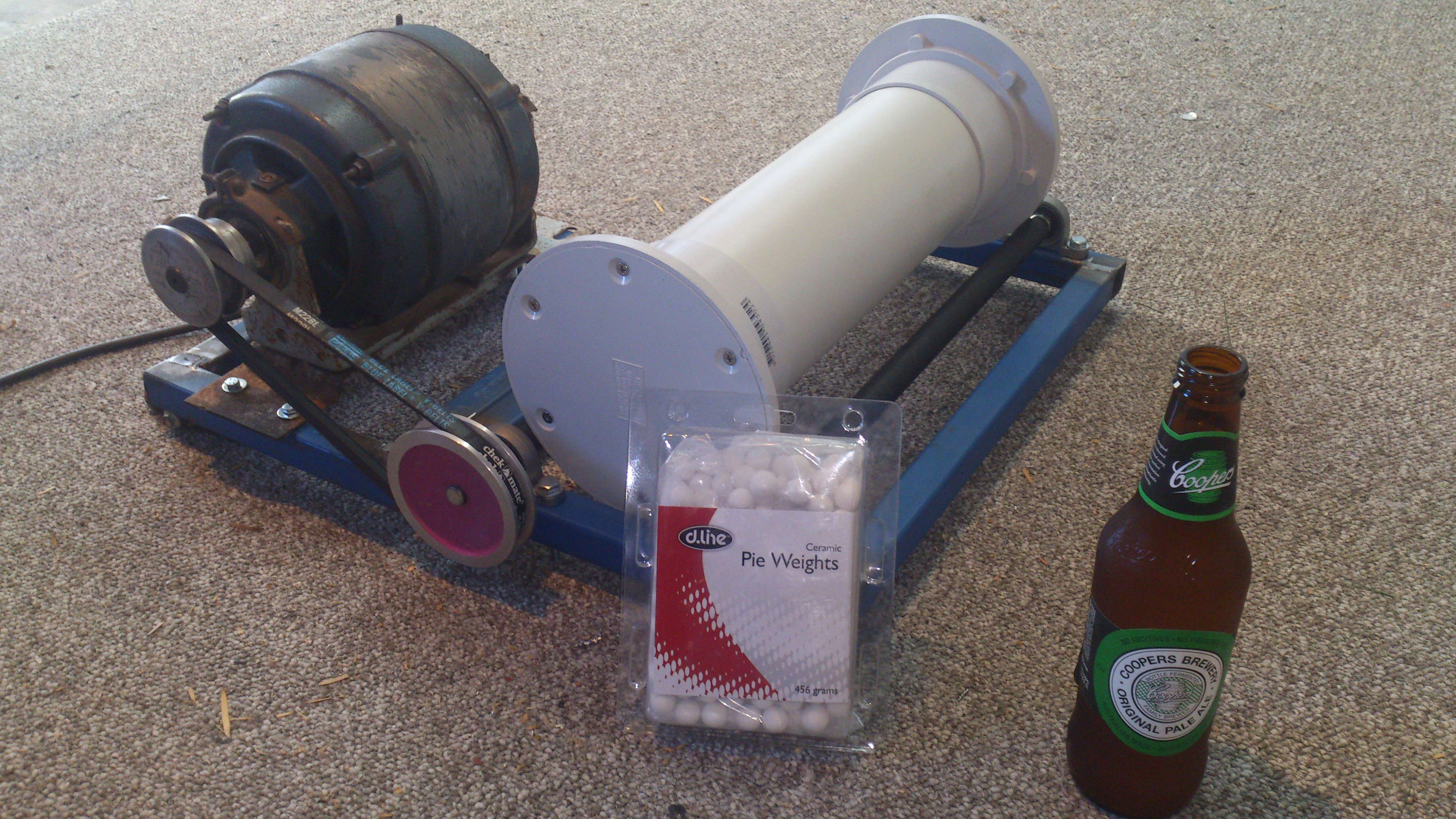

I found some water tight PVC end caps that have 6 screws and a rubber O ring, I do some reloading and they'll be perfect for wet tumbling dirty brass. This is 100mm PVC with an outside diameter of 150mm so I can also use 150mm PVC with end caps without having to change pulleys.
I also picked up a few packets of ceramic pie weights today from a homemaker shop to try in the mill

Nice work NedsHead !
Being able to use 100mm and 150mm barrels without changing anything is really smart.
Looks like a fairly large rig, judging by the familiar landmark ;)
I guess you could use shorter lengths of Barrel too, so doubly smart !

Thanks, I thought the aga scale was necessary;) I have 2 more 100mm end caps for that exact reason, to build a smaller drum for milling black powder and what not.
I'm really happy with how this project turned out

That is a beautifully made roller, Mr. Head. I wonder though how fast that thing is going to spin with the motor and pulley assembly you have?
Also, I never knew what a "Pie Weight" was until you posted this - now I can ball mill and also make wonderful pastries...

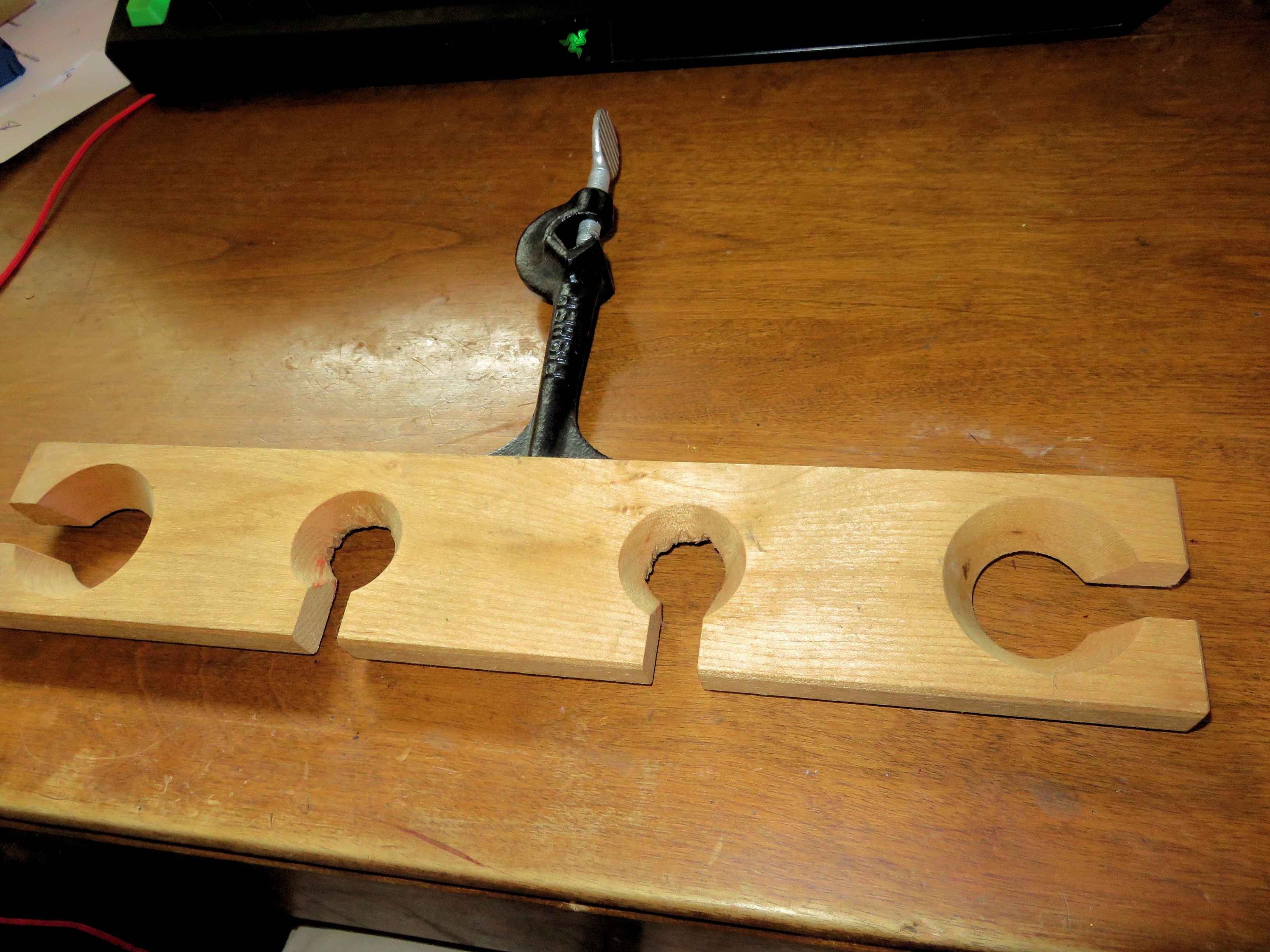

Personally I don't mind using wood equipment, although I always try to varnish them to protect the wood. I find this one is very useful for holding funnels, and plan to varnish it in the next few weeks:

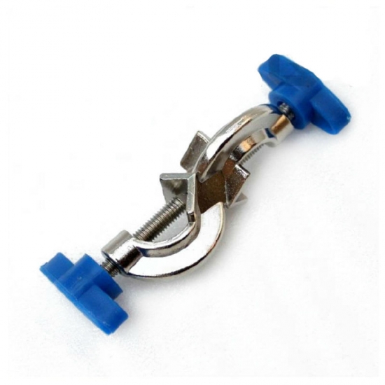

Traditional lab stands have a rod diameter of 3/8" of 9.525mm. It would be fairly simple to pick up some at the hardware and drill into an old 5-10lb barbell weight to mount it along with a liberal amount of epoxy of some sort.
I notice on eBay that the "boss head" clamp holders are dirt cheap from China (~$2.20ea.w/ship.), whereas clamps usually run for ~$8.50ea.w/ship.
I have seen these metal clamps coated with a plastic sleeve of some sort and it resembles many lab clamps sold on the internet, but I have seen these for sale in places like Harbor Freight and Northern Tool for only $1. Perhaps with as simple modification of removing the plastic sleeve and instead use a heat resistant fabric of some sort. My tack welding skills are not the best, especially for small objects, but I'm sure it would be possible to attach a short length of 3/8" rod to the clamp in order to attach it to the boss head clamp holder.
Then, you have everything you need for a stand for nothing compared to what people are charging on the internet.

Those Chinese boss head clamps you pictured are awful, they're poor aluminium castings and the inside threads are the worst, my distillation kit came with 2, the threads are drilled and taped crooked and a sloppy fit, the aluminium is so soft when you clamp down it strips out the thread, you really do get what you pay for with these cheap Chinese clamps

Quote: Originally posted by NedsHead
you really do get what you pay for with these cheap Chinese clamps.
Thanks for the heads up.

I have Chinese clamps that look similar to the one pictured. But they are not Al, cost slightly more than what you quoted, and thus far have been reasonable.
