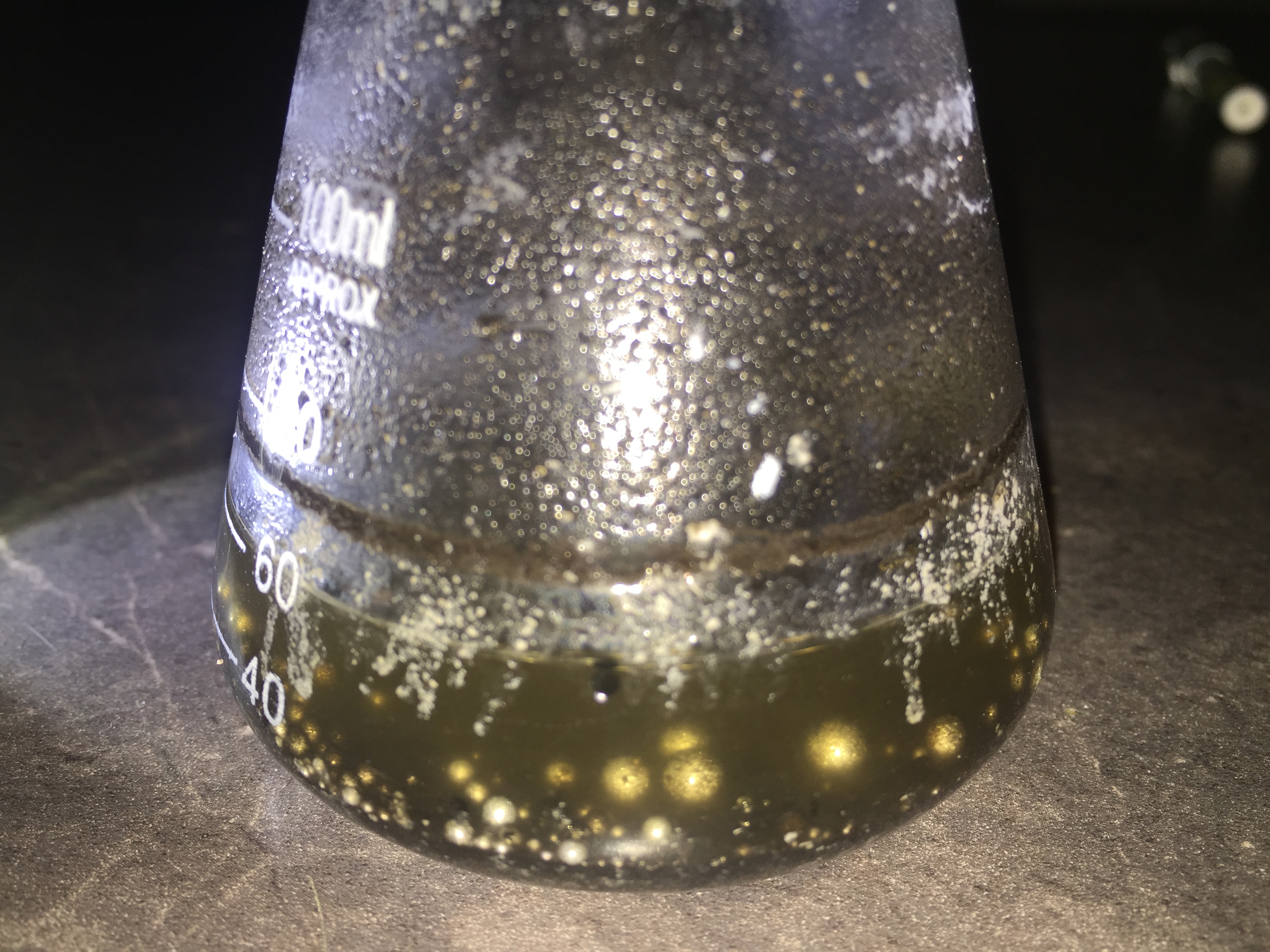

So I did another test last night and found the fineness and shine of the Mg is really the key factor in my successes. I did a run using 50 ml lamp oil this time with 3.5g Mg 7g KOH and 1.2 ml tert butanol. Everything was added at the start and I let this run go for 6 hours. There was quite a lot of small to medium spheres sitting atop the reaction mixture by the end and I'm quite pleased with the results. I was also wondering if anybody has attempted to recover the used tetralin before? It's kind of expensive an if possible I'd like to recover it for further use. I have around 100 ml and was thinking about running it through a fine filter and dropping the temp to see if the un used catalyst will solidify for removal. Failing that I will just heat it to drive the alcohol off first and distill the tetralin that's left.
image.jpeg - 2.3MB image.jpeg - 2.2MB
image.jpeg - 2.7MB
It's believed the catalyst is post-reaction present as K alkoxide (see proposed reaction mechanism, higher up).
I believe filtering after chilling might very well work. Considering the cost of tetralin, its worth trying.
There's some work done by me on recycling, reported higher up in the thread.

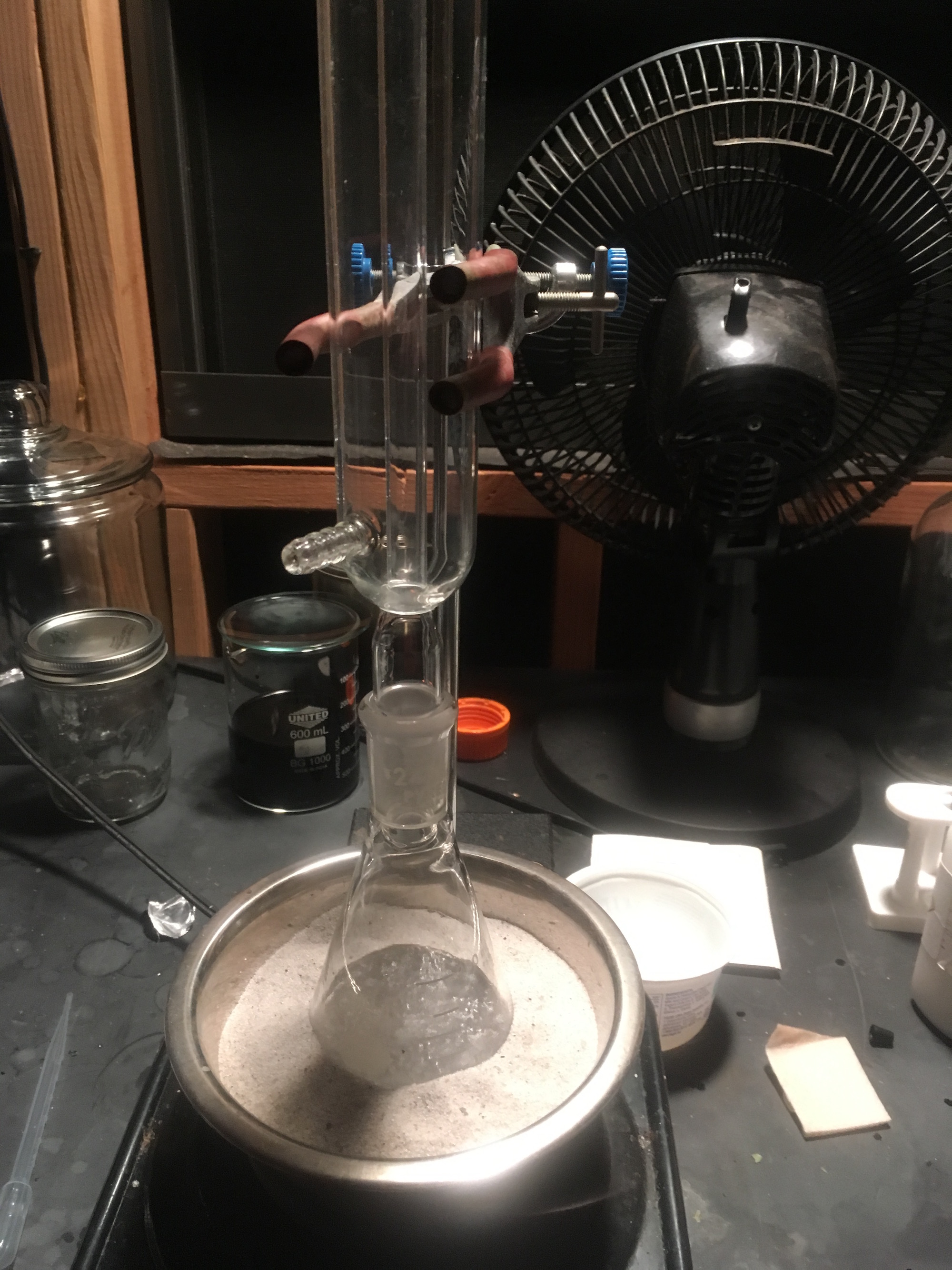

I made an attempt at the reaction for the first time yesterday. Didn't work at all though because I couldn't get the sand bath hot enough. I think the old hotplate I was using is finally over the hill.
https://texium.wordpress.com/2016/12/29/failed-attempt-at-po...

I've tried making potassium several times now with no success what so ever. If someone could possibly give me some advice or tips, it would be greatly appreciated:). Here's a description of my latest attempt:
The magnesium was activated by leaving it to stand in a beaker of 5% acetic acid for about 20 seconds. This seemed to be effective at removing the oxide coating on the magnesium.
To a 500ml round-bottom flask, was added 3.5g of magnesium turnings and 7.3g of 95% potassium hydroxide flakes. Around 60ml of kerosene was then added in to act as the solvent. As a heating source, I used an oil bath (spent engine oil instead of cooking oil) heated by a hot plate. A liebig condenser, circulated with water and loosely sealed at the top with Al foil was then attached to the flask. The heat was set to maximum and pretty soon the kerosene began to reflux steadily in the flask. After 15 minutes of reflux, I added in 1.5ml of tert-butanol though the condenser.
After around 20 more minutes of reflux, another 1.5ml of alcohol were added. The mixture was refluxed for around 5 hours. Upon examining the contents of the flask, I found no potassium what so ever and the reaction mixture appeared almost completely unchanged. After removing the kerosene, a bit of water was added to the mixture resulting in no effect at all, confirming the complete absence of potassium:(.
It definitely got hot enough, the oil must have been well over 200 C.
Is there anything obviously wrong?
Posts: 3040
[*] posted on 30-12-2016 at 23:06
Maybe too much water in your KOH, next time you can evaporate a part of your kerosine before adding magnesium and t-butyl alcohol to get rid of the water.
