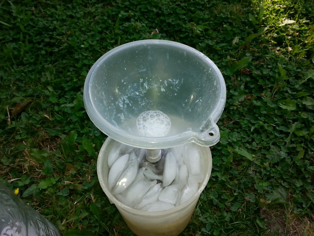

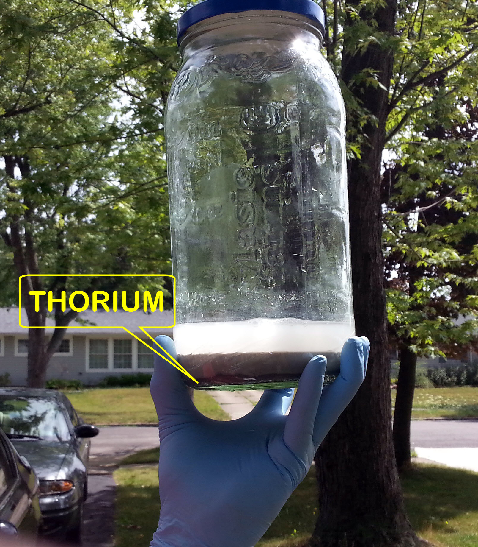

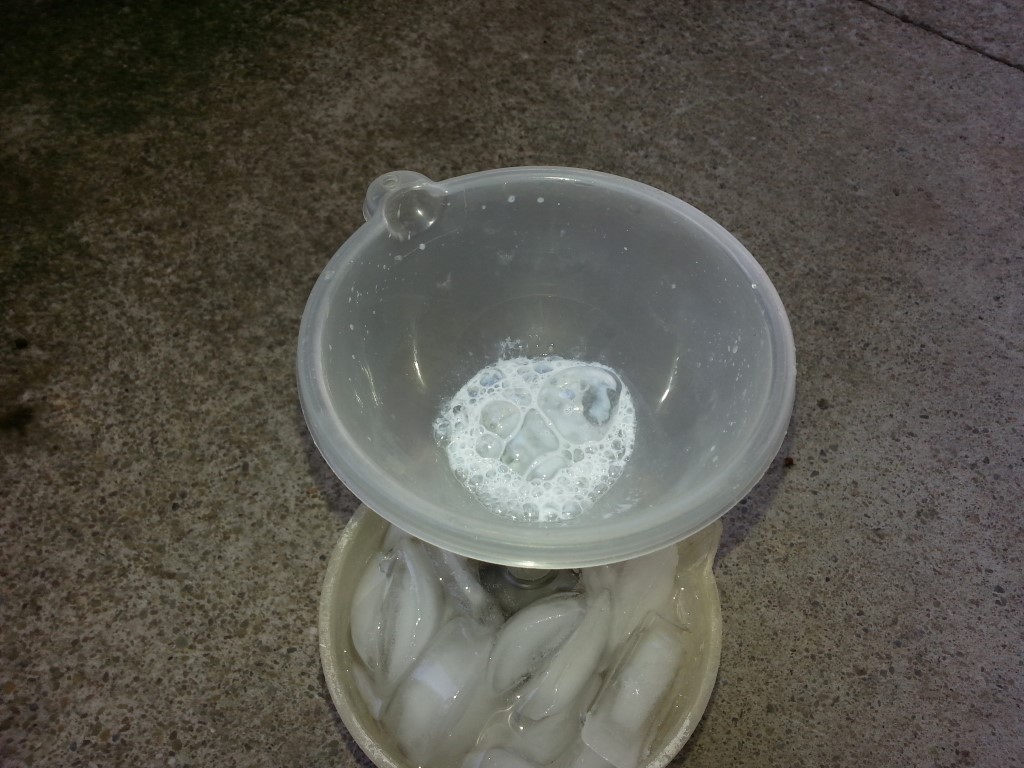

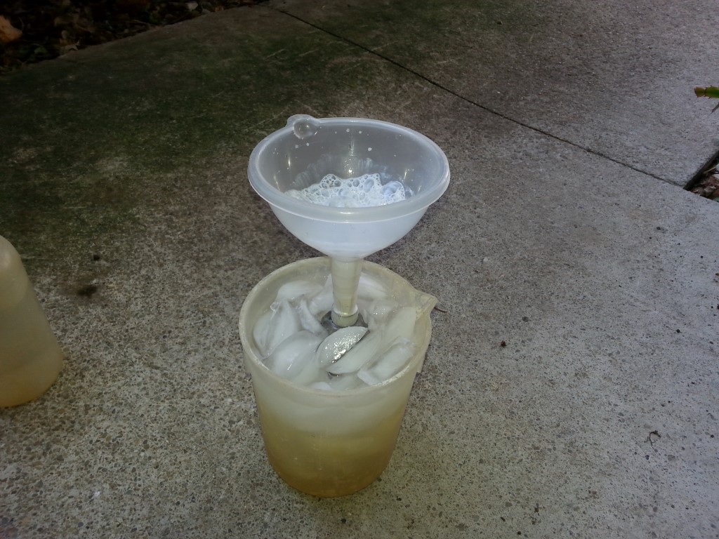

The hydrolysis step appears to be easier than anticipated. The reactor was fitted with a plastic funnel, cooled in an ice-bath and 3 x 80 mL H2O was
added in a thin stream. Each time, the reaction was allowed to proceed until the slurry seen in the funnel stem became too thick to allow gas out
easily. This slurry was collected in a 1 L beaker. The next portion of H2O was added, etc. A smell was noticed. It could be from a gas or a
microscopic mist. I think this should be enclosed when being done and a long period allowed for all possible mist to settle out.
Shown are a few seconds of hydrolysis 1 and pictures of #1, #2 and #3 which show decreasing reaction rates.

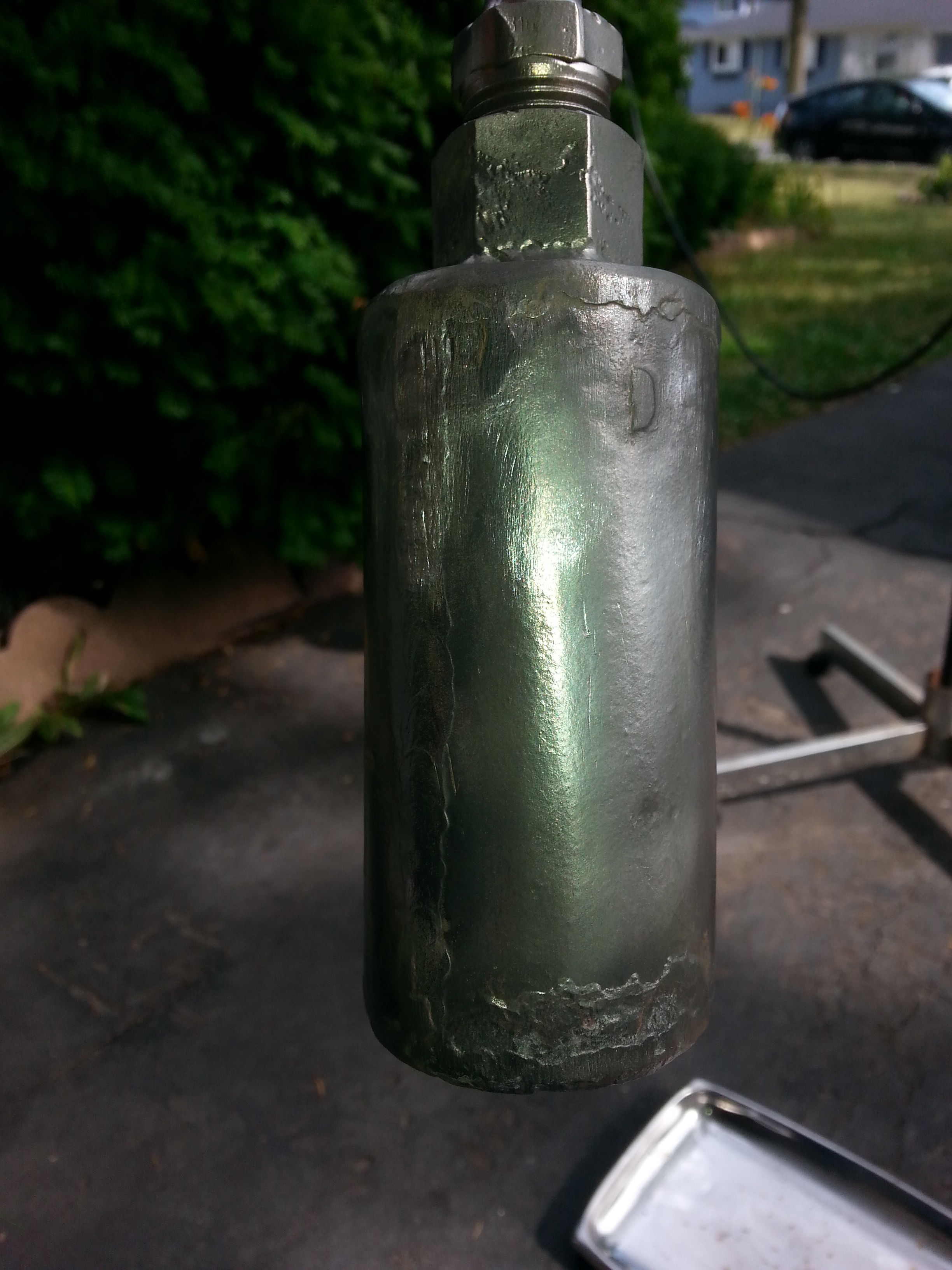

A couple things learned in the trial run w/o ThO2:
a) The Ca(OH)2 formed is a real nuisance. Now I understand what was implicit in the patents, that it is not dissolved away (solubility = 1.7 g/L @ 20
C), but rather poured of with the supernatant liquid. This explains why the thorium is obtained in two forms, heavy grains which settle much faster
than Ca(OH)2 and in the form of "fines" which are decanted off with much of the un-dissolved Ca(OH)2. This is a further handling/isolation issue to
address once the majority of the Th is recovered.

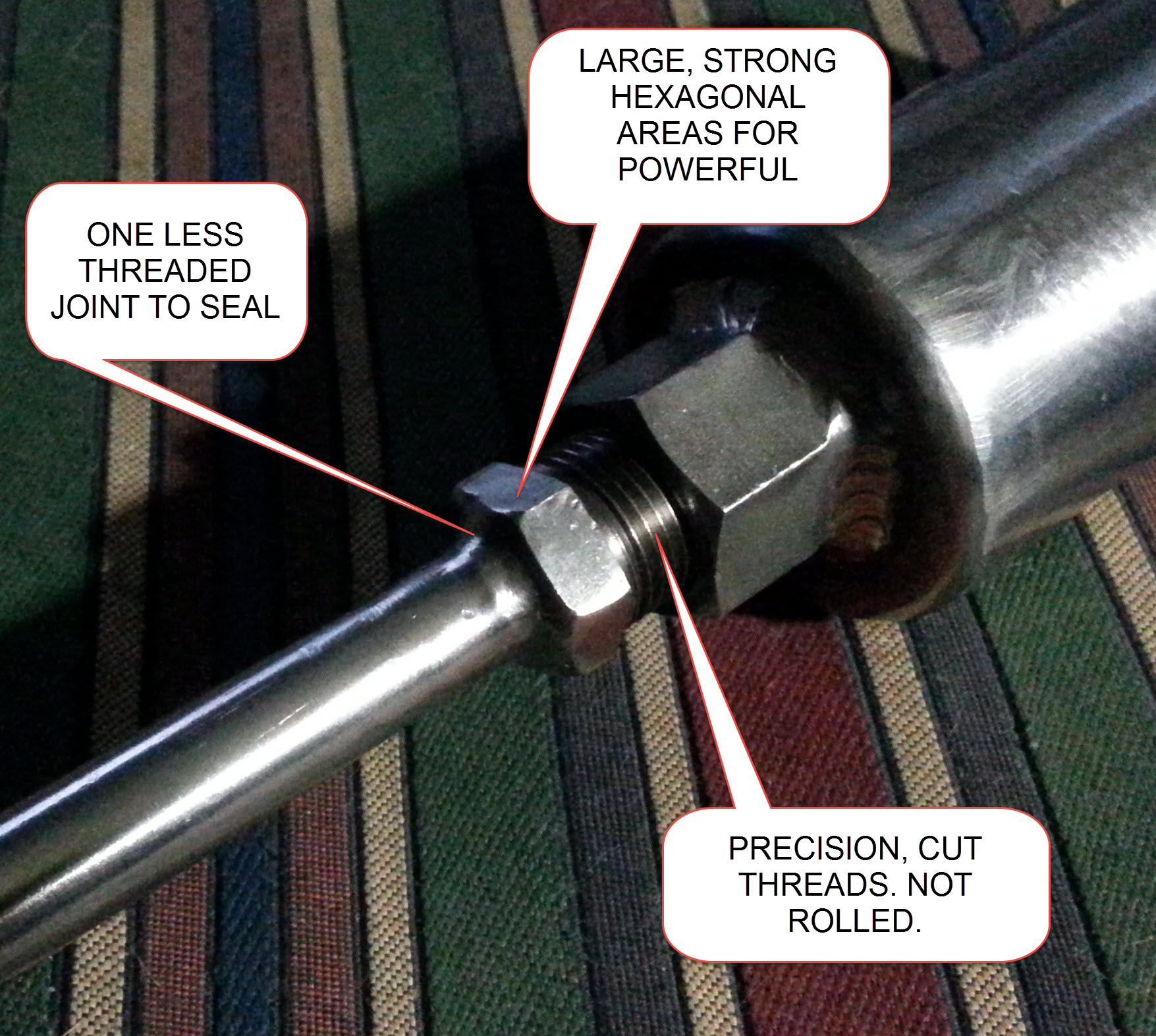

b) The presence of oxidation on the 1/4" NPT threads of the pipe which screwed into the reactor indicates some oxygen diffusion. This led to two
decisions. The first will be the inclusion of a minimum practical amount of a 2600 F nickel platelet/graphite anti-seize lubricant on the outer 1/2 of
the threads. The second has to do with the 1/4" NPT to 1/2" NPT bushing used for the intended reactor. The bushing is rust-resistant steel, not
stainless. I want it gone. So, I cut the 1/4" male NPT threaded end off of where I welded it to the pipe, and used a 1/4" NPT pipe die to cut threads
in it. I had a solid 1/2" NPT 316 SS pipe plug, with very high quality threads. I bored a concentric hole through the middle and will thread this with
a 1/4" NPT tap. After very tightly screwing this together, it will be welded all the way around with Weldmold 880 (a superb welding rod, about 8 to 10
times the cost of SS rods, but what an incredible performer!). This weld won't come in contact with the reaction mixture, so the high alloy content
won't worry me.

Well, a few mundane but useful facts were learned:
a) Complete work-up of the blank, run in SS 304, gave only a few milligrams of insoluble gray material (perhaps too small to even collect and weigh).
This bodes well for minimal metallic impurities in the product.
b) Without a thread sealant, no amount of torque can seal the threads entirely gas-tight. My one concern is the hydrocarbon and graphite that will
burn off the sealant and cause minimal C contamination of the Th. If that's the case, it still greatly beats O2 contamination.
c) I used 1.5 times the specified amount of dilute HNO3 to dissolve all of the Ca (OH)2. If some Th is lost, it will be (recovered) worth it to avoid
solid-bearing mists from high speed agitation.

Not surprising. Even though NPT are considered fluid-tight it requires exceptional tolerances or that one part can yield. If a sealant isn't desirable
a gasket or crush washer between the two nuts should work.

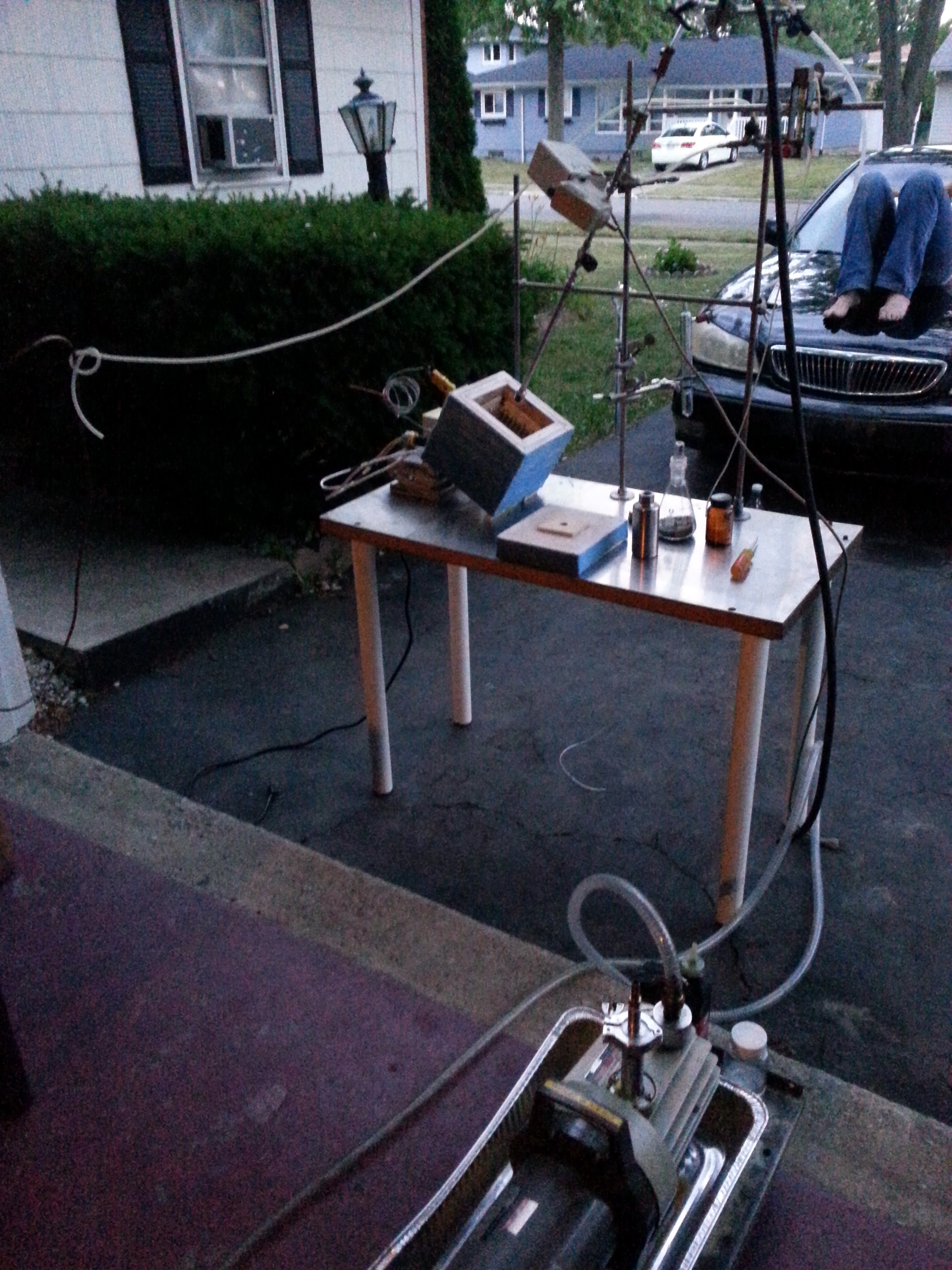

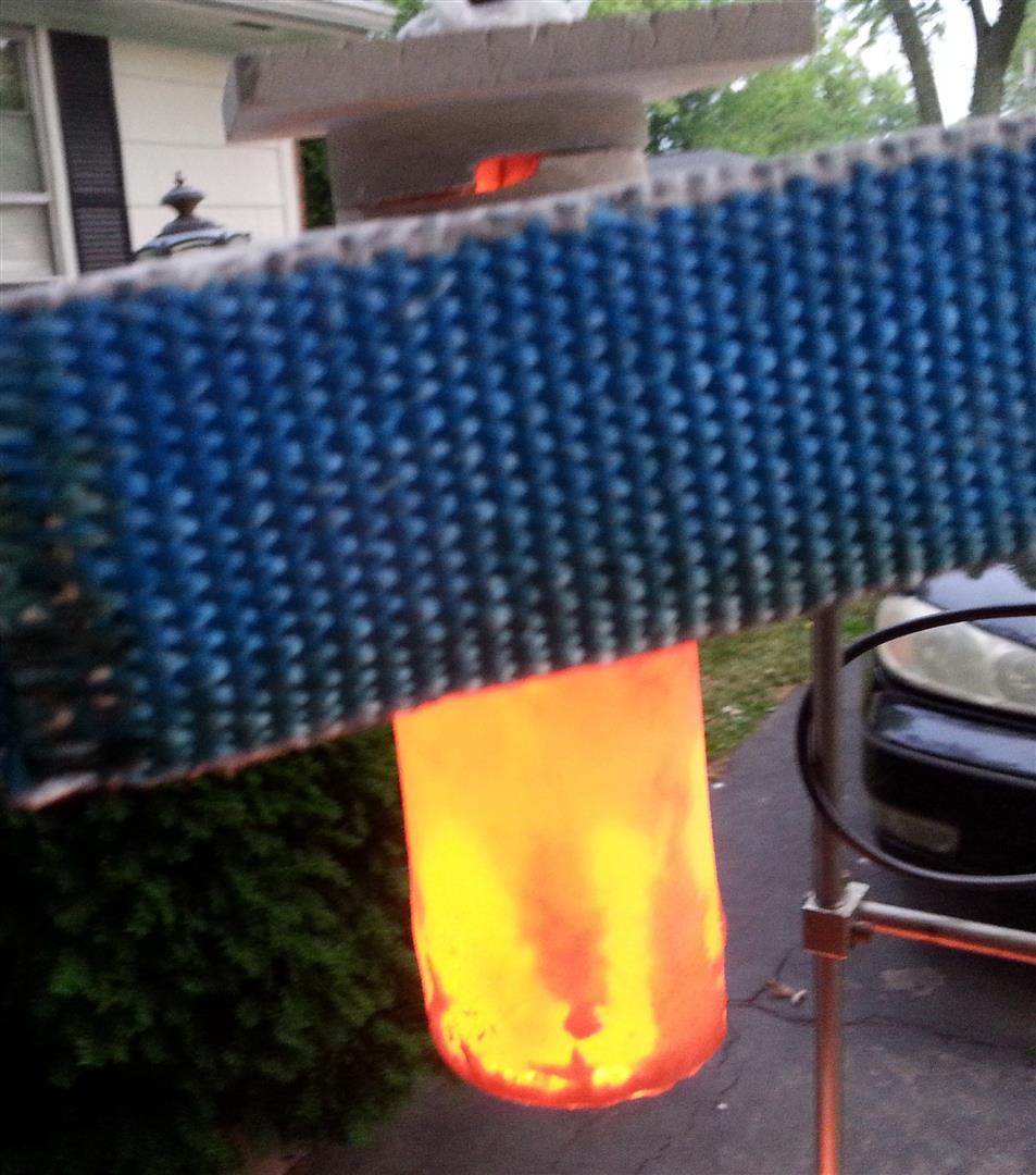

For now, here are some visuals:
https://www.dropbox.com/s/w7p1lr0m47dduky/Start%20of%20Th%20...
This is a short clip of the start of the reduction (initial heating).
I'm now at 950 C (2:20 PM).

Dan:
Tell me again what is the purpose of the inclination?
Dan Vizine
Posts: 628
Registered: 4-4-2014
Location: Tonawanda, New York
Mood: High Resistance
It's to achieve good mixing. If it were vertical, stirring wouldn't be as good. The original workers milled their charges to get a homogeneous
mixture. That wasn't easy, practical or safe for me.

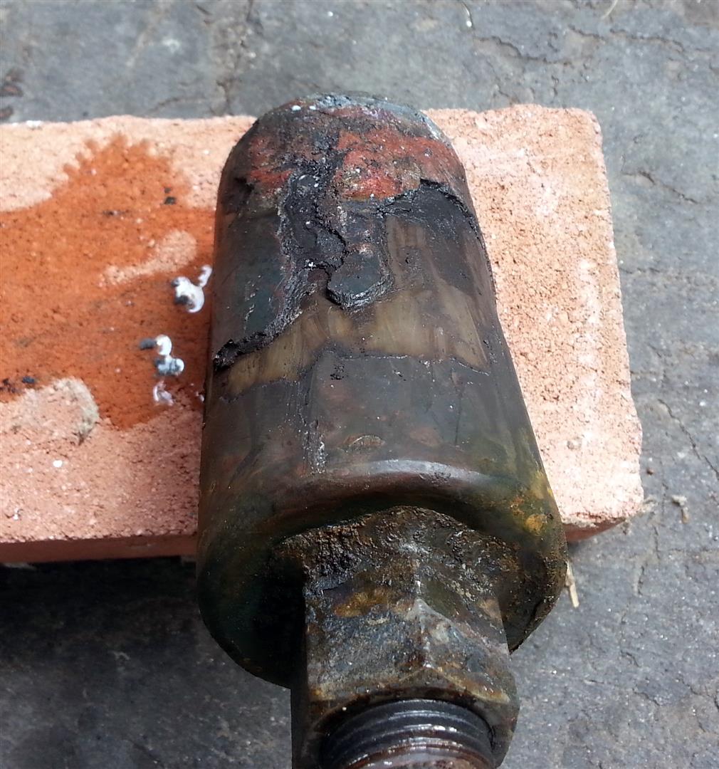

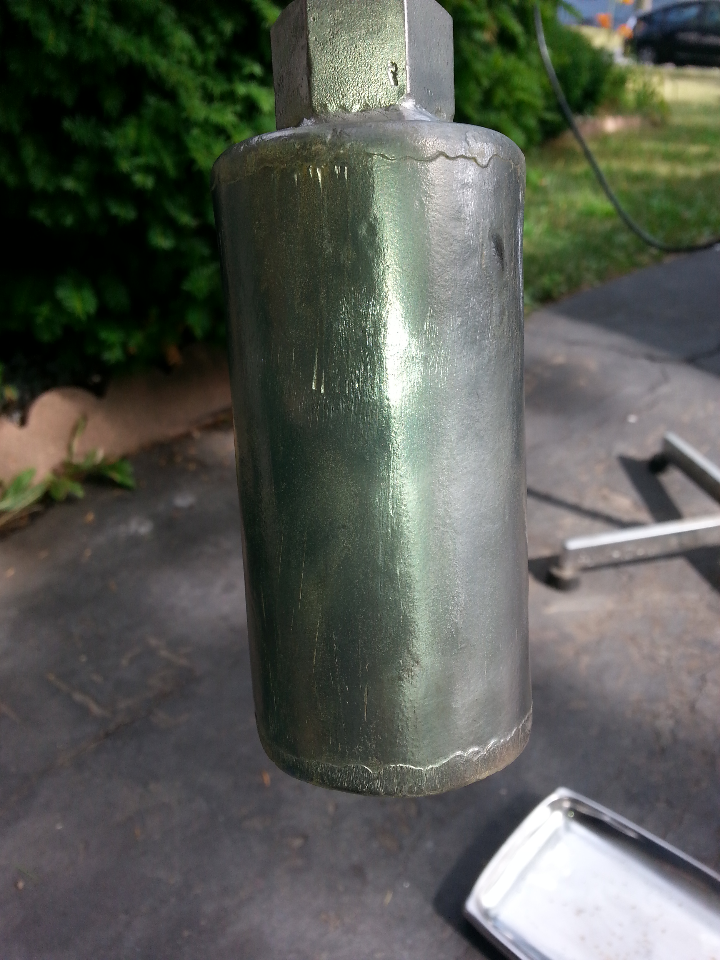

Quote: Originally posted by Fulmen  | That is some serious conditions, bro. But does it have to be completely oxidation proof? Only the outer surface will oxidize, so as long as it's
diameter is large some loss shouldn't affect the seal. And any oxygen leaking through the mating surfaces would oxidize the material, wouldn't this
produce an increase in volume that could cause it to be self sealing. Not sure if that would work, but it's worth some consideration.
One other problem with a gasket like this is the thermal expansion, if it is different from the vessel it could cause problems either during heating
or subsequent cooling. So a thin gasket would probably be the safest option. |
A practical metal gasket for threaded connectors? I didn't know they existed. Funny you should mention oxidation though..."heat-resistant" SS 308
seemed to fare far worse at 950 C than the SS 304 that I usually use. That forms a tightly adherent scale, this eroded away layer by layer. I was
certain that I had a reactor breach upon first sight. I'm still inspecting and cleaning the reactor and struggling greatly to unscrew the connecting
pipe.

I cleaned thing things up in preparation for hydrolysis in place. Mostly okay, but one area is slightly suspicious. Still assessing. Yes, I know this
is glacial. Sorry, but it is progressing....
"All Your Children Are Poor Unfortunate Victims of Lies You Believe, a Plague Upon Your Ignorance that Keeps the Youth from the Truth They
Deserve"...F. Zappa
Dan Vizine
Posts: 628

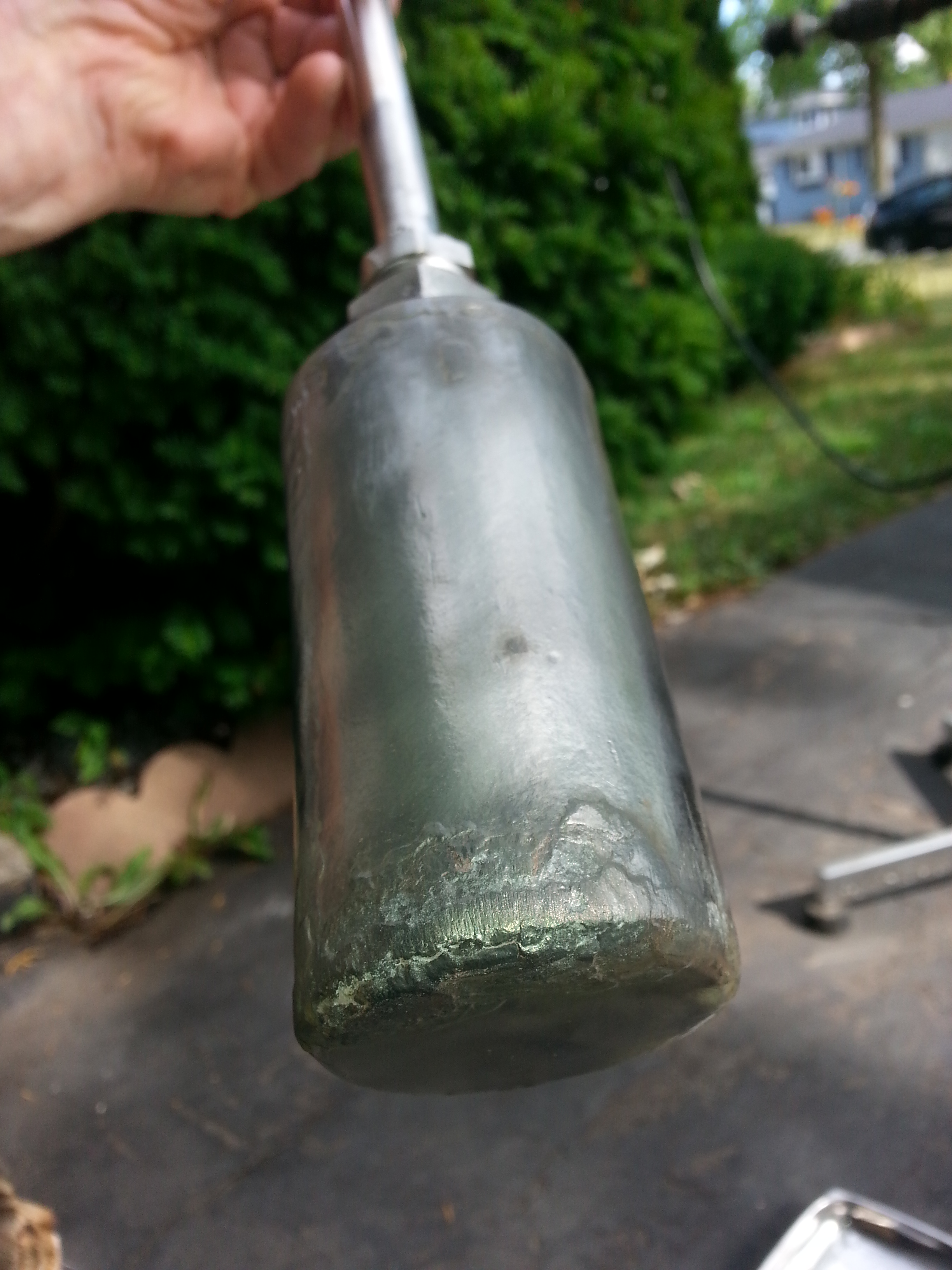

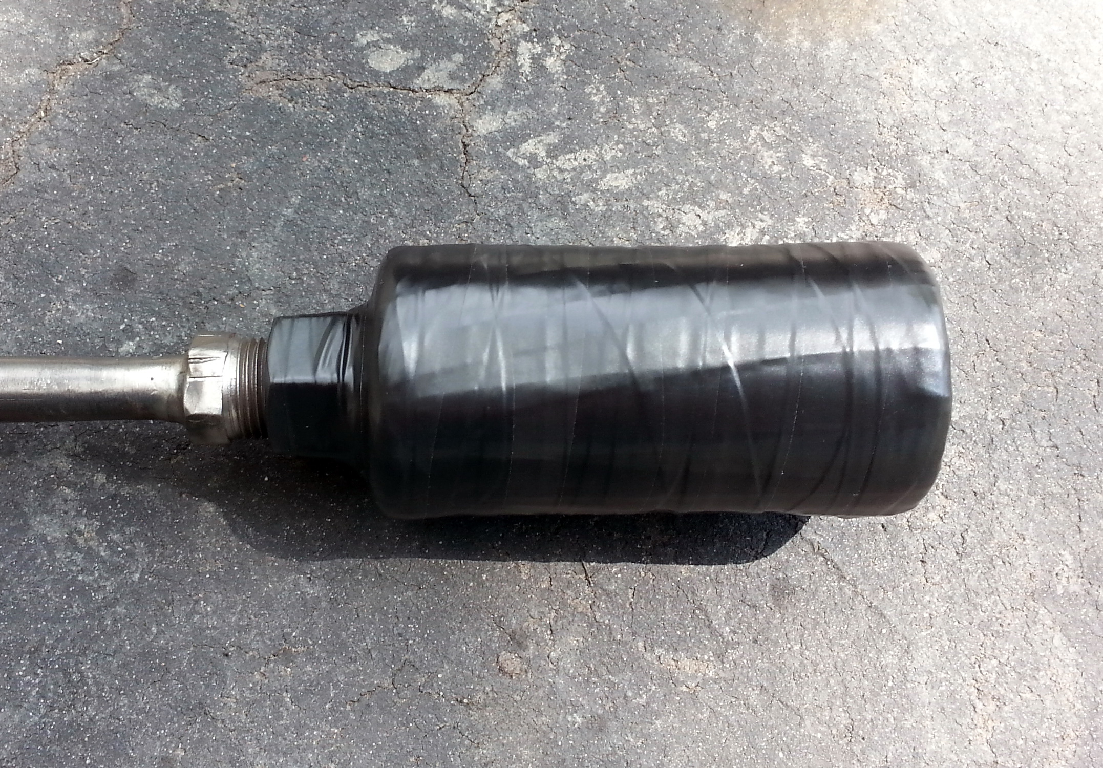

The 1/2" threaded connection yielded to a pipe vise and a 24" pipe wrench.
The reactor was prepared for the "in-place" hydrolysis by thoroughly isolating the reactor's exterior to prevent sloughing off of impurities during
submersion. Theoretically the interior should be quite clean.

Dan Vizine
Posts: 628
The interior, what I could see of it, was clean. Hydrolysis was performed as per 9-24-15 trial run, but under a sophisticated cover - a clear acrylic
wastepaper basket with a 1/8" hole in the top, er, bottom...you know what I mean, for drop-wise distilled water addition. I'm eating spaghetti, it's
ever so slightly effervescing. Tomorrow morning I'll pour it out....

seems to look pristine white and fluffy.
Dan Vizine
Posts: 628
I had the same thought, it's a bit anticlimactic to look at.
Thorium is like most primarily alpha emitters. Essentially harmless in the sense that alpha particles don't penetrate skin. But ingested or inhaled
alpha emitters are super dangerous, see polonium, plutonium.
Now, on to the final isolation...
[Edited on 2-8-2016 by Dan Vizine]
Deserve"...F. Zappa
NEMO-Chemistry
Posts: 1559
Registered: 29-5-2016
Quote: Originally posted by Dan Vizine  | I had the same thought, it's a bit anticlimactic to look at.
alpha emitters with long half-lives are super dangerous, see plutonium.
[Edited on 1-8-2016 by Dan Vizine] |
Must be deeply satisfying though after all the effort to finally get your crude product.
Well done its a really inspiring read.
Dan Vizine
Posts: 628
Thank you most sincerely.
The story isn't over by a fair stretch. A good write up needs to be done, all info. in one succinct spot. Anomalies (there was one, as hinted at by
the reactor's bottom edge) need analysis. Spoiler..it seems to have been rather benign. And the final product isn't a final product until fully
processed, washed, dried, passivated & bottled.
Yes, satisfying and a relief. So many man-hours, so much labor and more than a few $$ were involved. I even built the furnace for this project. The
tank of UHP argon was $140, the tig welding was $140, the chemicals were over $800, misc. materials were another $50. Way, way over 100 man-hours all
things considered. Perhaps 200.
Deserve"...F. Zappa
