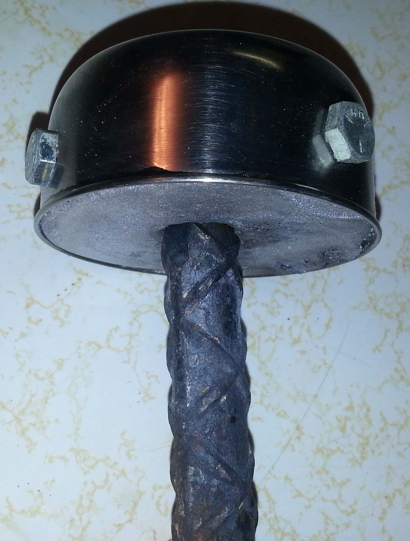

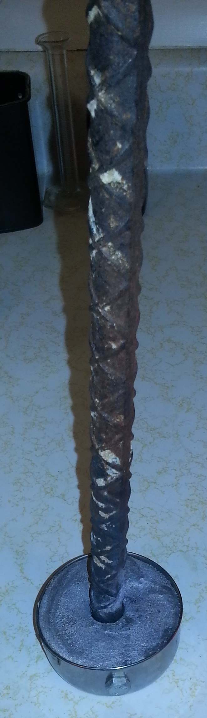

Home made pestle
I needed something to crush large crystals and charcoal and things such as this. So I came up with this:
pestle1.jpg - 100kB pestle2.jpg - 87kB pestle3.jpg - 179kB
IDK how thick the rebar is but the measuring cup is 3/4 cup and filled with lead. I added screws & nuts on the inside to lock everything in place. I would guess this all weighs close to 5-6 lbs and works great for breaking up whatever is needed

re Rogue Rose's pestle
Great idea! Now I have another use for my 6-lb sledge. I tried to crush some sea shells with a regular mortar and pestle, but I won't live long enough to crush a significant amount. Now where did I put that sledge...
