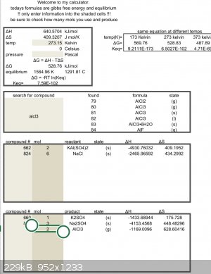

[*] posted on 19-11-2022 at 16:01
Quote: Originally posted by sceptic
$$2KAl(SO_4)_2(s) + 6NaCl(s) \longrightarrow K_2SO_4(s) + 3Na_2SO_4(s) + 2AlCl_3(g)$$
Feel free to double check the math but looks like you need more heat.
Screenshot_20221119_190039.jpg - 229kB
Edit:
$$3\text{ZnCl}_2(anh,s)+2\text{Al}(s)\longrightarrow 3\text{Zn}(s)+2\text{AlCl}3(g)$$
Screenshot_20221119_190621.jpg - 171kB
[Edited on 20-11-2022 by Rainwater]
For a gas evolution reaction you don't need to reach equilibrium; if Keq is not extremely low you'll see some gas evolution. This is because the entropy of a gas is measured at atmospheric pressure, but much higher at low partial pressure. With that said, it's not clear that he would have gotten there.
Thanks for the information! I tried to do those calculations, but I wasn't able to find the entropies of formation for the various sulfates. What calculator are you using?
Every time this discussion comes up I point out that MnCl2 can be dried by heating and should react just fine with Al.
Do you know at approximately what temperature that would react?
I have never performed this reaction, but have been using that excel sheet with great success to do other reactions.
Delta g = zero at 604c
but this is only an estimate so hotter than that. The reagents might need to be a liquid before the reaction will start.
Aluminum melts just above that temperature.
You will have to try it to find out.
Test tube and alcohol lamp will easily reach that point.
