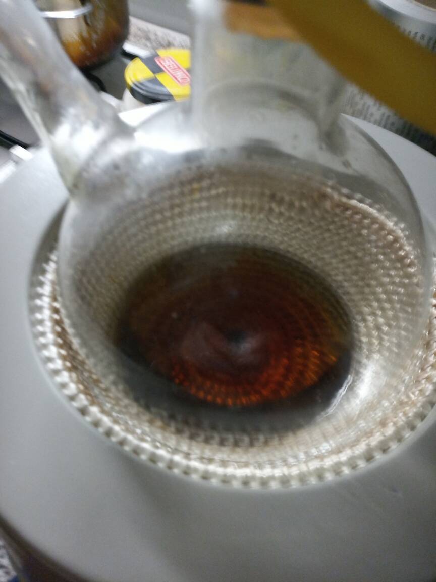

After 1 hour when dropping finished, heating was turned on and the reaction refluxed for 1 hour (maybe unnecessary, no lachrymatory chloroacetone present anymore even before reflux, maybe the reflux is only harmfull and could cause some undesired aldol condensations).

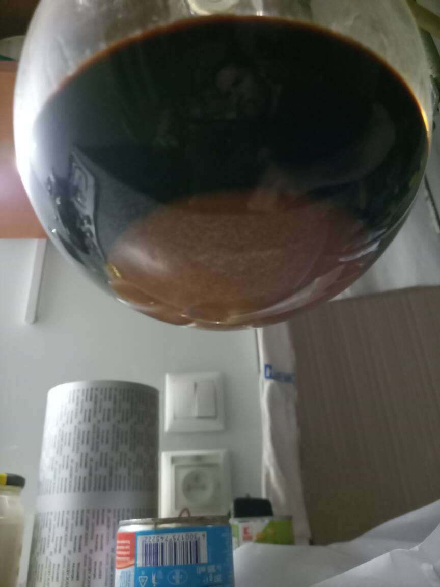

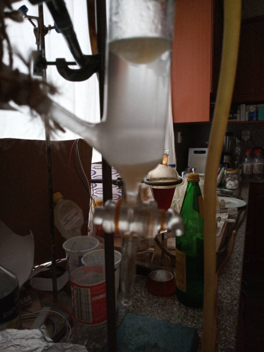

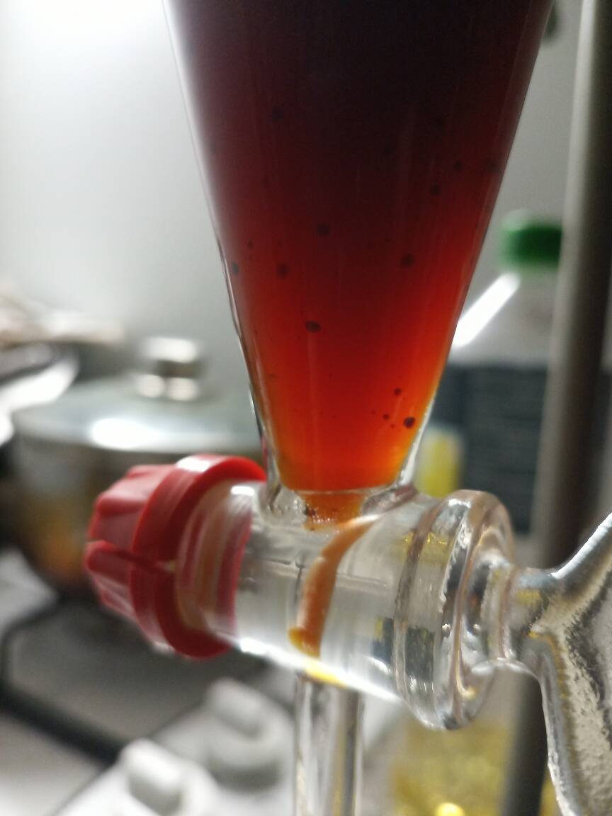

Using 250 cm3 sep. funnel (half a liter would be better), upper organic phase was kept and low water phase containing NaCl was discarded. Water phase had nice smell, but I'm unable to describe/characterize it.
Water phase was alkaline on universal pH paper = not enough chloroacetone, but good that all was consumed and there was not excess of HCl which would cause aldol condensation side reactions.

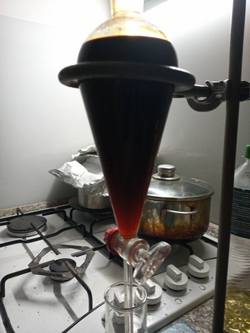

Washed twice with 100 cm3 of 5% NaOH saturated with NaCl (10 g NaOH into 150 cm3 of water, later add 50 g of NaCl).
Organic layer was always top and much darker, almost black, much more viscous, water phase dark red colored and so dark that it was hard / almost impossible to distinguish between the 2 phases.
Washed with 100 cm3 saturated NaCl, here finally the 2 layers and the border visible, water layer still alkaline on universal pH paper (very likely washing out Na phenoxide from the organic layer, using less NaCl would increase washing out Na phenoxide but would cause difficulties in phases separation).
Washed again with 100 cm3 saturated solution of NaCl, water phase still alkaline.
Washed finally with 100 cm3 of water, now the organic phase was the bottom !!!

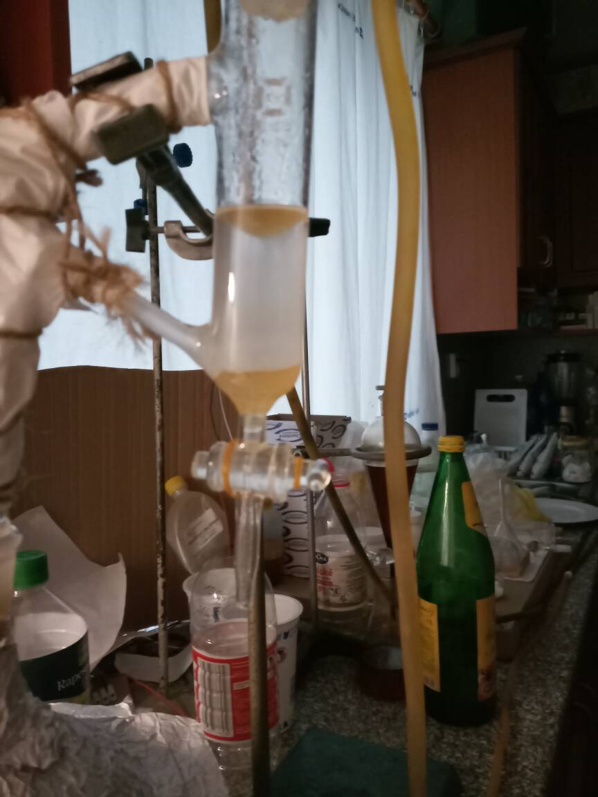

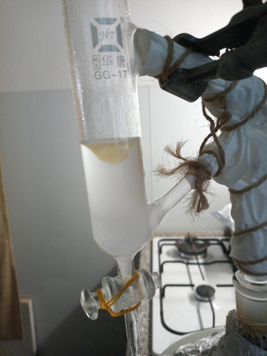

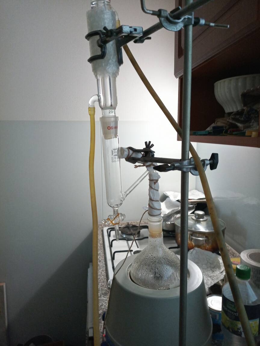

A distillation using Dean-Stark trap apparatus was attempted but it was not good enough. The density of phenoxyacetone is about 1,1 higher than water but a lot of the product stayed on the top and flew back into the distillation flask though the arm of the apparatus.

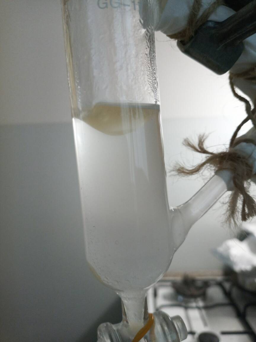

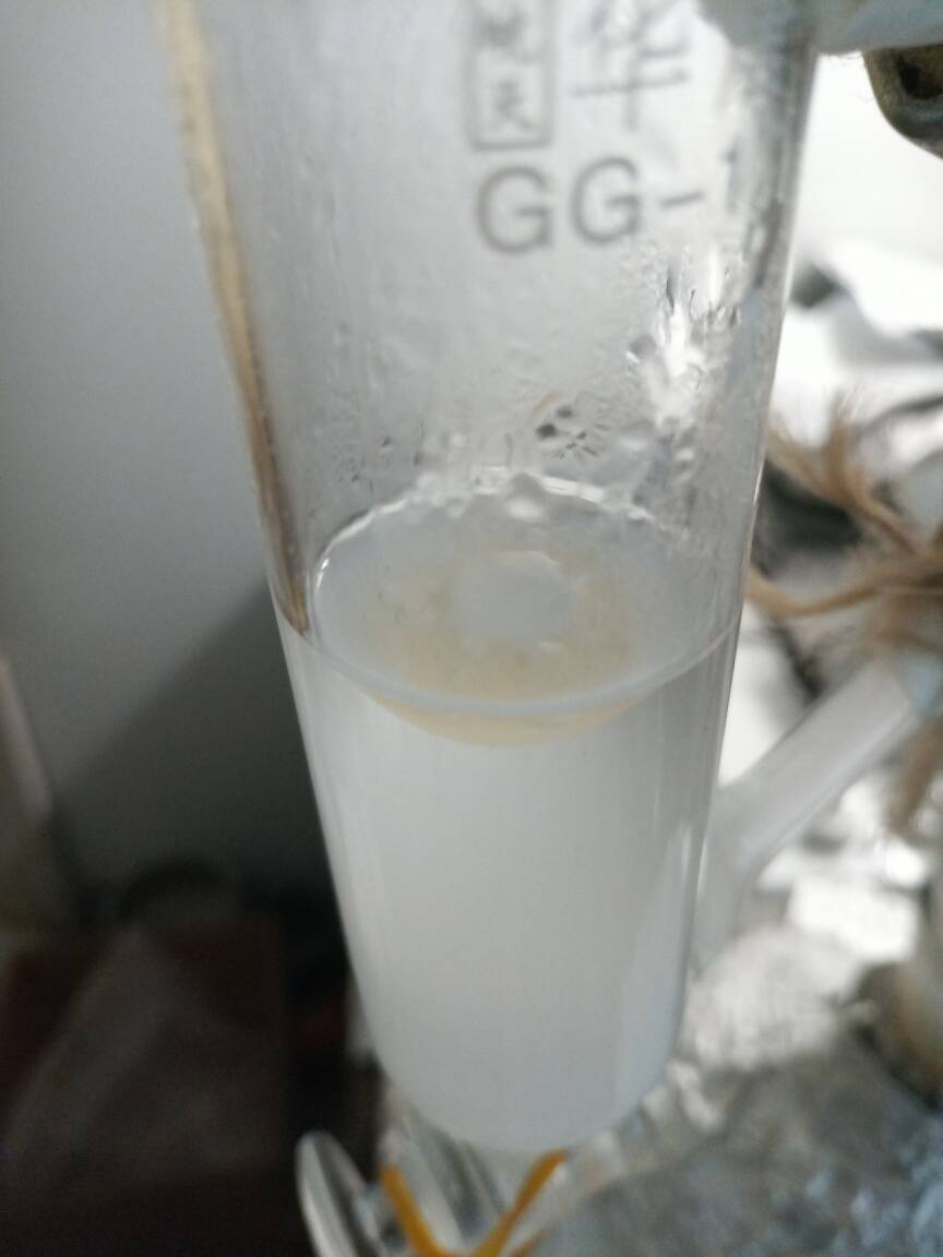

Distillation was continued using Clevenger distillation apparatus and STRONG MAGNETIC STIRRING (prevent bumping, the density of organic layer > the density of water so it tended to collect on the bottom, magnetic stirring was essential, even during stirring there were like 2-3 second intervals when the boil interrupted temporarily and then resumed with higher intensity).
When the blobs of the product on the surface became big enough, their broke surface tension and adhesive forces to glass walls and sunk to the bottom.
Luckily also Clevenger apparatus had some small nonzero volume reservoir on the bottom where the product collected and was periodically drained out.

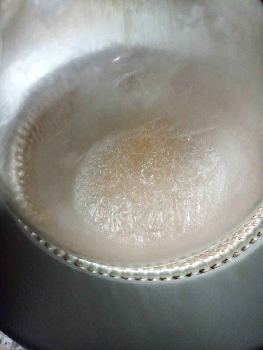

phenol in reaction flask

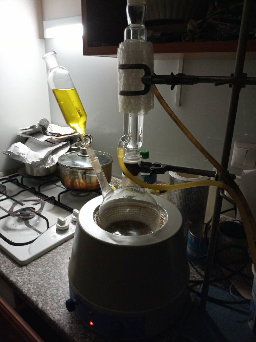

reaction apparatus, chloroacetone (very impure) in addition funnel
IMG_20250205_182229_2.jpg - 80kB

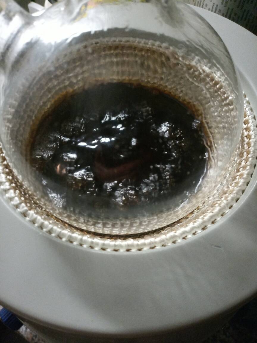

first few drops of chloroacetone change the color of the reaction mixture into red
IMG_20250205_182300_3.jpg - 64kB
after the 1 hour lasting dropwise addition of chloroacetone the reaction was heated and refluxed (I'm not sure whether this is necessary and whether the chloroacetone did not react completely already during the dropwise addition)
IMG_20250205_192906_3.jpg - 87kB

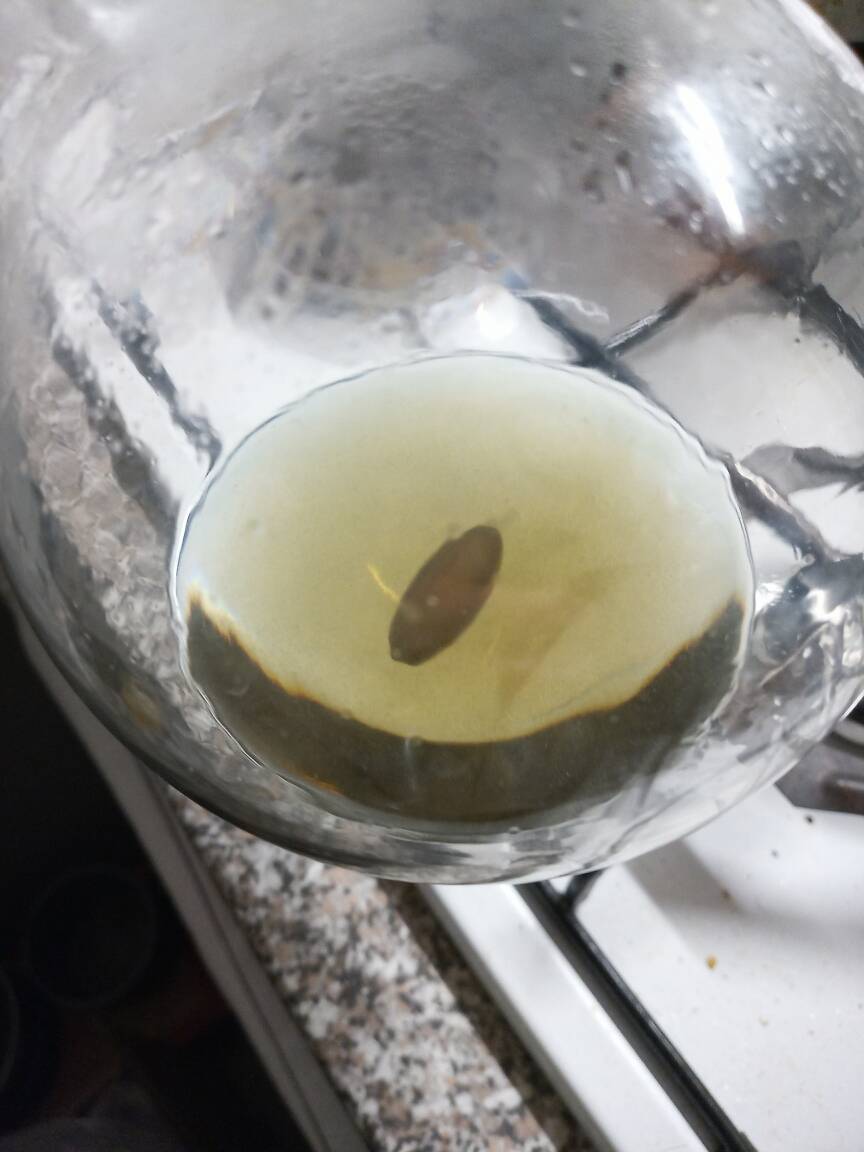

crystals of NaCl on the bottom after the reaction was finished
IMG_20250205_203115_0.jpg - 45kB

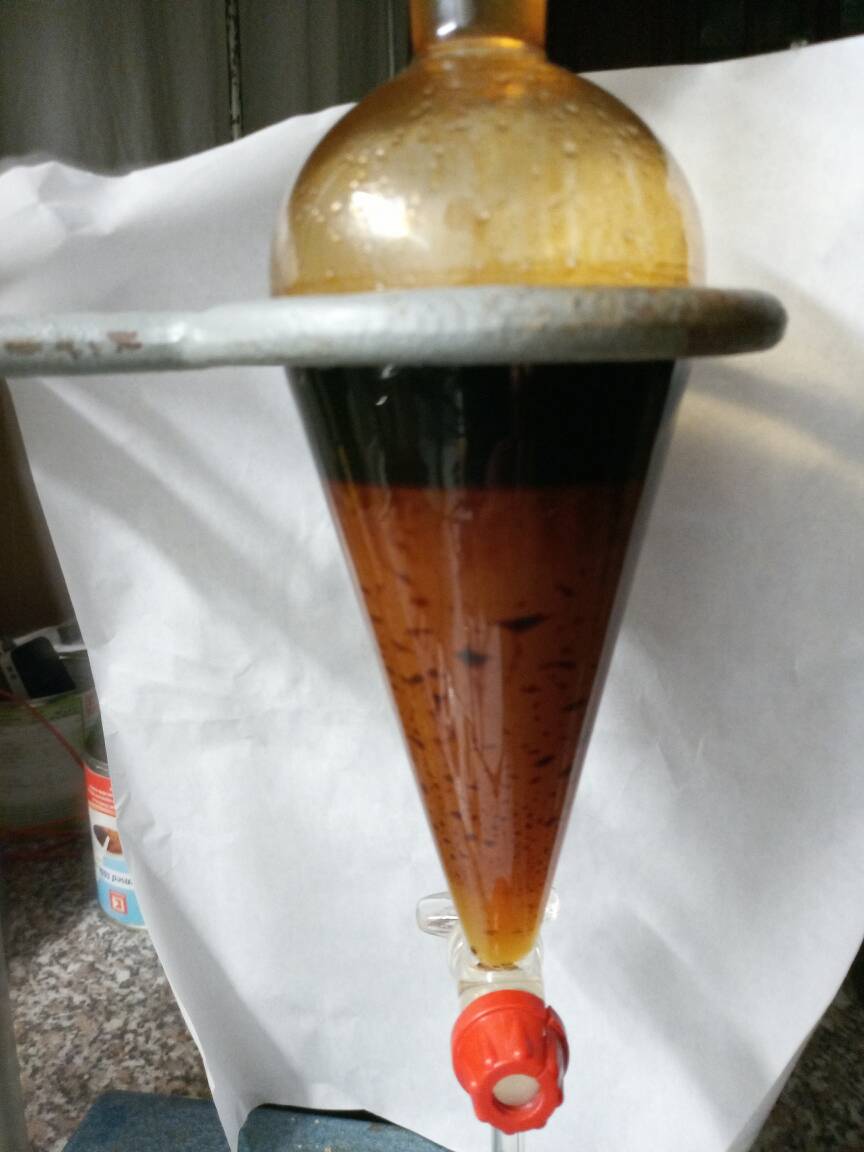

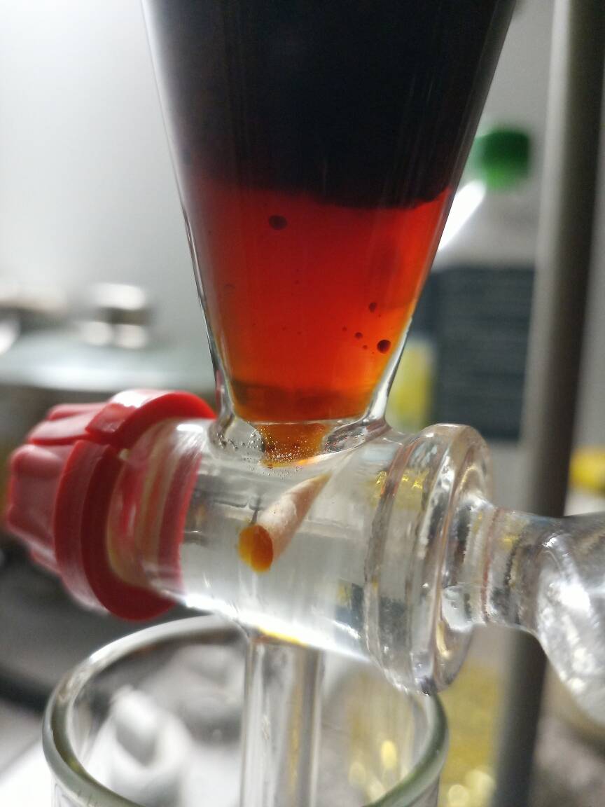

mixture in separatory funnel, border of the 2 layers invisible but will be visible later
IMG_20250205_210853_5.jpg - 75kB

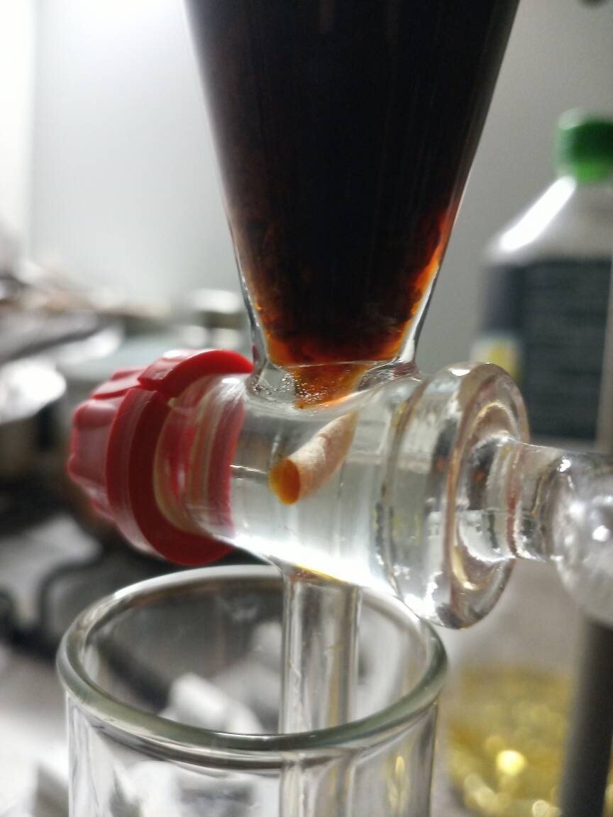

during slow draining out when the upper organic layer reaches the stopcock the border becomes visible
IMG_20250205_210903_2.jpg - 58kB IMG_20250205_211146_6.jpg - 65kB IMG_20250205_211213_3.jpg - 64kB
washing with NaOH saturated with NaCl to get rid of possible free phenol (I'm not sure whether this is necessary and whether the mixture couldn't be processed further even without this step?)
IMG_20250205_220722_3.jpg - 65kB

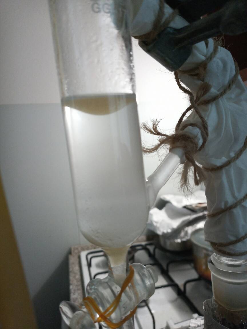

steam distillation using Clevenger apparatus
IMG_20250206_134600_8.jpg - 79kB

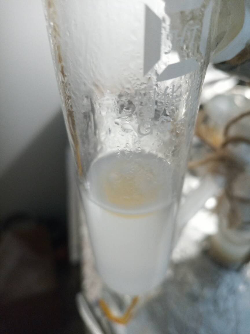

the density of the product is 1,1 but a lot of it stays floating on the surface in the Clevenger apparatus and only later when the blob becomes bigger it breaks surface tension and overcomes adhesive forces on the glass walls and sinks down, luckily the Clevenger apparatus has also some small reservoir on the bottom
IMG_20250206_141619_9.jpg - 45kB IMG_20250206_141633_6.jpg - 51kB IMG_20250206_141643_0.jpg - 46kB IMG_20250206_142041_7.jpg - 58kB IMG_20250206_142132_8.jpg - 48kB IMG_20250206_142156_0.jpg - 70kB IMG_20250206_142940_8.jpg - 63kB IMG_20250206_143654_2.jpg - 78kB IMG_20250206_144437_1.jpg - 81kB IMG_20250206_162102_7.jpg - 72kB
