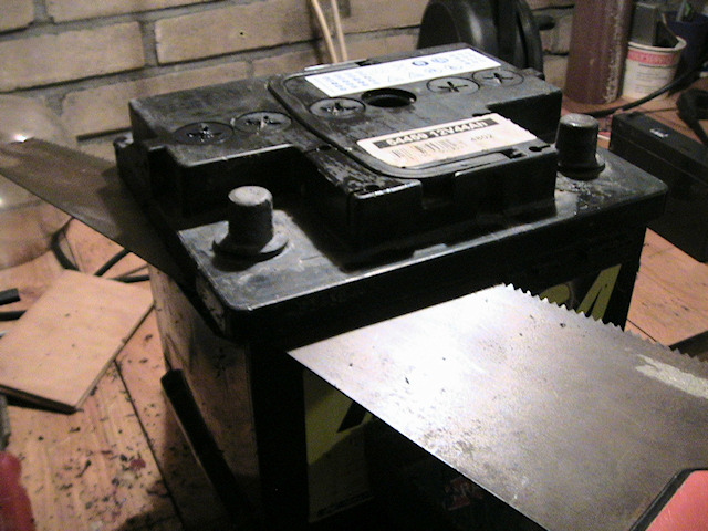

In case you are still interested, here's a picture of how i did it.
IMG_6919_small.JPG - 130kB
