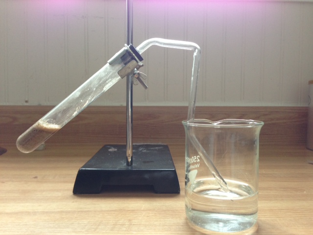

Opted to use calcium fluoride
photo 1.JPG - 104kB
Calcium fluoride and builders sand, mixed with sulfuric acid added. The mixture was slowly bubbling even without heat.

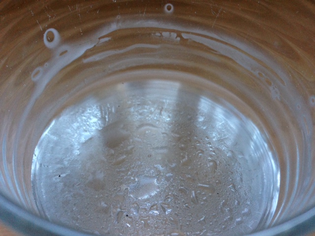

After "dumping" the fumes into a glass of water...

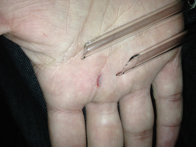

I was in the process of making an apparatus to have the gas bubble vertically up through water to try and create tubes of silicic acid. After making the perfect piece of glass tube for the job I managed to jam myself in the palm with it while trying to stick it into a stopper. After picking bits of glass out of my hand I wasn't in the mood to try the experiment again (today anyways ;) )
A nice small, but deep hand stab, huzzah! What a stupid mistake.

Ouch. Are you using rubber stoppers or do you have Quickfit joint adapters?

For this I was using rubber stoppers, too afraid to use fluorides in my Quickfit stuff, even SiF4. Next time I will just be more careful and probably bubble it from below a layer of mercury in a column so that the tube doesn't block with silicic acid. The rubber stopper was completely unaffected after the experiment. Only white deposits that you can wipe off by hand. Pisses me off because I had the perfect tube for the job :P

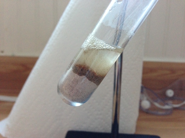

This morning I wanted to play with this strange gas again. Instead of just letting the tube exit into open air I used a piece of bent glass tube (broken from last night) and placed it so that the tube was just above the water surface.
The mix was used with a higher proportion of sand to discourage any HF from attacking the test tube instead. As soon as the gas evolution started the beaker fogged up and a gel like layer started growing quite quickly on the surface of the water like an island. Not the whole surface of the water became covered though so the SiF4 seems to be highly attracted to the water. It doesn't seem to float around in the beaker much.
Draping a very wet paper towel over the beaker completely prevented any fumes from escaping and at the end of the experiment the paper had a layer of snow like deposit on it.
Another interesting observation is if a jar of the gas is suddenly inverted over water and kept about 5mm from the surface, the surface instantly solidifies and makes a crackly sound!
My crude set up
photo1.JPG - 87kB photo 2.JPG - 77kB
Water surface as seen from below and above, after there was no more SiF4 being generated.
photo 3.JPG - 83kB photo 4.JPG - 58kB

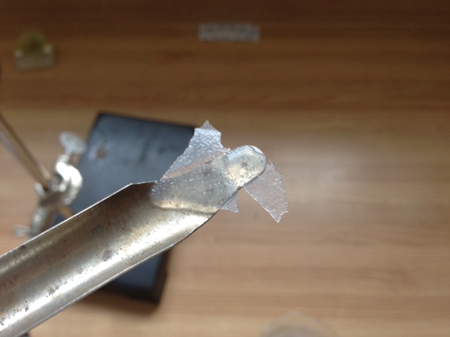

This time the layer was so thick it could easily be skimmed off. The consistency was similar to jell-o
photo 5.JPG - 71kB

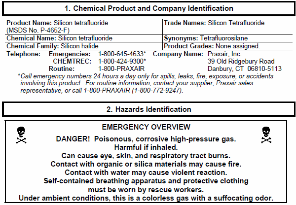

I just hope people here understand what a nasty little chemical SiF4 really is: hydrolysis generates HF. Beware!
See this SiF4 MSDS and start shivering:
http://www.orcbs.msu.edu/msds/LINDE_MSDS/pdf/061.pdf
[Edited on 27-11-2012 by blogfast25]

Unfortunately, although the gas does not affect dry glass, it does affect wet glass. The beaker I used in the previous experiment has dried after cleaning and there is a white ring where the water level was :( It would seem that due to the hydrolysis to HF, if there is a thin coating of water enough is produced in high enough concentrations in those areas to etch the glass. Do not do this with glass you like... This was a brand new beaker.

SiF4 doesn't form HF upon reaction with water.
The reaction goes:
3 SiF4 + 2 H2O ---> 2 H2SiF6 + SiO2
The white ring on your beaker must be adhering silica, because H2SiF6 does not noticeably attack glass. It's also not nearly as dangerous as HF, though it's a much stronger acid.
